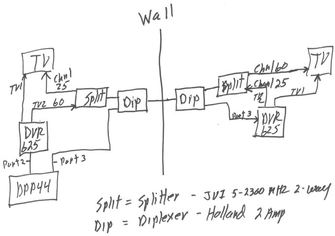

From my previous thread. http://www.satelliteguys.us/dish-network-technical-discussions/163268-stacking-dioplexers.html
After getting advice here, talk with Claude at the DishStore and more thought;
I stacked Splitters with my Diplexers and it works.:)
Well it seems that Stacking Splitters and Diplexers has worked.
DPP44
2 TVS
2 DVR625s
2 Splitters found here: The Dish Store - Powered by Metro25
2 Diplexers found here: The Dish Store - Powered by Metro25
See my poor drawing below.
DPP44-Port 1 feeds the Power Inserter and 301 upstairs and is not needed for this discussion.
Coaxes from the DPP44-Ports 2 & 3 both come into my Living Room.
I have one TV and one DVR625 in my Living Room(LR)
I have one TV and one DVR625 in my Bed Room(BR).
I wanted TV2 from LR DVR viewable on BR TV and TV2 from BR DVR viewable on LR TV.
I have one Coax through the wall from the LR to the BR.( I know. Poor planning during const.)
DPP44(Port 2) ----> to LR DVR-Inputs
DPP44(Port 3) ----> to LR Diplexer(Sat)
LR DVR-TV1(S-Video) ----> to LR TV (S-Video Video 1 Input)
LR DVR-TV2(Channel 60) ----> to LR Splitter(Out-1)
LR Splitter(Out-2)(Channel 25) ----> to LR TV (RF input)
LR Splitter(In) ----> to LR Diplexer(VHF/UHF)
LR Diplexer( In/Out) ----> to Coax through the wall to the Bedroom Diplexer(In/Out)
BR Diplexer(Sat) ----> to BR DVR-Inputs
BR Diplexer(VHF/UHF) ----> to BR Splitter(In)
BR Splitter(Out-1)(Channel 60) ----> to BR TV (RF input)
BR DVR-TV1(S-Video) ----> to BR TV (S-Video Video 1 Input)
BR DVR-TV2(Channel 25) ----> to BR Splitter(Out-2)
As a plus, I now have TV2 from both DVRs(Channel 60 and 25) viewable on both TVs.

Nice to see you proved it out. I wasn't sure the splitters would let it work, but you now have the capability of a coax line with with all the RF channels on it. thanks for following up.
