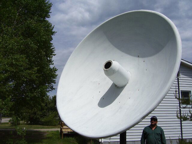

We took this one down today, it's still sitting on the trailer.
It's an 8' spun aluminum, 19" deep and about 3/32" thick.
Only the glue is left, where a name plate once was on the back.
The owners knew nothing about it, other than it was there when they
bought the place 10 yrs. ago, and no spare parts laying around anywhere.
It has a few dings and dents, but none too serious. I'll try to smooth them out.
Would this be a Cassegrain type dish with the secondary reflector missing? The
center looks like the scalar and LNB would have faced the sat.
How much C/Ku fun will I have with this one?
Thanks for looking.

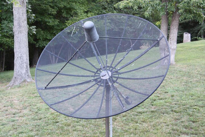

Some noticeable edge and surface dings show in the pictures
Still, I'd think it would do fine on C-band.
Of course, all things are relative... if you've got a good 12'er, this might not do as well! - :D
Unless you want to try to restore the original feed, I'd calculate the focal distance, and outfit it with four legs to hold a scalar.
The legs could be made from conduit, or maybe anodized aluminum tubing, according to your budget.
Changing a button-hook feed (single pole up the middle of the dish) to four legs is a common mod.
Someone did a fine job of it just recently... and if I can recall who it was, I'll post. - :up

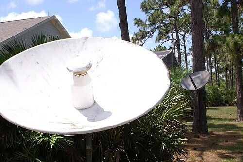

OH,OH, found this: C-band dish sold as "The Eliminator" out of Apopka, FL.
Code:
http://www.flickr.com/photos/ajmexico/3121410158/in/set-72157613646383797/
new info:
Cassegrain-feed 8 foot C-band dish sold as "The Eliminator" out of Apopka, FL. ...
The big dish is a spherical (not parabolic) shape.
Inside the cap is a weird-shaped secondary reflector that sends the signal into the feedhorn which faces the sky, not the dish.
Doesn't look like your dish has the sub-reflector.
Not sure my suggestion about adding quad scalar-support legs is a good idea, if the dish is spherical instead of parabolic.

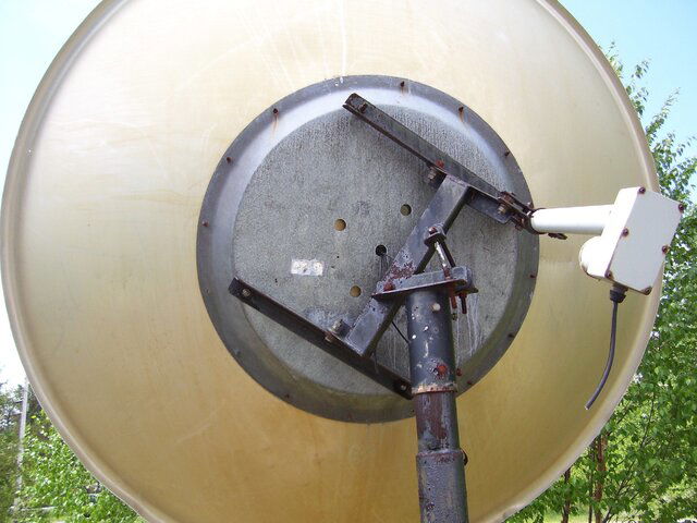

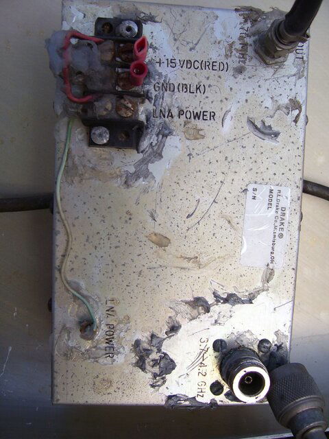

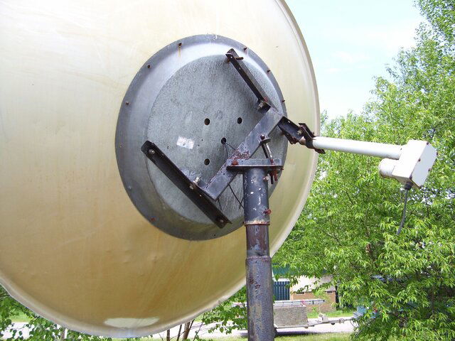

No LNBs, but I did find this box (1st pic) when I lifted the dish off the trailer. it must've been sitting in the feed base
for years before it fell out. No big deal though, modern stuff is far better anyways.

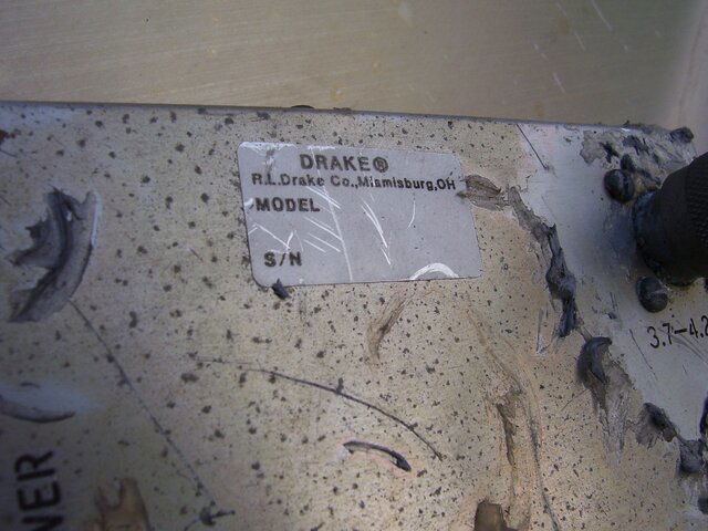

2nd pic shows who made the thing. Google says they make electronics, not dishes.
FaT Air,
Awesome find on the picture! (3rd) It's gotta be the same make and model! Too bad we can't get
more details from it!. Damn!, I wonder who made these things??

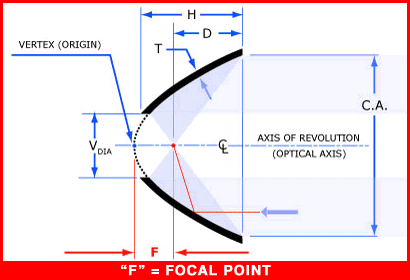

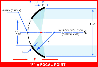

Spherical or Parabolic?
Time to brush up on my maths and physics, and put Google to work.
It seems my first task is to determine the geometry of this dish.
I believe this can be done by establishing the focal point and/or center of curvature, then taking
measurements from that point to various circumferences around the pan.
So, if it is an 8' spherical dish (1st pic), the center of curvature will be 4' from the vertex, along the principal
axis, and at all points along the reflecting surface . A simple enough task, I hope.
A parabolic dish (2nd pic) on the other hand, will have incremental distances to the focal point, along the
curve of the reflecting surface. The distance increasing, the further you get from the vertex.
Telling the two apart, I learned that on Sesame Street!;)

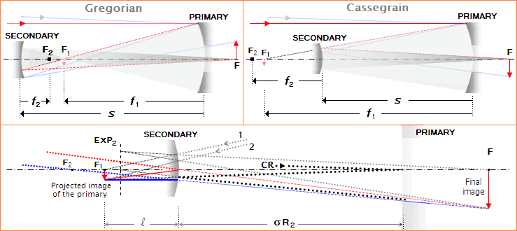

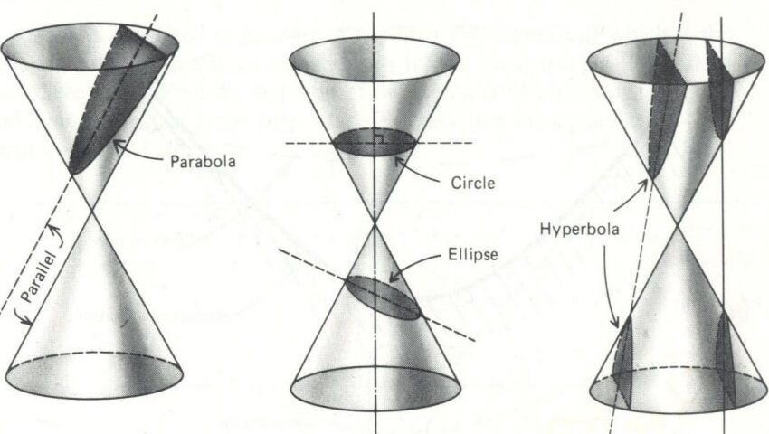

Two types of secondary reflectors can be used. Convex or concave. (3rd pic, top half)
Using a convex secondary, is the "Cassegrain" style, whereas the concave application is the "Gregorian".
"Gregorian" is used mainly for optics, I think it's the interference produced (F2) between the secondary and
the focus, that makes it unsuitable for microwave use. If anything, it'll be Cassegrain.

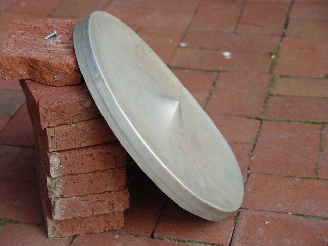

Formulas that I used called for my sub (virtual) reflector to be 6" O.D. with a .4375" rise in the center. I didn't even try to plot the profile as a hyperbola, I just fabricated it from a piece of .015" aluminum sheetmetal laid out (developed) using an exercise in an old drafting textbook.
My homebrew satellite receiver kit came with documentation on various microwave feedhorns. The LNA, with a homebrew pyramidal feedhorn, was rotated with a Channelmaster T.V. antenna rotator for H/V selection. The dish I experimented with was an old Bell Telephone terrestrial microwave dish. I adapted it to a Cassagrain feed to keep from having to mount the LNA/rotator out in front for a prime focus arrangement. Later traded the dish for a 10' fiberglass.
This exercise took place in 1981 and I amassed several notebooks of diagrams and information on antenna design. Those notebooks were lost during a household move and I haven't been the same since.

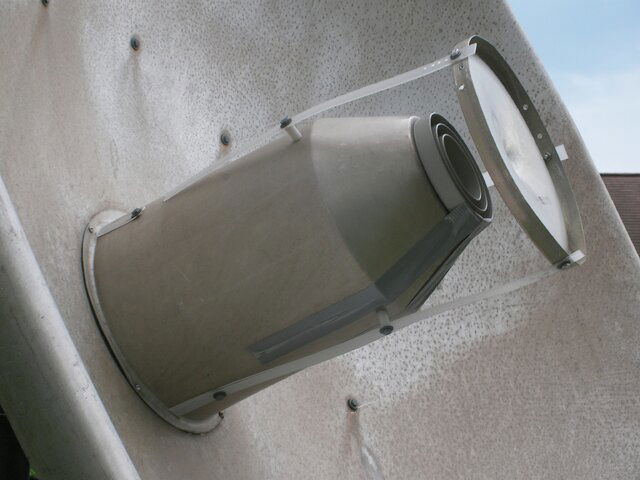

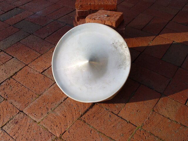

Here's a couple of good ones of the secondary reflector.
So THAT's what it looks like!
Hello Iammike, great to hear from you! The pics say a thousand words!
Now I know what the secondary looks like.

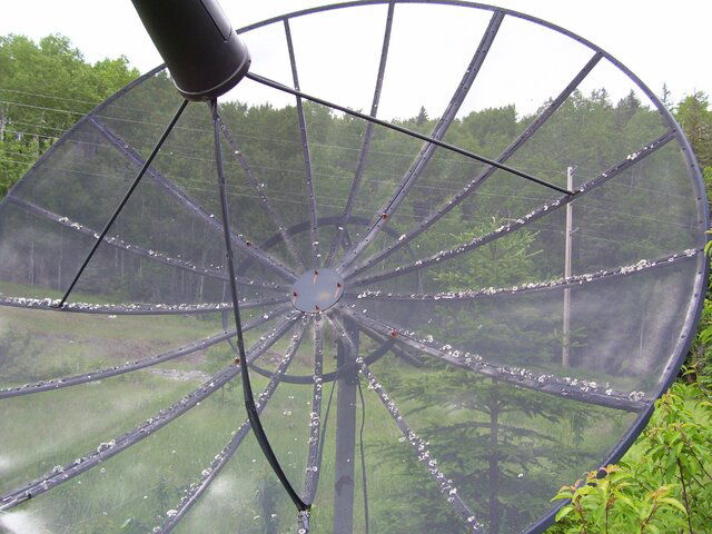

Oh-well, it looks as though this project is going to be on the back burner for a bit, as I was just given permission to pluck a 10' mesh, (pic)
from out near one of the power-dams in the area. A bit if moss and lichens growing on it, but still in very usable condition!
Oh, by the way, the jack that came with the 8' solid dish still works!
