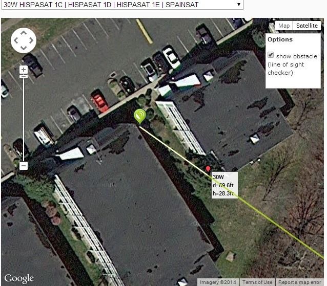

Sounds like a plan to me. I did the same a few yrs ago. (But not the mirrors) Just wanted confirmation that that pine tree a block away wouldn't interfere with placing the dish 'in the farm'. 30W turned out to be about 3 ft above it.

Most important is to find out, if the tree you mentioned would not be between the Hispasat and dish. I understand that NPRM is a device for fastening dish to the roof and it is not accepted by the landlord. It's OK, since it will be easier to get access to the dish from balcony.

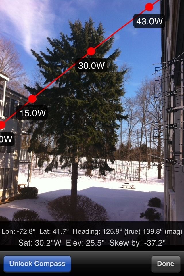

Well, if today's sun is any indication, I'd need to punch a hole through the pine tree to get any signal. The sunny spots are THROUGH the upper branches, and there aren't any branches low enough for me to climb up and do some selective pruning.

Even if I talked to the neighbor above me and put it on their balcony, it might not see above the tree. My only options seem to be to get a few gallons of super-heavy-duty plant killer or move, which won't be until after the wedding. And yes, she somehow puts up with my antenna/radio/sat silliness.
Clearly that tree has to go..... Copper nails I've heard do the trick on the QT.... You will hafta sneak out and drive them in in the middle of the night. Just like staking a vampire.
"Bribe" your upper-floor neighbour with offer of receiving satellite programs (use LNBF with double input), so he accepts the dish on his balcony. But, first, check if the Sun, observed from his balcony, at right time is not obstructed by the tree.

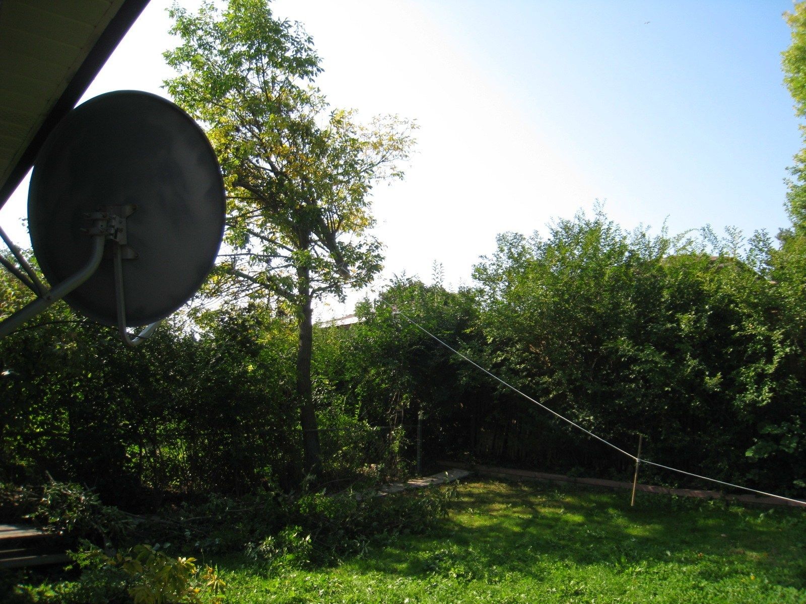

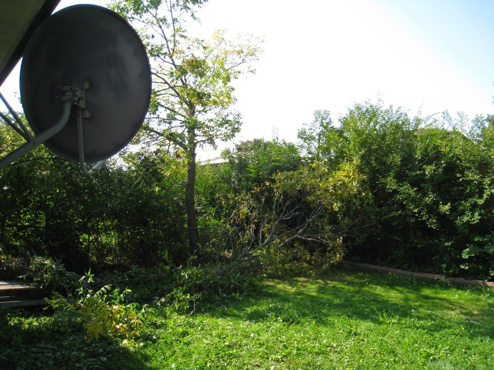

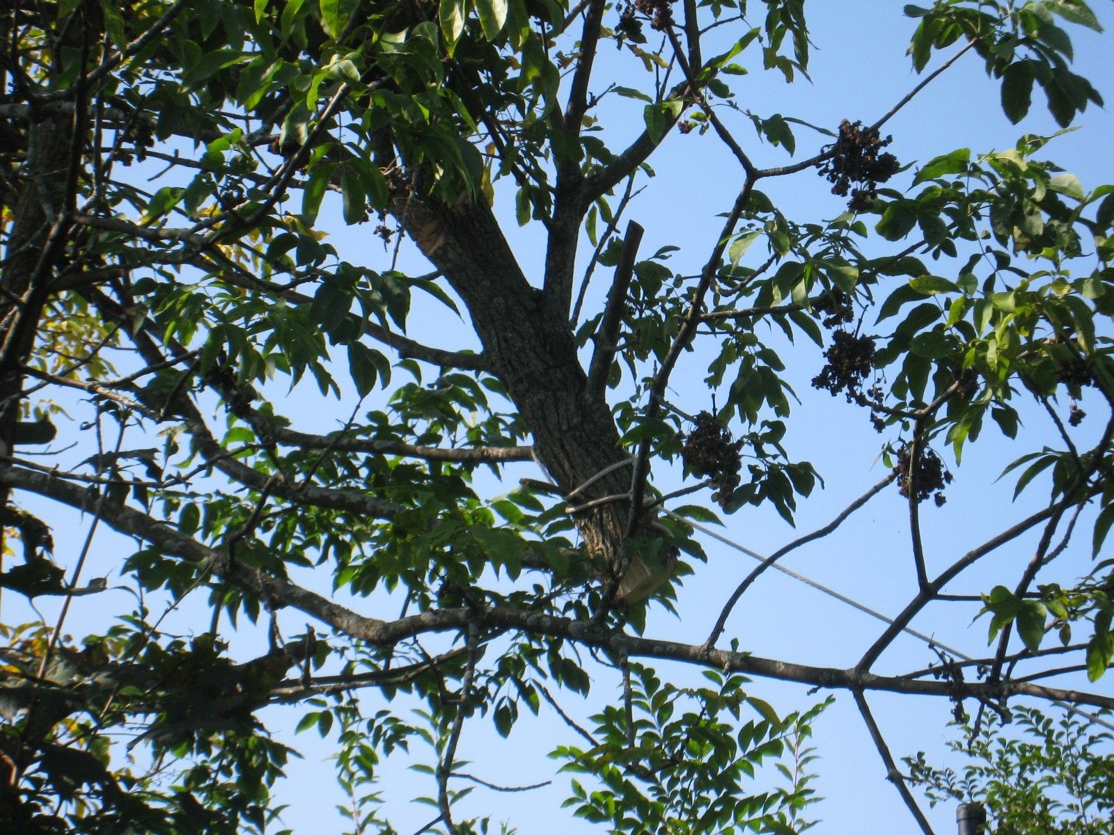

Another option, still visible, but not too radical as felling all tree, might be topping it. It is not recommended for the tree health, but here is more concern with avoiding too visible intervention. Perhaps you could use small chainsaw on a looong pole, with someone controlling extension cord?
I topped a tree in my neighbour backyard, with his acceptance, of course. This tree was infected, anyway, so it had to go. Made room for my other dishes.
There was problem with pulling down the top, which got stuck on other branches, but a rope helped with it.
