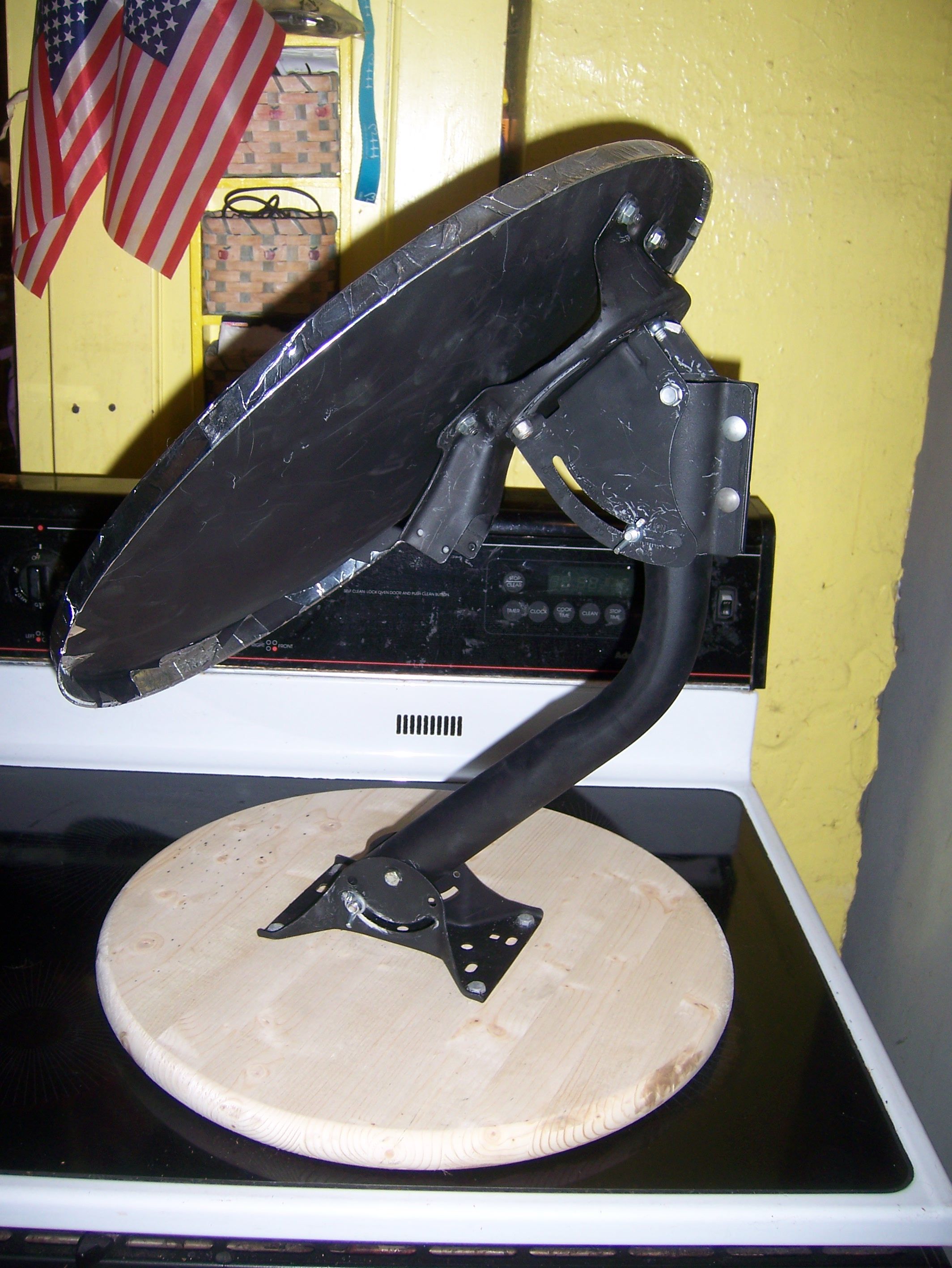

Not entirely FTA, but has anyone made a solar cooker from a satellite dish before? My daughter is making one for a school science project and I was wondering if anyone has done it before and what the results were if they did. I gave her one of my small 18'' X 22'' Direct TV dishes to use for it and it's looking good, so far.
She took off the LNB arm and turned the mount around on the dish so the piece where the arm mounted to doesn't stick out beyond the edge of the dish anymore and the dish sits lower. Tonight she painted all the pieces flat black and tomorrow she's going to cover the dish part itself with reflective foil tape and then put it all back together. She has an old camera tripod to hold a small cooking pot and the dish mount has skew adjustments, so along with the adjustments on the pole itself and the elevation adjustments, it can move just about any direction needed. tomorrow I'm taking her to Lowes to get some wing nuts so a wrench isn't needed to adjust it.

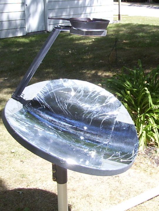

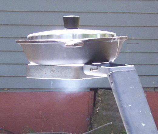

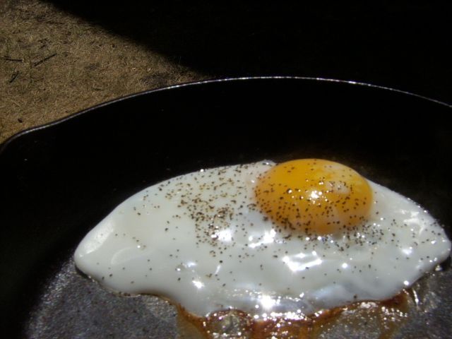

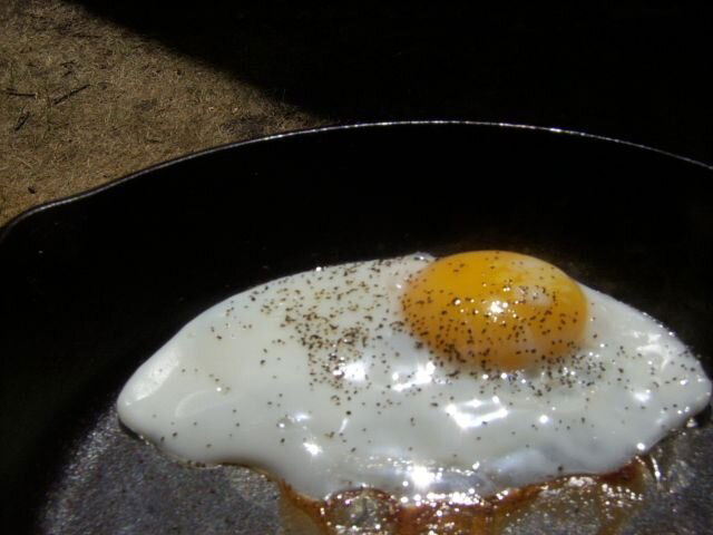

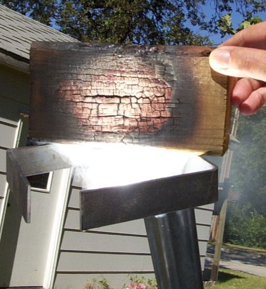

I fried an egg with the 83e
"Reflectorized" with mylar and spray adhesive.
Dish inverted on the mount with longer bolts to affect the angle higher.
Second pic show the 'coma' of the focus. Could have gotten the pan even hotter is it were placed closer to it. The burnt 2x4 only took a second. It actually 'screamed'.
View attachment 105690 View attachment 105691 View attachment 105692View attachment 105693

40x30 The egg was cooked around 1:00 PM IIRR. that's because that's when my 'pan holder' was closest to level. I also painted the bottom of the cast iron fry pan with flat black high temp paint. IIRR i measured the egg side of the fry pan being somewhere near 500° F. ( I have a pic somewhere) Ambient was around 72°F

My last pic (posted) is a 2x4 that was placed upon the pan holder. Burst into flames immediately and the noise (scream) was very pronounced.
Don't get anything you don't want burnt anywhere near the focal point.

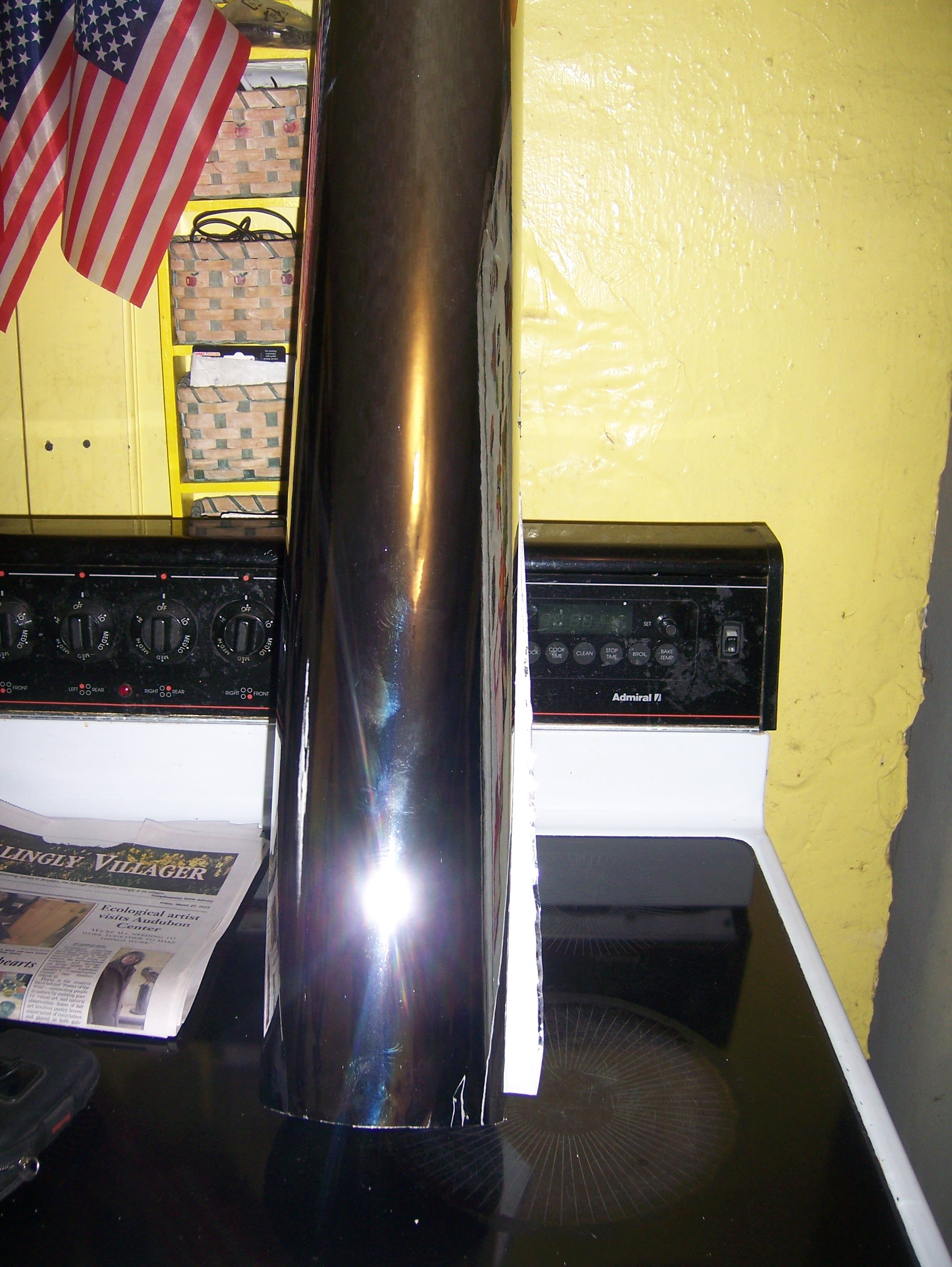

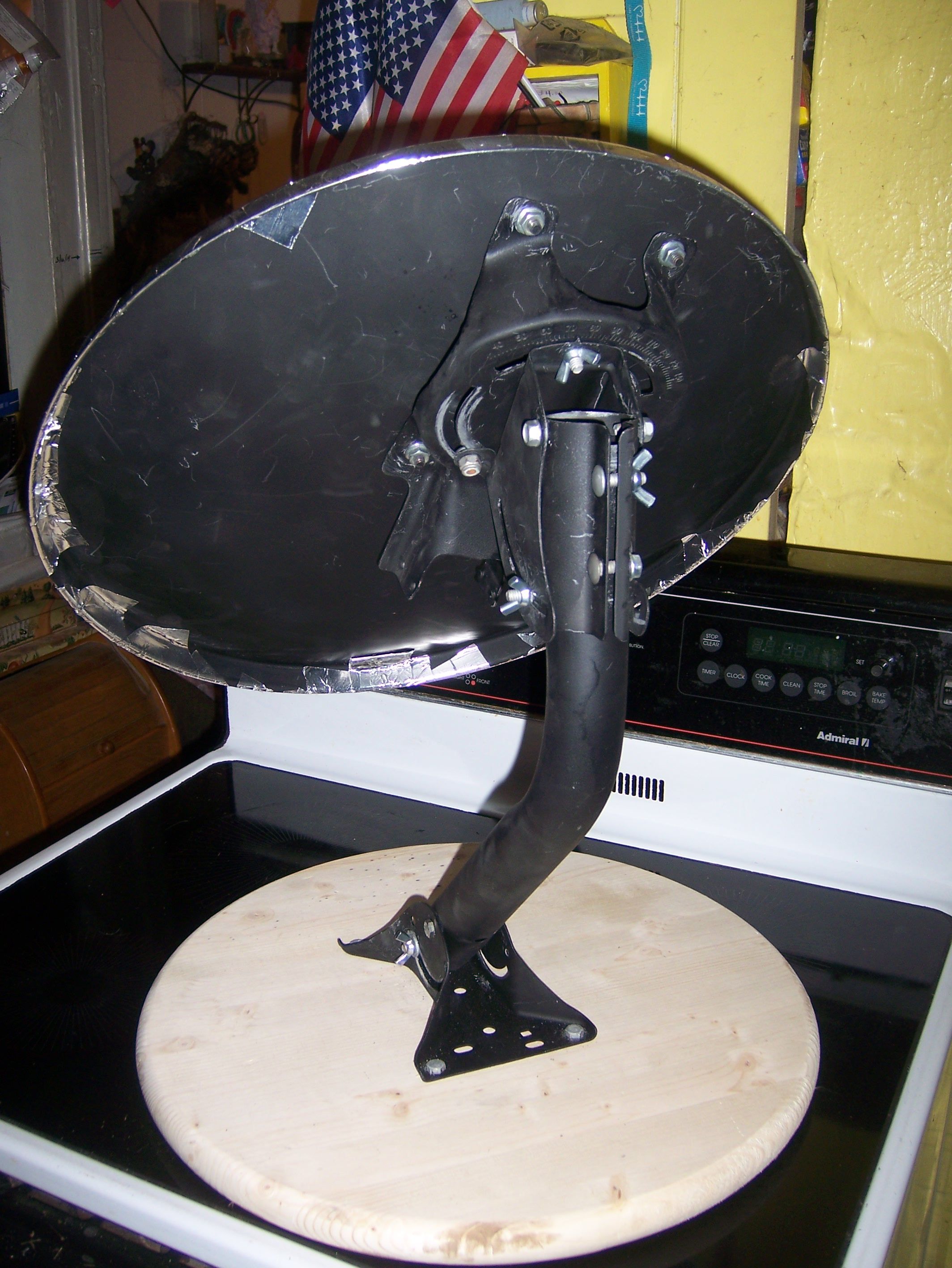

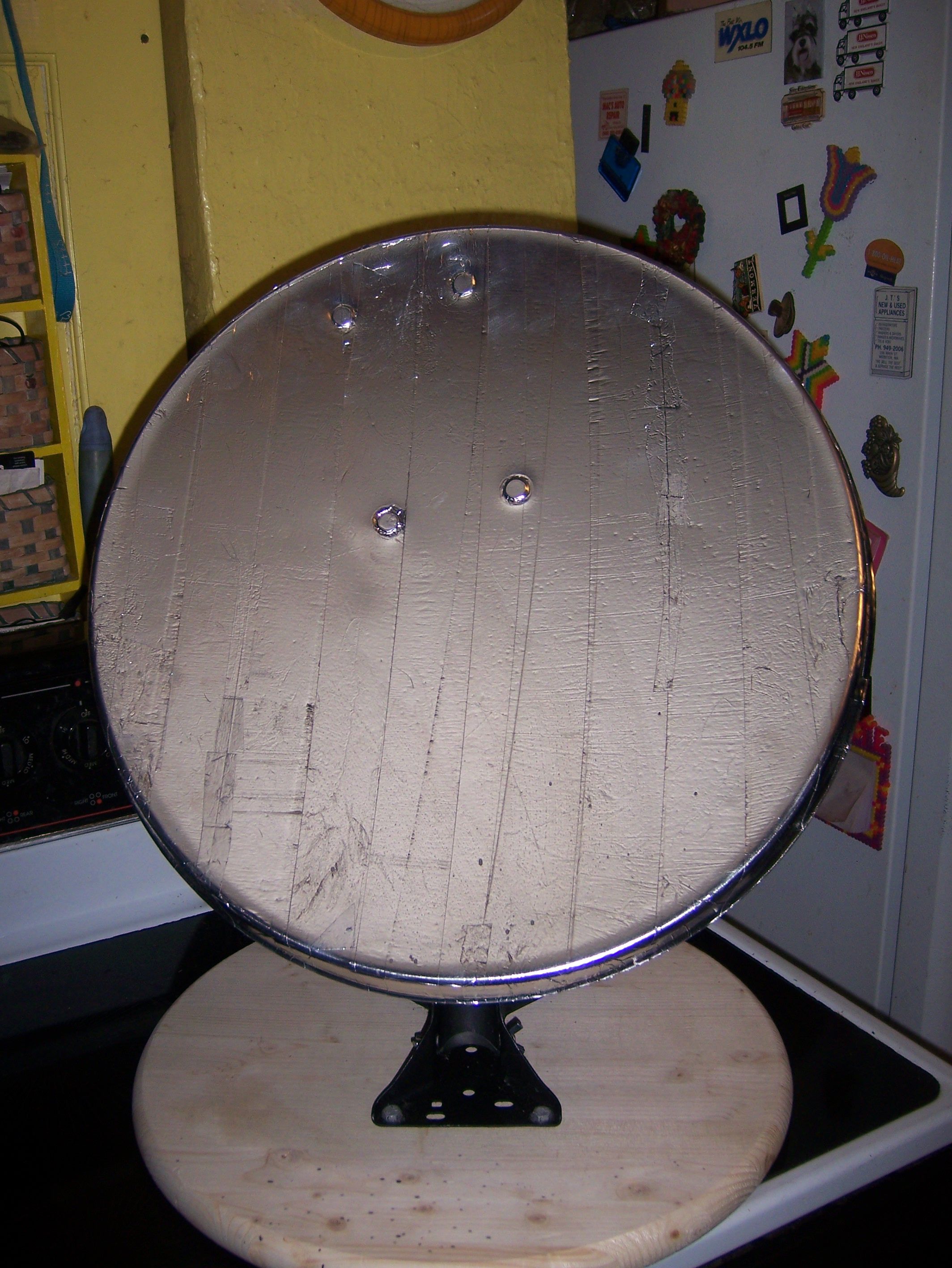

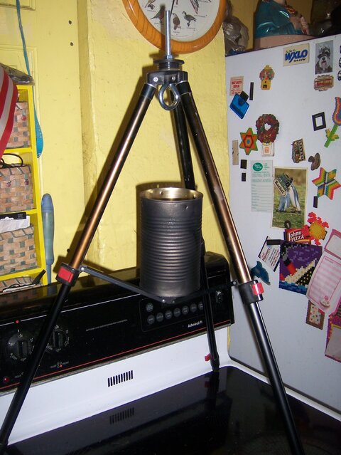

Found my camera, but the batteries were gone out of it!%!#! I used my wife's camera for these pictures, so I hope they aren't real big posted up here or anything like that, I never use her camera. The tripod can extend about 4' more than what it is in the picture. My daughter's gonna try to find some material that's more reflective than the tape and see if it works better.
How about using the shiny side of aluminum foil? Would probably be a bit tough to get laid down without any wrinkles, but I don't know just how important that would be, as the sun is a pretty big power house (at least here on earth, universe wise, not so).
Keep us updated.
She actually wrapped aluminum foil on it last night and that looks like it might work, we just have no sun to try it right now, it's pouring out today. Looking like Sunday is when the rain is going to clear up and we can try it again. A co-worker is going to bring in some Mylar sheets for me tomorrow that he says is real shiny, so we have a couple of things to try!
