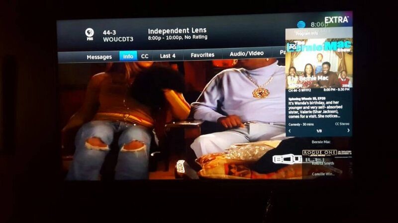

8. The TV's internal guide knows most of the channels on Directv. Pressing the "extra" button on the TV puts either a) programming info; b) a live Twitter feed for channels that do that (like ESPN during a live Sportscenter); c) weather info if the TV doesn't "know" the channel; or d) a combination thereof. It even knows my local Bounce TV WFFF-3, which the AM21 doesn't. My other missing channel is Grit, but it doesn't show up on the extra guide. (Pic in next post)

Bounce TV... Smart TV knows. Dumb AM21 doesn't.

Whats on the top right side ?
That kind of stuff would annoy me.
I want to see my program.
That is the "internal" guide from the TV. It's not there all the time, I just took a pic of it because it is showing actual Bounce guide data, despite the AM21 not. I think what you're seeing is where the two guides overlap because I had them on at the same time. Occasionally, a small "extra" icon will appear in the upper right of the screen if something new is there. It doesn't stay on long as long as and is less intrusive than the "scoreguide" pop up.
Gotcha.
