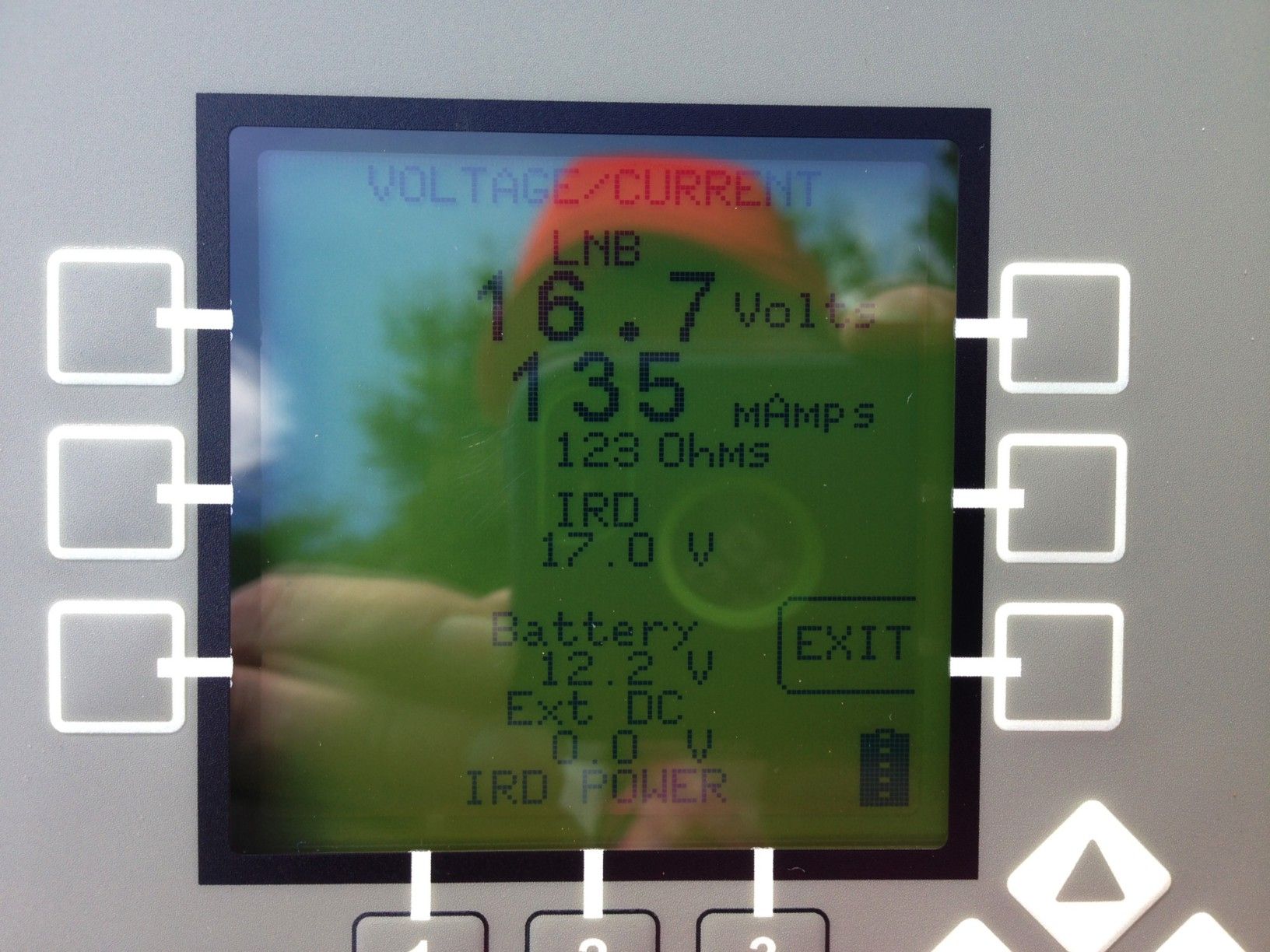

I pulled the Primestar LNBF off my dish and I noticed the connectors were a bit warm. Quite a bit warm, enough so that I let go of it real fast and used a wrench to take it off the rest of the way.
IMG_1808.jpg IMG_1811.jpg IMG_1812.jpg IMG_1813.jpg IMG_1814.jpg IMG_1815.jpg
Maybe that LNBF was the fault. I don't know for sure but it sure looks suspicious.
So I put my SL2PLL back in place and thanks to my excellent new meter I was able to tweak my dish and LNBF to what I think is pretty much OK.
After, I put my meter in-between the LNBF and the A3 and got a new voltage/power reading.
The results are very different now. :D

123 Ohms? That is odd.
Now that current reading is what I would expect to see! The resistance reading is a bit high. What did you have inline when the meter photo was taken?

I got new readings from inside the house with the meter placed inline right at the A3, using an 8' jumper wire.
The earlier readings where taken outside, at the dish with the meter between the LNBF and the motor.
These readings are as follows:
1: 13v with Ecoda inline.
2: 18v with Ecoda inline
3: 13v with 22k side of Ecoda disconnected
4: 18v with 22k side of Ecoda disconnected
5: 13v with Ecoda replaced with inline splice
6: 18v with Ecoda replaced with inline splice
Just a thought..... the insulation may have been trapping heat inside the LNB housing that is meant to radiate from the metal housing. :redface
The resistance readings taken at the receiver look more in line with what I would expect to see from LNBF and other inline devices. You have eliminated the device that was drawing excessive current and solved for the strange resistance values!
