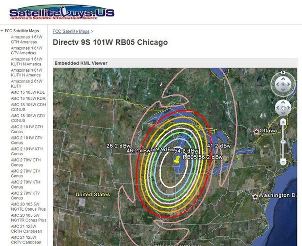

Working on my Firefox; here is your capture
did you check the link I posted in #3?
I dont have google earth on my computer so I cant see the maps themselves
I went to my other pc with google earth and it kept crashing FF. This pc told me it can't install, can't find location in msvcrt DLL. more buggy software :(. Maybe someone that can see the map can do a screen capture and post it here.
Thanks can someone get a conus map for Chicago so I can compare and do some calculating.
