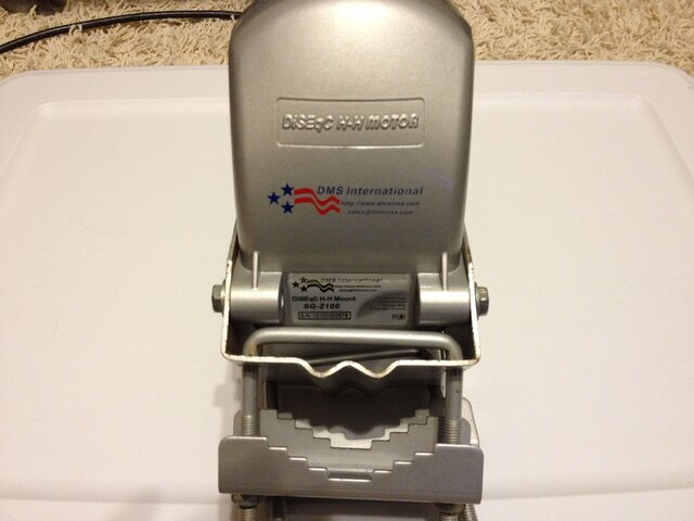

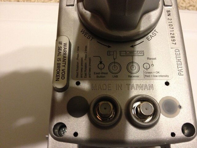

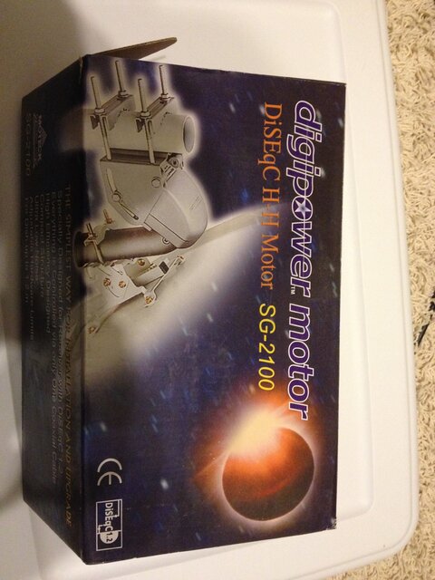

If you want an SG-2100 I would only buy the MOTECK digipower one. To the best of my knowledge the DMSI model was made in china and the other unit was made in taiwan.
I'm not picking on Tim I'm just telling what I feel is the truth.
Good One
Unit I would Pass On

Are you sure you don't maybe have the coax swapped on the motor to the wrong sides? One side is from the receiver, and the other side goes to the lnb.
Haha yea...I only laugh because after messing with it for a half hour or so, that thought finally occurred to me. It's definitely good!
