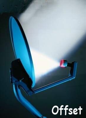

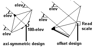

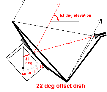

Have a look at the below maybe that will help. The mast pole must be straight up and down.
Off-set dish look around 22º lower than where they are actually pointing!
