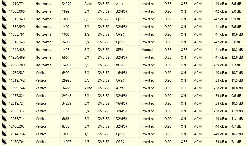

Galaxy 13 H1, not sure if there are any Ku channels on that one. Just doing a scan now..
NASA channels on that bird but on C-band not Ku.
edit: Lots of transponders, all ACM so not likely any FTA on that bird
