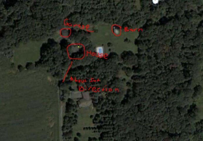

Attached if a Google Earth pic of the house and surrounding area. The yellow dot is current 1 sat dish, the red line is about the direction it is pointing. Also there are some heavy shadows from the trees on my driveway so keep that in mind as the garage has a "parking lot" infront of it.
That's pretty good.
In viewing that pick it's hard to say what the elevation is but certainly the barn should be no problem.
Garage may have issues if those trees are pretty tall but the back corner might be good. I'm thinking you'd have less issues with 110 and 119 there.
What about that clearing to the left of the garage? Do you own that?
A pole just into the clearing past the trees should give you a clear shot of all the sat and looks to be closer then the barn.
Or a pole in the backyard north of the pool a bit. All you need to do is clear the trees with some room for growth assuming the trees aren't capped out yet.

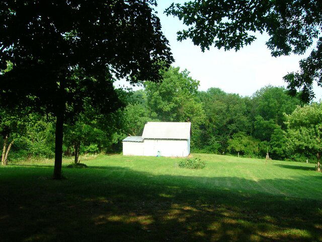

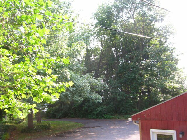

Ok, I would rather not do this on the barn as our soil is rock and clay, so I would actually need a trencher and not me and my friends, shovels and a 6-pack (more like a keg but still). The garage is the same deal but less hassle.

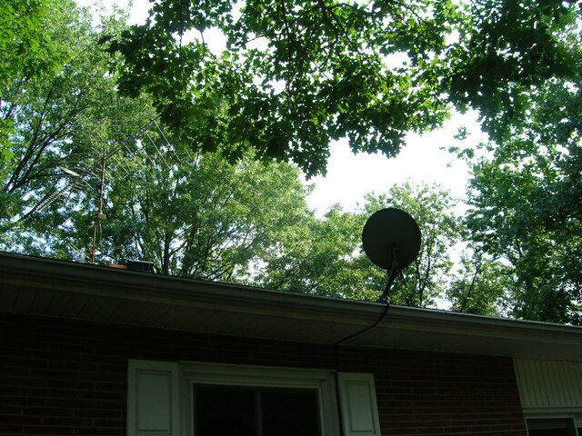

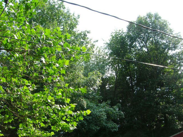

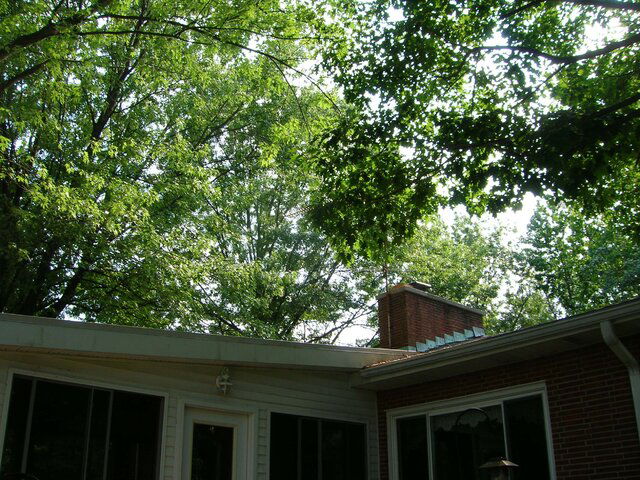

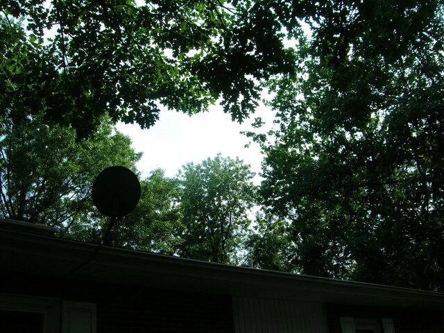

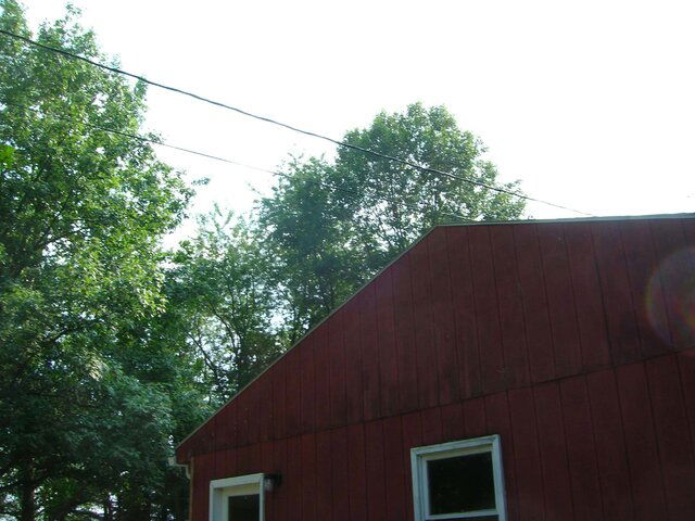

Below/attached are some pics of current sat, a place I just found near our porch, a long shot of the barn... and a pic or two of the garage. Pretty much everything shown, we own or have access to. South is being photo graphed in the sat and porch pics, its to the left on the garage and the right on the barn.
You guys really have been helpful, thanks. Instead of calling D* again, can I buy that little device for calcutating angles that they use and then once they come out pretty much not argue with a install it here?
