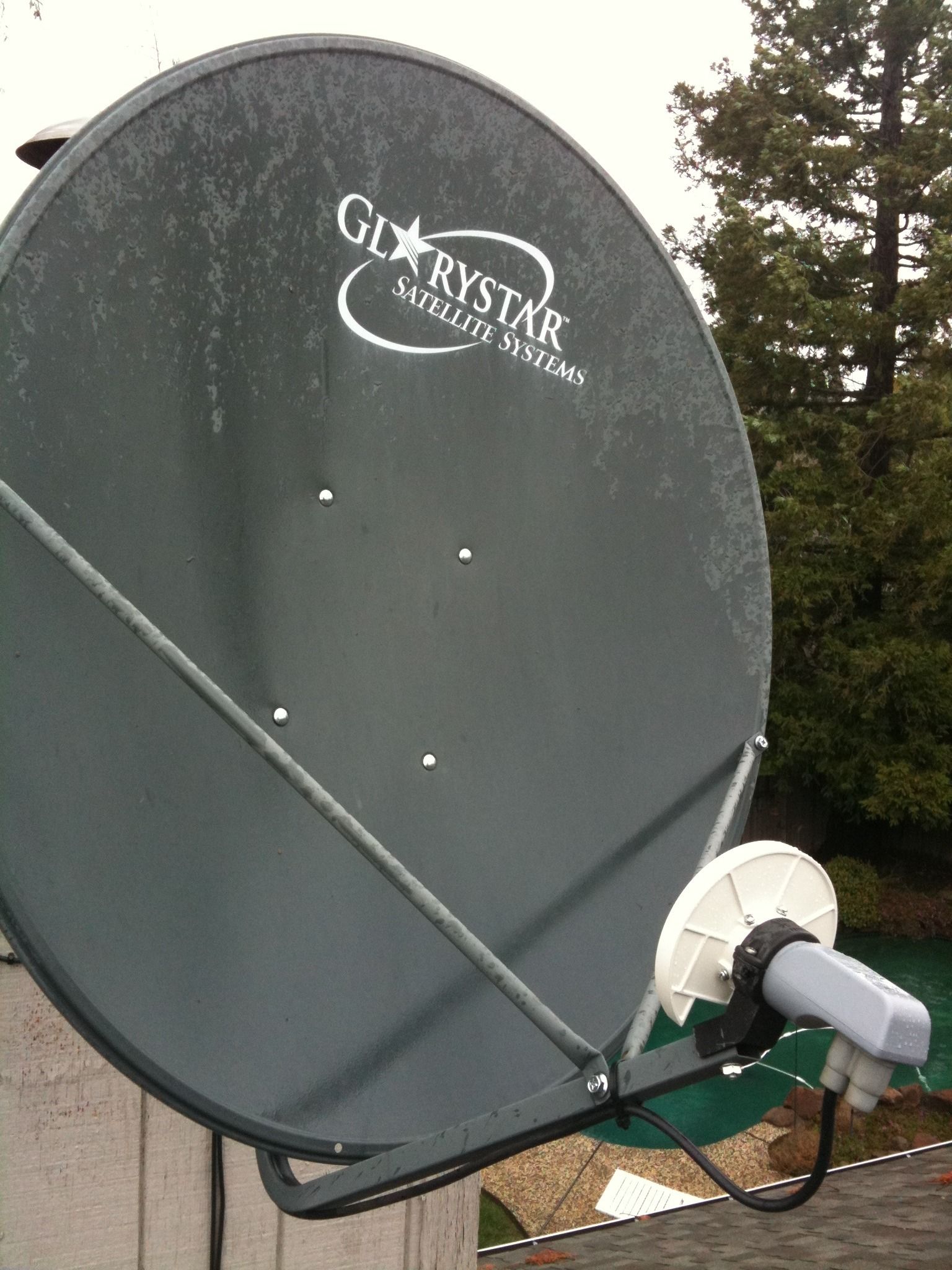

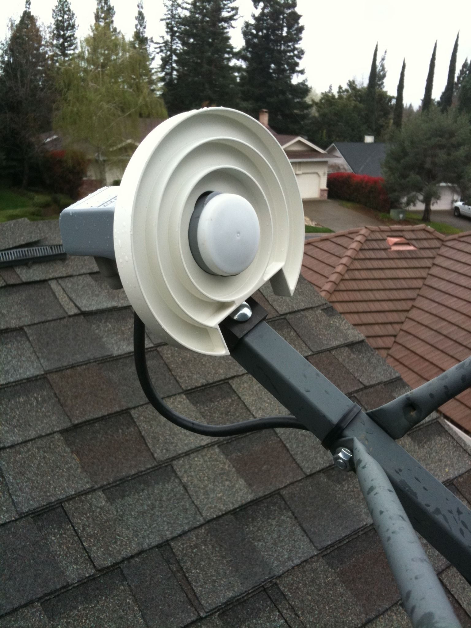

Maybe of interest...... I have a project with a scalar prototype for the GEOSATpro SL2 and I can squeeze out an additional 8% on problematic transponders on a 90cm.
