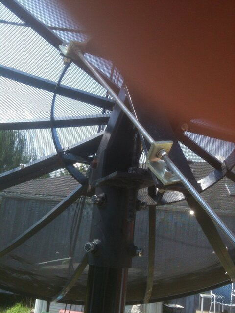

I just got a SAMI 10' dish and I am hoping to aim it at 139w for some audio reception. The elevation for my area is 12 degrees, but the adjusting bolt is too short to allow it to elevate less than around 20 to 30 degrees. Does that sound right for a SAMI dish? The bolt is an integral part of the mount with an eye welded onto the end of it where it attaches to the ring. I think I can extend the bolt by putting a nut 1/2 way on it and using another bolt. A rod coupler would be better but I don't know if I have one that big.
Another question is, if this dish is going to be fixed at 139 degrees, does this mean that the dish itself should be elevated 12 degrees or the mouting ring? I was going to leave the declination setting where it was from the previous owner but he had a dish mover on it, so I'm not sure if the dish or the mounting ring itself should be at 12 degrees? I'm thinking that the declination is only needed when a mover is used. If that's the case I might be able to get enough adjustment out of the declination setting to set the dish at 12 degrees.
I got the dish mover with the dish and it looks pretty good but I haven't tested it yet. I have to use it to secure the dish and I will probably wire it some day, but I'll figure that out when I decide to run enough wires for the motor. I got spoiled by starting with USALS and a small Ku dish. The big dish is a long way from the house so ribbon cable would be the most expensive component of the whole system for me.
If your dish is going to be fixed the only angle that matters is the face of the dish and of course the azimuth.
You are correct, declination is only a factor when you are moving the dish and attempting to track the arc.
You don't even need a plumb pole for a fixed dish.
OK. Thanks a lot. It's really hot today and I'm working slow but I might be able to try some aiming later today. I have to try to fix one little area of damage to the mesh then mount the 4 sections to the ring and attach the 4 arms for the scalar ring, etc.
38N 75W?
Atlantis? and it's HOT? and they have internet? ;)
This is a sub $10 from home depot. The dish is a 10 foot sami.
