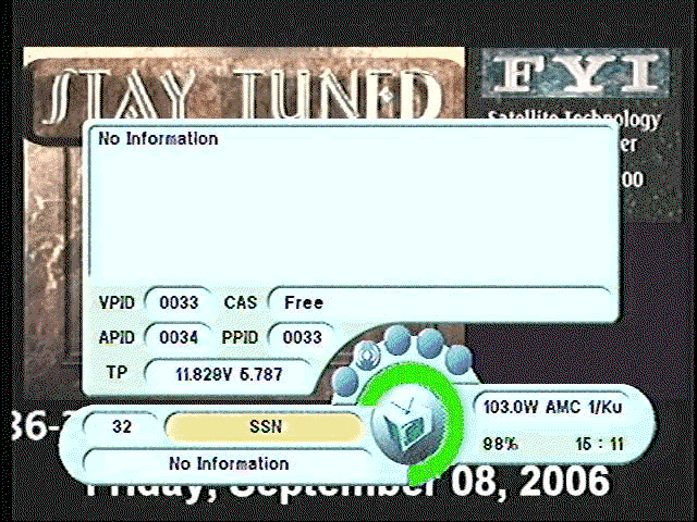

Are you sure? My polarity settings for AMC-1 are the same as most other birds. On my Chaparral Monterey C/Ku receiver the optimum settings for horizontal is at 105 and vertical is at 185 and I can rotate it between 90 and 220... these numbers are really meaningless, they don't represent degrees, they just tell how many pulses to send to the polarotor servo motor to change polarity. If I try to fine turn skew on AMC-1 from the normal H/V settings the signal level drops off.

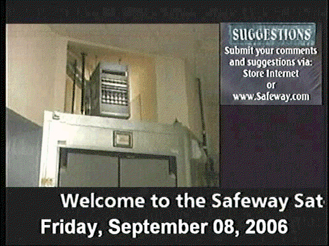

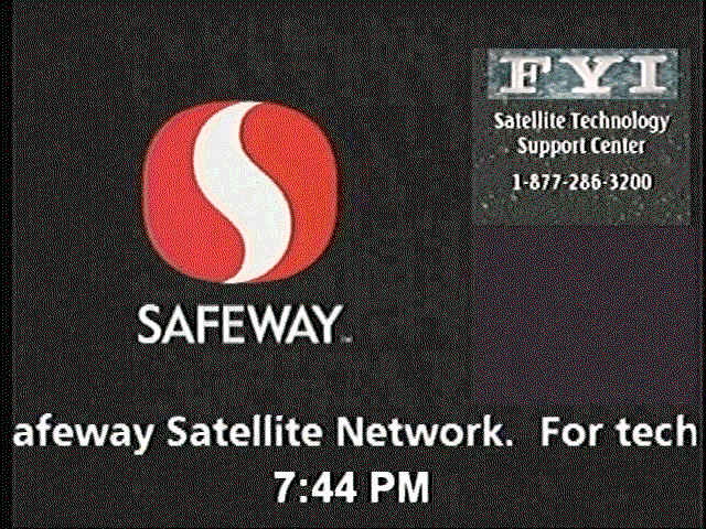

Attached are a few screen captures from the Safeway channel I did a few minutes ago along with the channel setup screen. Their 'programming' - and I use the word loosely :) repeats every few minutes... while composing this message I think I heard the 'turn the lights off' propaganda about 10 times!
