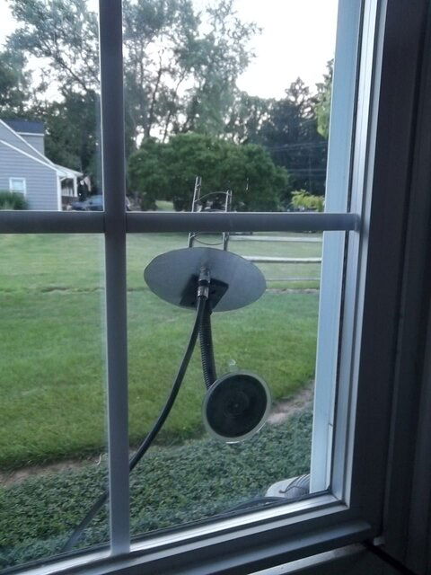

Here's the homebrew S band antenna (from UHF-satcom site plans) mounted on a window with suction cup gooseneck.

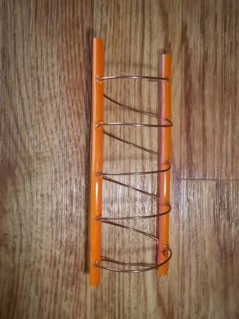

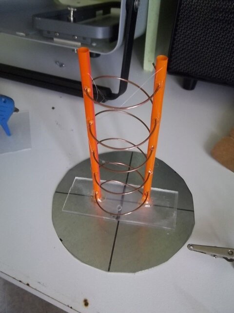

I like your antenna build. Questions: What are those coil support tubes made out of, and how did you attach them to the ground plane?

The coil supports are thick plastic drinking straws and they are attached to the ground plane with JB Weld epoxy. I first epoxied them to a piece of scrap Plexiglas, then attached the Plexiglas with the epoxy. The straws have holes drilled in them at specific distances to maintain a spacing between the coil windings. Hot glue was dabbed where the coil wire goes through the straws to stiffen it up.
The antenna was made for casual use, not for permanent mounting outside. It was coated with spray paint to spruce it up.
F connector was attached to ground plane with center pin soldered to coil end.
