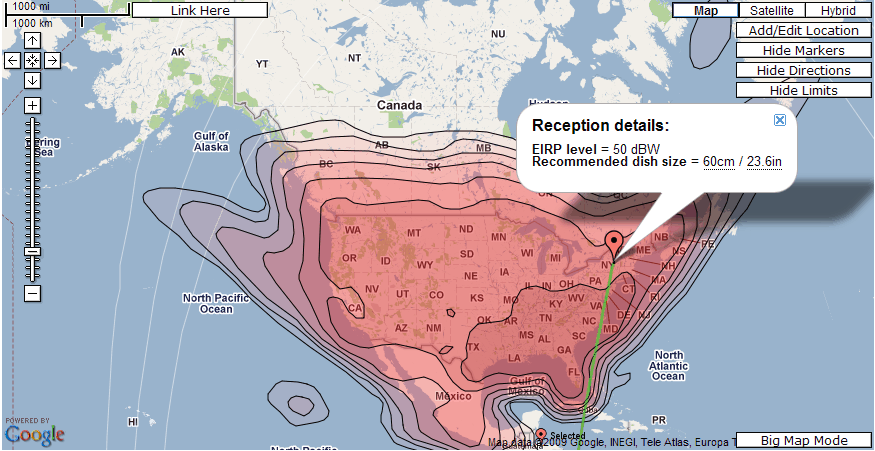

Presented below is the EIRP map for the footprint of AMC 9 @ 83.0W from SatBeams.com.
This should help you determine what dish size is required. Although it recommends a 60 cm dish for your location, you would be better served with a 76 cm dish (such as a Winegard DS-2076) or larger.
I have found that, at least in my location, the larger dish doesn't really result in that much of a gain in signal quality, but it does reduce the affect of other interference sources, especially rain fade.
I originally began with a Winegard 76 cm dish and then upgraded it to a GeoSatPro 1.2 M dish and found some very slight improvements, but a more stable level. According to the EIRP chart or footprint map for AMC 9, my EIRP level near Omaha, NE is supposed to be the same as yours in upstate NY.

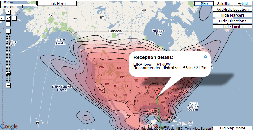

Just for everyone's reference, here is the same EIRP map for AMC 9 @ 83W, but with the pointer dialed into an arbitrary location in the SE US.
Notice the difference in minimum recommended dish size.
