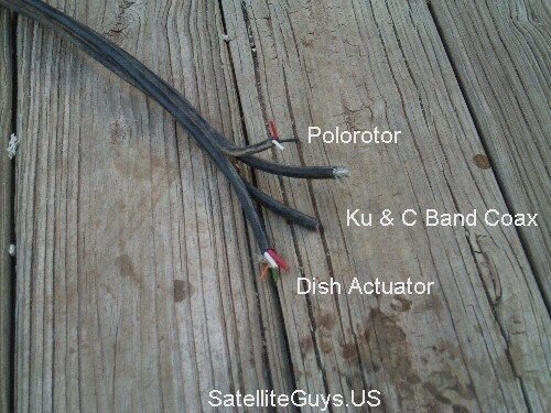

One of the 4 should be a bundle of wires for the Actuator with larger red and white wires about 12 or 14 gauge and the others much smaller... should be 2 coax (C & Ku) and the Polorotor wires... :) if you know it was at G5 perhaps wait on trying to move or mark the arm if it is not rusted togather...

Example of Ribbon Cable

whoa.. mine looks nothing like that. I had a toshiba receiver way back when and it had 4 spring-loaded connectors (like you would find on speakers)
There are 3 wires coming out of the LNB and one that goes to the motor. Each is just stranded wire. I will take a pic of it tonight if it might help.
I found a pic of the toshiba I had, online and there were the 4 spring terminals for the wires.
I dunno, might it be best to re-run the wires? The dish is only about 25' from the house, the 4 conductor still goes in the house and is just coiled up in the ceiling.
