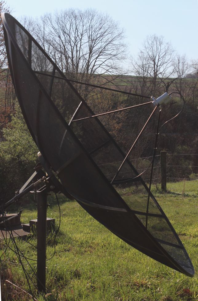

Welcome to Satellite Guys! If you have access to a truck or flat bed trailer your best option would be to haul it home in one piece without disassembly. If you must take it apart be sure to make some kind of marks showing you how the sections are currently joined together so that you can reassemble it back that way. Take photos if possible. My wife and I loaded and hauled a 10ft SAMI (mesh) on the back of my pickup truck from a few miles away without issue. If the dish is solid steel and you keep it in one piece you will likely need more than just the wife to help though. :D Here is a link to my thread about removing/refurbing it. Also, a pic of the dish at it's new home. Good luck! :)
