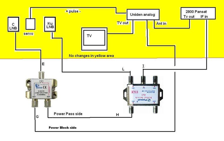

added diagram for programming info
Help would sure be appreciated in programming the Pansat 250Sm for use with a Disqc switch to select band. Setup works with either the C band or Ku band lnb directly wired to the STB. So it's just a matter of getting the receiver programmed correctly. Thanks

Disqc
I see you have been able to see "Possible Diseq settinga:1.0 #1 thru 1.0 #4,"
With your C band LNB connected to the Disqc switch port #1, Program your C band sats to Port #1. Program your Ku band sats to Port #2, with the Ku LNB connected to Port #2 on the disqc switch. Make sure the 250SM's IF input is connected to the receiver port on the disqc switch. That should work with both Ku snd C lnbs, and the disqc switch connected at the same time.

To Fat Air,
The wiring for C/KU is the same as shown in your attachment posted in
this thread. I assume port #1 is where the C-band comes into the Diseq
switch and port #2 is where KU comes into the diseq switch. If not, that
is why it's not working.
The only place I know on the 250sm to change diseq values is in the
Antenna Setup. I did one for C-band to 1.0 #1 and another for KU to 1.0 #2.
If you use the other parts to scan a sat, I don't know if the value set in the
Antenna Setup carries through to the others. The others don't have any
way of changing the diseq values. Anyway, I deleted all tps on amc3 C and
KU. Went into Antenna Setup and scanned C-band. Got nothing. Changed
to KU band and scanned and got nothing. Tried Smart Search and got
nothing.
I downloaded the Pansat bin from the Pansat site and from what I can see
they have done nothing to the software since 2008. So I have NOT
updated the receiver. Anyway their instructions are not very clear.
Surely someone out there has a 250sm and can help with this, PLEASE.
Look at the disqc switch and see which port your Ku lead goes to, Use that port setting in the antenna setup for your Ku sats. Do the same for your C band. The diagram and your wiring may not look physically the same.

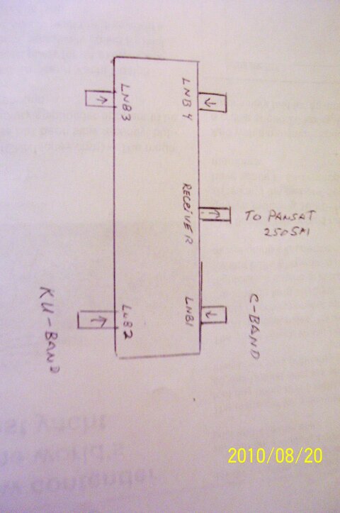

To Fat Air,
See the attached diagram.
I assume that Port is the same as lnb.
I moved them from lnb3/lnb4 to lnb1/lnb2.
Still no signal.
Lnb1 is set to diseq 1.0 #1. C-band
Lnb2 is set to diseq 1.0 #2. KU-band
Yep- looks like Port or disqc programming # = LNB # on switch. I am at a loss as to why it is not working, other than the switch itself being bad. Do you have another you could try? Remember- all power off when messing with a disqc switch, they are sensitive.
