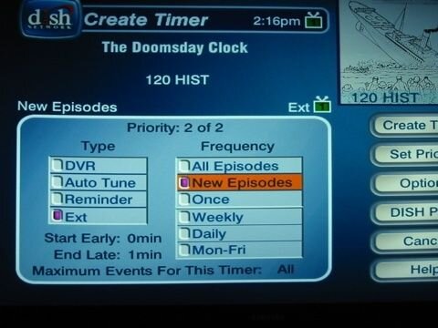

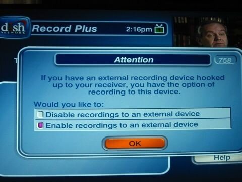

Anyone get the record to external HD to work? The timer fires but no record light or HD activity. I'm using the new Mybook Essential 2 which works perfectly otherwise. Found this feature while installing my replacement 622.

Record to external device is for automated recordings to the POCKETDISH not to an external harddrive.

he wants to record directly to the ehd
i saw that menu and was thinking maybe it could do it as well, but i havent read about anyone doing it on here so i guess it cant be done
you can't record directly to the EHD. have to DVR it, pay the $40 to activate EHD func, and then transfer from DVR to EHD. you can transfer back to DVR, too, if you want. the whole transfer thing is a bit slow, but happens in the background. Menu -> 4 -> 2 (to begin transfer)

Once you do have the program transferred to the external hard drive, you can watch it from there without having to move it back to the Dish box. The menu is a little slow to come up but once the program is started it is just like watching any other DVR program and the quality is the same.
