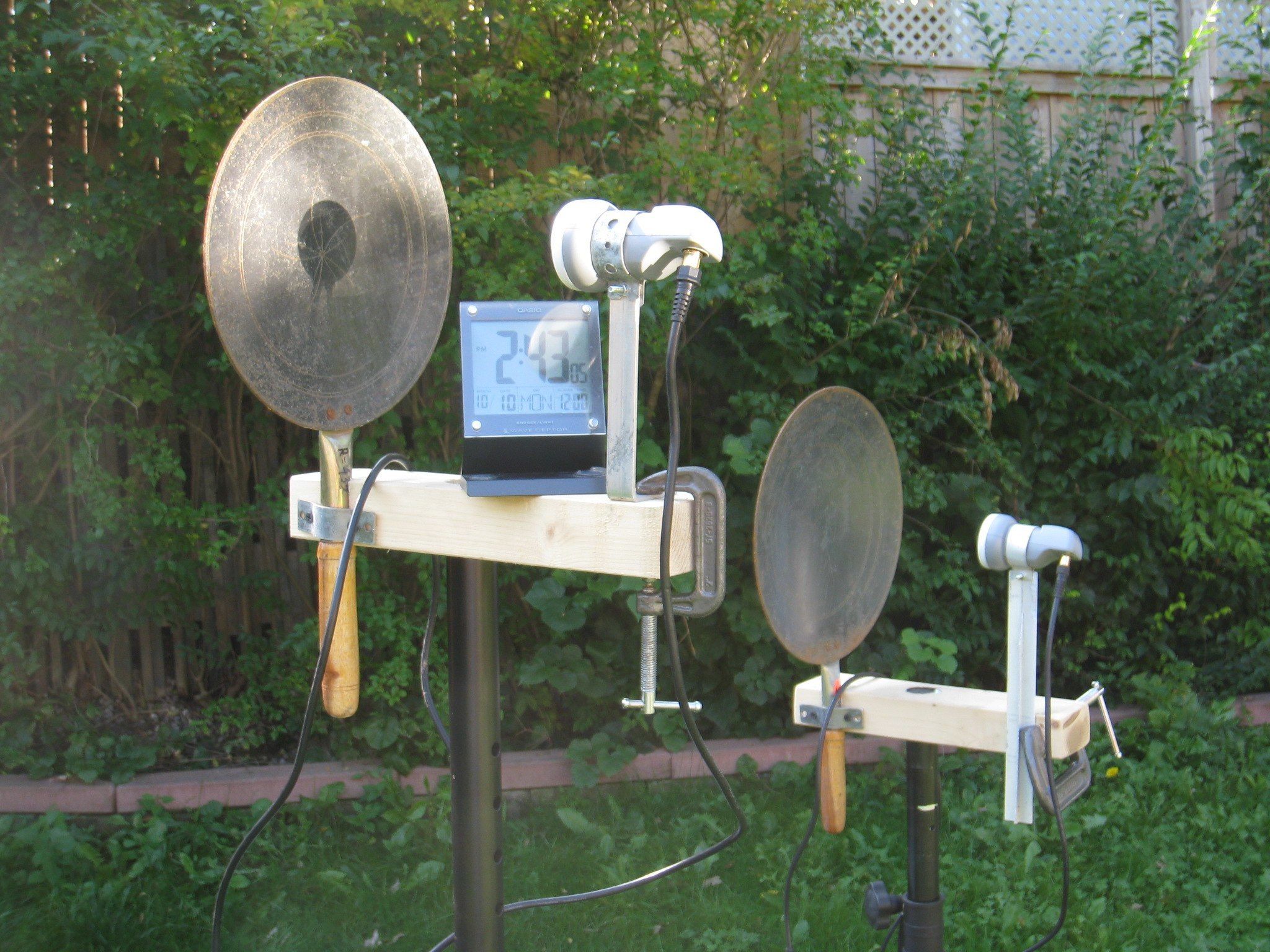

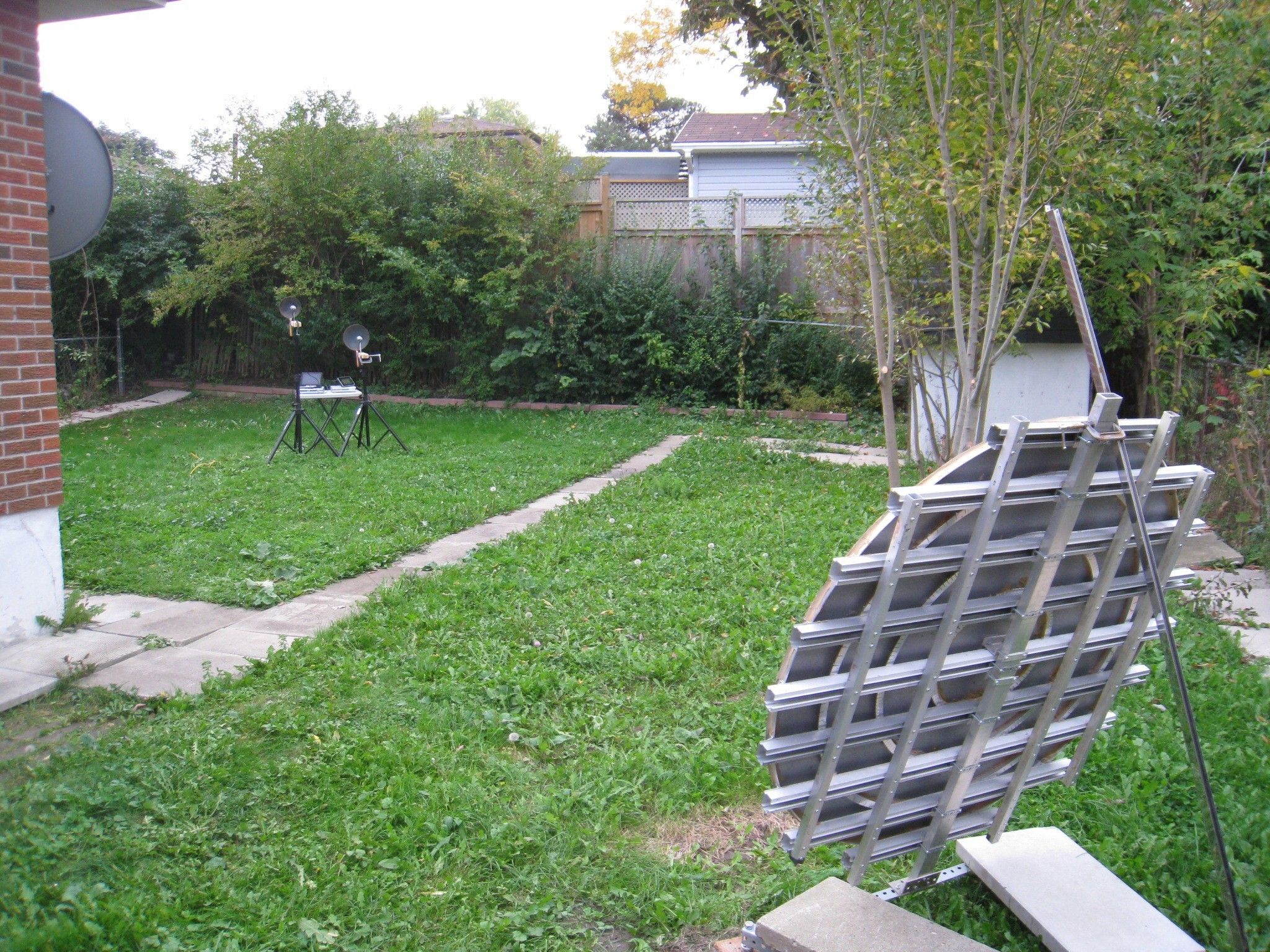

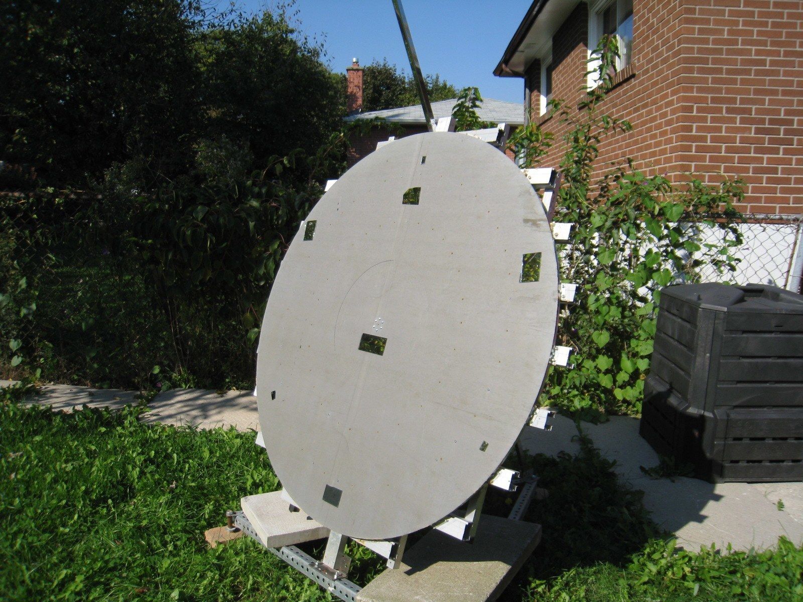

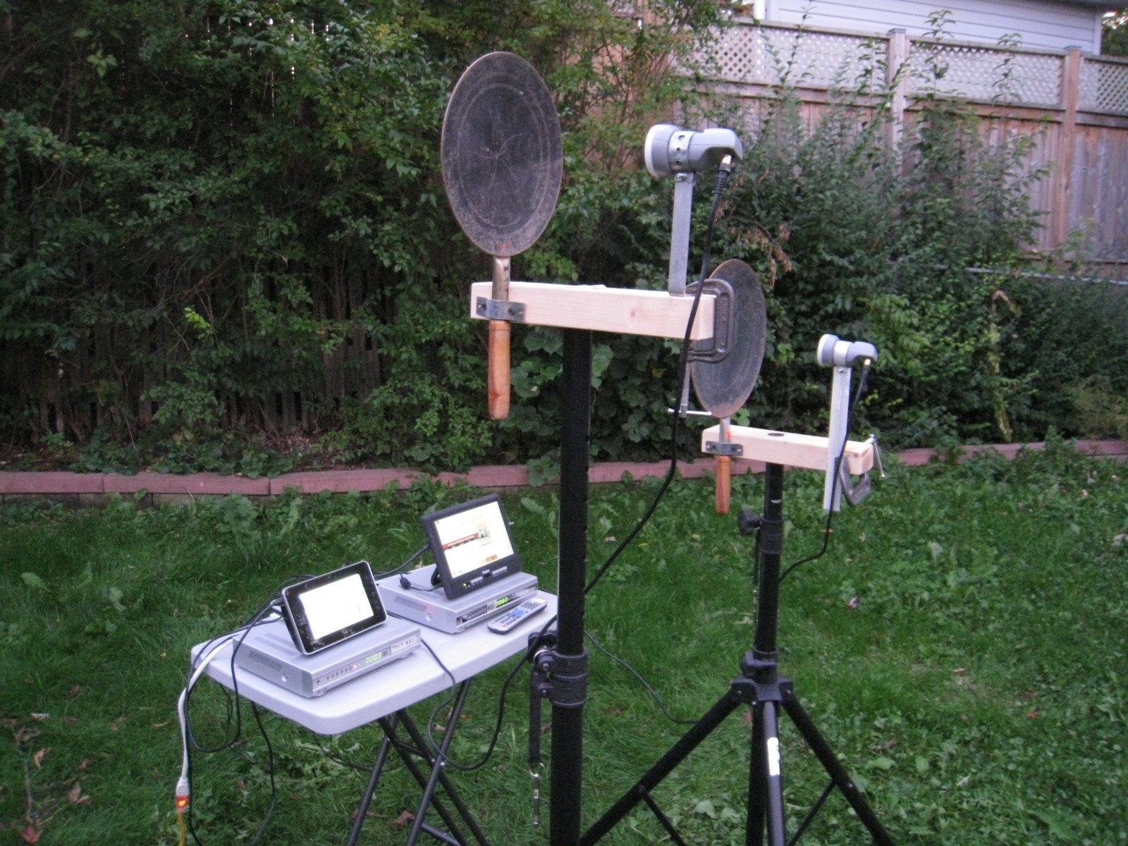

Recently I completed some trials in receiving satellite signal after bouncing it off additional surface which has rather long focal length. I built sort of dish, 46" diameter, which is very shallow, less than half inch. I was hoping to put LNB in its focus and catch a signal. Unfortunately, the focus was not well defined (I think some inevitable inaccuracies happened when I made this dish, also the surface of sheet metal was not straight). So I had to use additional small concave surface, for which I used frying pan lid, and later spherical cooking utensils. Finally I was able to receive signals from 97W and 101W simultaneously, using 2 receivers and 2 small TV's. These cooking pans are 10" and 12" and for receiving these satellites they were spaced 28" apart, with one 12" higher than the other. I had to reverse skew, too. (Just wonder how it would be with circular polarization...). Maybe this technique will be useful for people not having direct access to the sky from their home? The "reflector" could be located somewhere in the backyard, and one or more small dishes just below the fascia, or (?) who knows, maybe behind window? I tried to add some photos, but older photos from my previous post popped up, now I see I have to learn more how to use attachments. Luckily I was able to add my avatar. If anybody is interested, please, PM me and I will e-mail photos. Cheers, polgyver

Before trial with double system, I used 18" dish to roughly locate the place. I also used digital inclinometer (bought in Lee Valley store) for setting the angle of big dish (for Toronto, 97W has altitude 36.4 degree, so I set the big dish at 18.2 to get the reflected rays parallel to ground> Later, I used data from Naval Observatory for info about Sun and a few mirrors to locate the focus. Still later, I raised the big dish as the speaker stands holding small (secondary) dishes could not be lowered enough. Thanks for a friendly acceptance of these tinkering !
