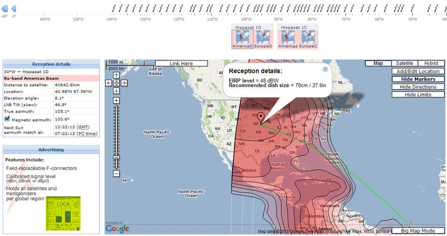

EIRP Charts for 30.0°W
Attached are the EIRP charts for Hispasat 30.0°W 1D America's Beam. The chart for Hispasat 1C and 1D are virtually identical, so I won't post both in this case.
RADAR

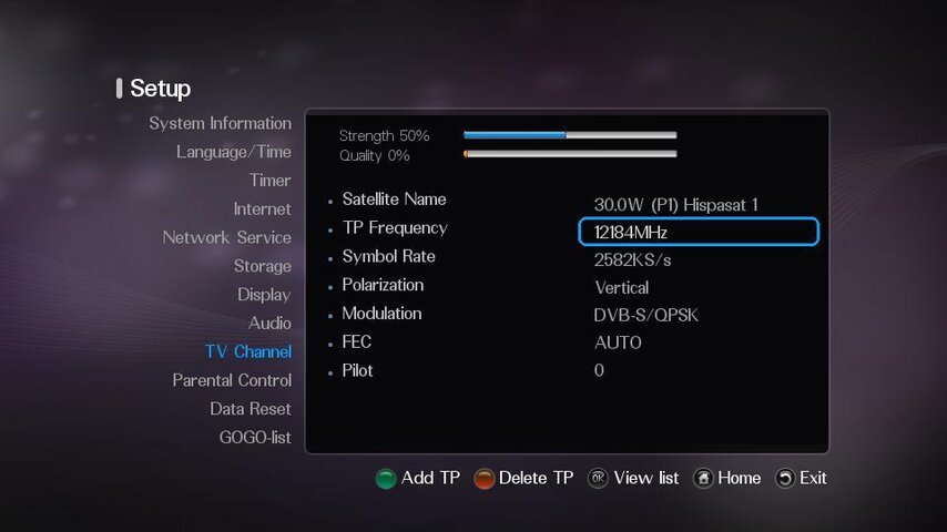

Hispasat 30.0°W 1C/1D Transponders set 1 of 3
Here I will list the TPs that I am currently aware of from Hispasat. I will display the settings and signal/quality level indications from my AZBox Premium receiver as a screen shot from each individual TP. Some TPs show no quality levels. A few of these are feed TPs and not active at the time that the screen shots were taken. Some others I do not have an explanation for.
These readings were taken using a 1.2 M GeoSAT Pro antenna, an Invacom QPH-031 LNBF and the AZBox Premium in the area just 40 miles NW of Omaha, NE USA.
There are 21 TPs that I know of that are deemed as "Americas Beam" and these are what I will display (three posts).

I think it is a good idea since it will allow anyone to compare the signal levels between TP's and have an idea whether they can still fine tune their dish a bit more or whether it is properly skewed. Even if you do not have an azbox or do not live close to NE more likely TVE Mux will always be stronger than Colombian and Canal 11 Salta and Canal 21 will be the weakest (maybe both Canal 8 or TV libre , memory fails now). Also it shows that even the DVB-S2 Uruguayan is stronger than the Colombian and equal than the Cuban or TVE. Besides you could adjust polarity a bit more by knowing the ratio between the 12172H and 12173V signals (although it depends whether your system is properly skewed) Obviously we all know you have to adjust untill signal starts degrading but it is better if you have a practical example.
BTW it is funny but I think the Cuban Mux changed FEC from 3/4 to 2/3 sometime ago now (at least both my CS only locks it with 3/4) but your AZBox still shows 3/4. I wonder if it also tries an AUTO FEC internally to always lock no matter what (that does not make any sense but too late for my brain ,lol) Also screen 4 and 5 are acctually the same TP or same signal , the colombian mux I guess so you can delete one of them.
Extra info always helps if properly analized. Thanks for the compilation.
HDFan,
Thank you.
I don't know about the FEC setting. I think the box will override your entry if it knows that you are wrong (but I wish it would display the change if so).
Which screens (4 and 5) were you referring to? Which post number was that in. I looked and didn't see it right off.
RADAR
post number 3 , pictures 4 and 5 . 11936V SR 7500(picture 4) is the actual numbers for the colombian mux. picture 5 shows 11940V with the same parameters and same 53% Q. the signal is almost 8 mhz wide so on my CS8100 it locks up to 11939V. No lock with 11940V on my CS8100. On the cuban mux my CS 8100 will only lock it on 2/3 FEC and Auto. CS6000 does not have a FEC setting so it is by default on auto.
