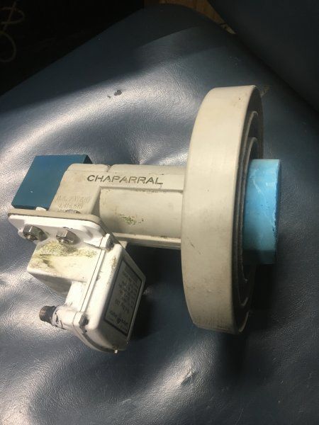

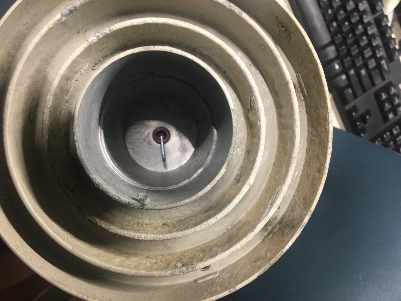

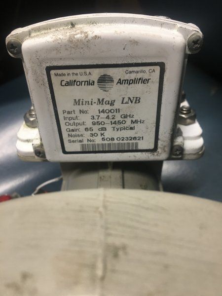

Thank you for the welcome - I look forward to being a contributing member and supporter :) While I would love to say that the LNBF assembly does C-band and Ku-band, it does not, it is C-band only. I probably should mention that this entire setup has been unused for at least 18 years, as it was there when my buddy bought the house that long ago, and I found markings on the back of one of the panels that I think are alignment marks scratched into it by the people who installed it, along with what looks like a signature and a date that appears to be May 8th 1989. My friend said that was a year after the house was built, so the dish (and probably the LNBF as well) probably dates from at least the late 80's.
The LNBF seems to be in good shape, even if it's a bit weathered. The plastic cap on the feedhorn and the rear of the assembly are both badly weathered and chalky, and I am trying to not handle those plastic parts as much as possible because it seems they are disintegrating with every touch.
Should I look into replacing the LNBF assembly before I get into this? Certainly couldn't hurt to modernize the whole thing, but I really don't want to start chucking money at this project until I can at least verify my installation efforts are going to be successful.

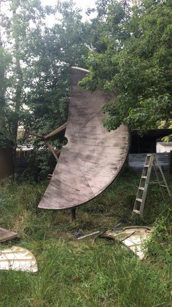

I managed to get a few pictures, so here goes...
This is the dish, on its mount - half-way disassembled. The brush and grass around it was waist-high, but nothing that I couldn't tackle, armed with a razor-sharp cutlass and sheer determination :D
From what I can find, this appears to be a pretty decent assembly, complete with feedhorn, LNB, and polarotor ...?
