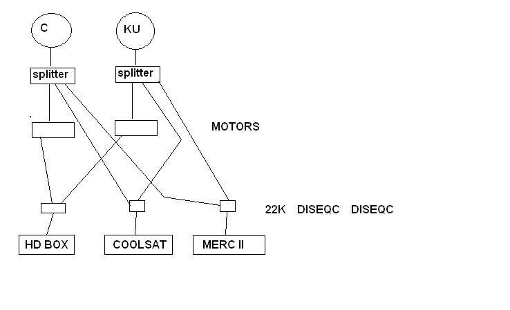

I'm no artist, so after your done laughing at the drawing, help me out.
I have 1 RG6 cable from my 39" dish and 1 ribbon cable off my 8' running into the side of the house into one of the spare bedrooms (now my play room). I want to hookup 3 of my receivers. The Coolsat has nothing but KU sats on it, while the Mercury II has nothing but C-band on it, and the Diamond has both KU and C-band, and i want to hook them all together. Can this be done?? If so, what kind of switches do i need? All power pass? One port pass? If its one port, who gets the power? Or should diplexers be used?? I'm a little confused on this one, so let me know what you guys think.
THANKS

you can add the other side of the satellites into the box. So all 3 boxes could be able to see both C & KU ;)
couple questions though
-are either LNB's duals?
-looks like one of the boxes controls the big dish. Which box controls the C-Band dish?
reason I ask is if they are duals, then just use a multiswitch. If the LNB's are just singles, then you can have polarity clashing between the boxes.
It can be done :)
Maybe we can give better options, once you answer Ice's questions? But, in the meantime, if you have (or get) some dual/twin lnb's (one for the C-Band and one for the ku-Band), you can get a 4x4 (or 5x4) multi-switch and hook the C-Band to one side (one side is normal V & H and the other side is 22KHz V & H) and the ku-Band to the other side. Then it has 4 outputs for up to 4 receivers. And if you have (or you could get) a V-Box to move the dish.
Neither LNB is a dual. their both single. the one on the c-band is a chap micro and doesn't have the servo. i'm using a g-box to move the big dish and a hh-120 for the 39". i can have ku hooked up on the hd box and when i want to watch the c-band, i just unhook the ku cable and plug in the c-band cable and it works great. just thought their might be away to combine all of it (like in the drawing) so i didn't have to unhook anything.
You could use splitters on both but they would have to go between the motor and the LNB
If the HD box does indeed control both motors, get a ecoda 22k switch. They pass diseqc/motor commands.

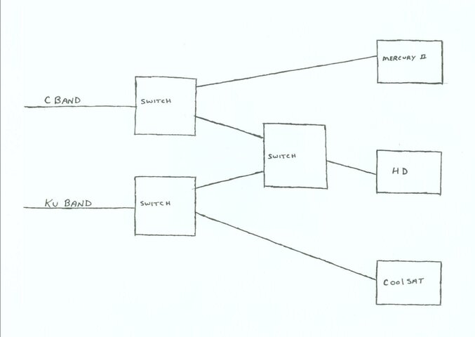

OK...really crappy pic
get a couple 4 way satellite splitters and split the cable 3 ways
on the HD box, use an ecoda 22k switch to hook up both C & KU. On the other 2 lines you can use 2 way Diseqc switches (or 22k switches)
Then all 3 boxes can see either C Band or KU :)
The diamond will run both motors. With the ku rg6 connected, it turns the dish. If i unhook the ku cable and connect the c cable coming out of the g-box, it will turn the big dish.
