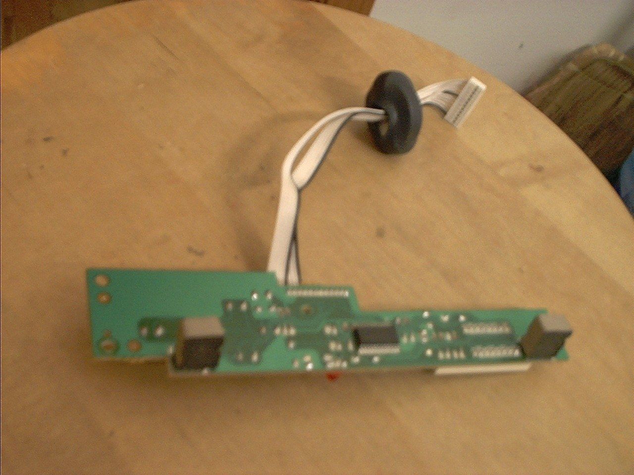

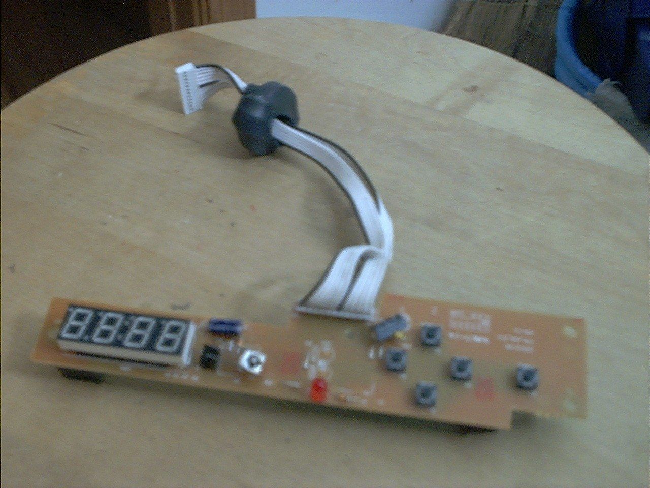

Brian, here are a couple of pics of the board in question. I'm sorry that they are not better quality. Thanks for everything.
Doug
