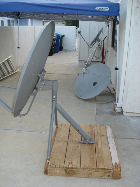

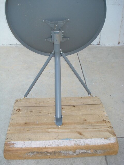

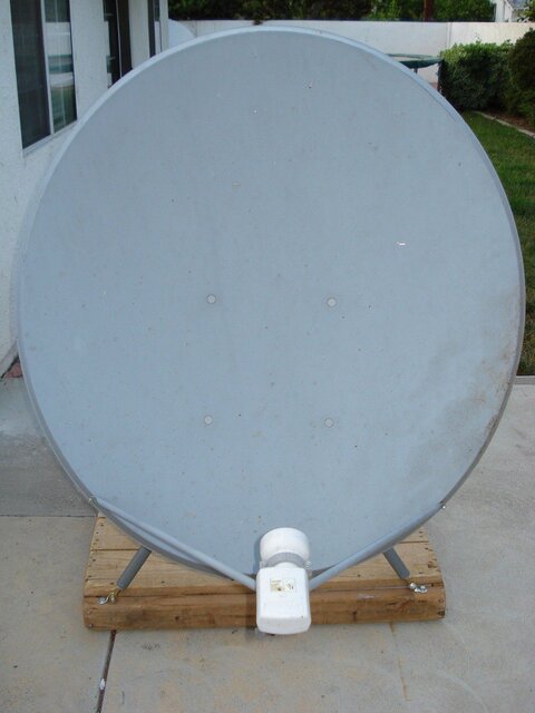

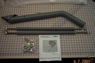

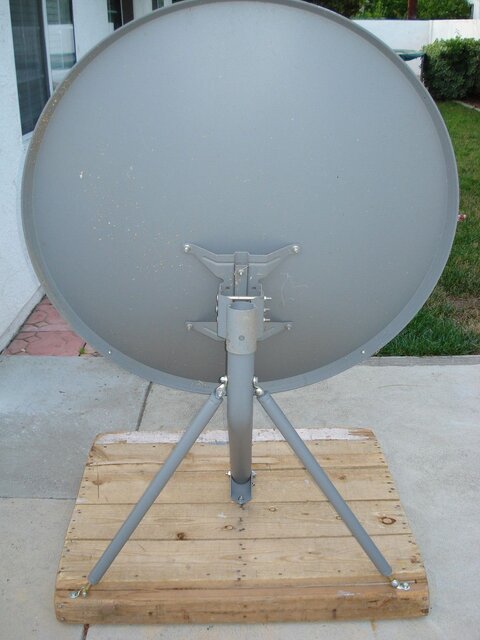

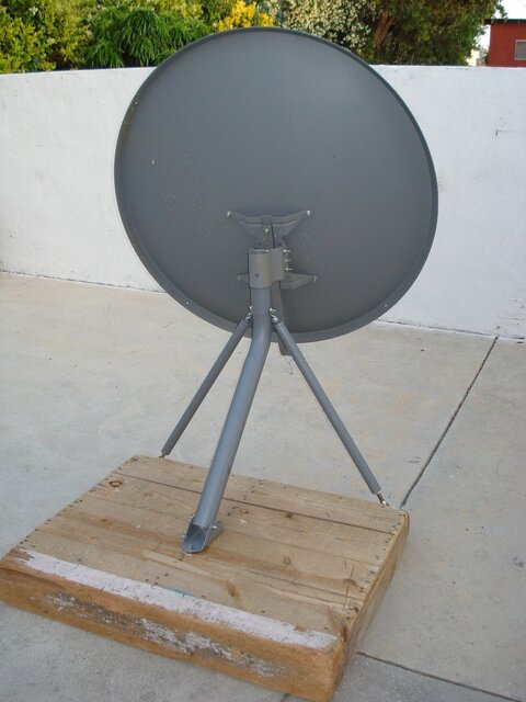

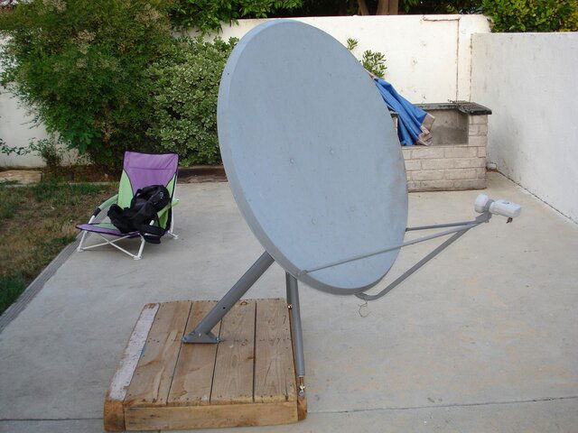

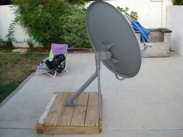

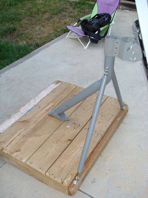

OK here is my ghetto mount + pole + Winegard 100cm dish. I have not mounted the C-band LNB yet since its Laker time hehe.
The mount I purchased from ebay that is an actual Starband 2 3/8" pole with very strong arm supports (better then what my Directv slimline has).

I had a mast setup like that when I got one of my Primestar dishes...them supports are sturdy
also nice pics but what size is that one dish in the background (the looks like a c-band dish)?
Thats a 3ft prime focus made by Panarex in the 90's. With its own ring mount.
I did list it here for sale in 07 and no one got it. (good thing cause it has seen use since then lol)

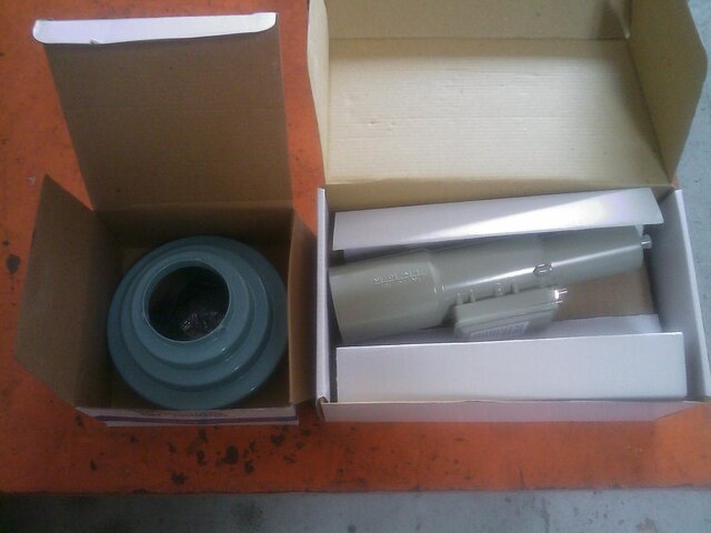

Well with WS becoming a gold sponsor, I purchased the DMX741 combo last night for my 1m dish. Conical + Ring + DMX741 Standard. It can also be used on a 1.2m I have laying around as soon as the 3" mount is accomplished.
Looks like the 421 LNB will be heading back to the garage for now.
Just received my order from WS.. now I can test my 1m and then the 1.2m thereafter.

sweet. Keep us updated :)
Man I just got home and my 1m winegard dish does not have the proper hole at the tip of the LNB arm to mount the cband clamp to it. So might take me longer then I thought hehe.
