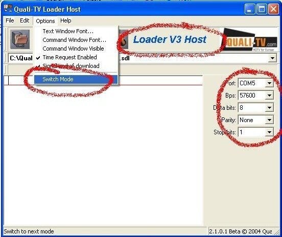

Confirm your Com Port:
Control Panel
System
Hardware Tab
Device Manager
Ports (Com & LPT)
What Com Ports are listed? (for me, it's Com 5 on my laptop)
Unplug the power cored from the Quali, needs to be unplugged for a few minutes before uploading new firmware.
Start the Loader Program
Use "Switch Mode" to set to "Loader V3 Host"
Under "File" select "Open Download File" and navigate to where you stored the new firmware, and select "QS1080IR_SV316.sdl"
Double check Loader settings
Now plug in the Power Cord, download should start automatically.
Control Panel
System
Hardware Tab
Device Manager
Ports (Com & LPT)
Thanks, but everything you have noted i attempted yesterday.
On my laptop, its COM 8 where I get the error when I start the .exe, although COM8 works for 2 other devices when I attempt to connect to them via serial port.
On my desktop computer, its COM 1. I do not get the error when I start the .exe on it.
All settings are exactly as you show and the unit ignores the update when power is applied, even after being unplugged for an hour.
As noted the pin configuration listed in the pdf has also been verified by an ohm meter.
Appears I have a bad unit that will not take an update and so it will not do the 60 field American Standard :(
