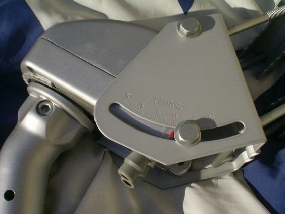

Okay guys I'm excited. I've got the pole and my motor mounted on the roof and will be putting up the dish in the morning (got to go to work and I've done all I can in the heat up there). I've got a Fortec Limetime Classic NA, a Fortec 90cm dish with a Invacom QPH-031 LNB. According to SatFinder, my true south sat is Nimiq 2 (zip is 29690). From my readings here, I understand that this is a DBS satellite. Knowing that, with the circular polarity of 031, I will be able to pull something in in order to line up my dish, right? While almost everything on there is encrypted the are a couple of "info" channels that are in the clear...would I tune to one of those, or can I just lock on to any TP? I figured it'd be best to ask ahead of time instead of crawling up there and become baffled. Thanks a million, you guys are the best.

Due to other "distractions" this morning, I didn't get to spend as much time with my dish as I had planned. I only got about two hours of tinkering in. I mounted the dish and started aiming. I was aggravated at first (the vallium helped, hahahaha) since I couldn't get a hold of ANY signal. While aiming at Nimiq 2 (well, I thought I was) I found some kind of signal. After doing a blind search, I found that I had pulled in one of the DISH network sats, and found a promo for a PocketDISH receiver. Anyone know what sat this is? I know I'm offline of course. Anyways, I'm having trouble with the motor too. How do I tell it where a satellite is? When I lock on a sat, then go after another, then I try to return to that sat again, it goes to where it thinks it is, not to the position I had it where it worked. Err! At least I peaked out at 93% on that bird. It's definately frustrating but I know it'll be rewarding when I'm done.

Okay. I'll give that a shot tomorrow afternoon. I have class in the morning. First day back...at least it's my last year in college. I'm studying Electrical Engineering for those that might be curious. Like I said, I'm just glad I picked up SOMETHING...that's a lot better than nothing. At least I know it's working. I might go over this "easy setup" guide that I found on here for the SG2100 and see what I might have done wrong. I'm certain that I lined up my True South incorrectly. I must've not compensated for magnetic declination correctly. Of course, I do wanna see where I'm at in the sky. Thank you all for the replies. It certainly makes things easier having help from all of you. Can't wait till I know what I'm doing so I can help others.
You can use Google Earth to find south by finding your house and checking the orientation of south to your property. That's a trick a lot of us have used :)
Day 2 seemed to be A LOT better. Figured out my TRUE south and lined it up. Within about 10 mins I found Nimiq 2 which was easy to find. I've got it locked in at 93. Scanning for other sats has seemed to be a challenge though. I'm playing with it now and I'll soon post my findings. I got a hold of AMC 5 at about 85% for most TPs. I'm working on SBS6 right now. These are weaker and tougher than the DBS sats (obviously). I'll keep you guys posted.
