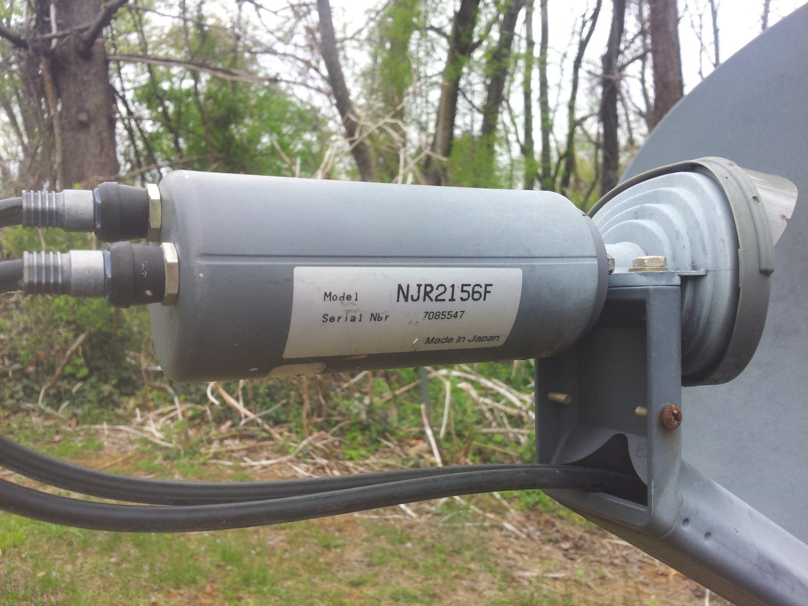

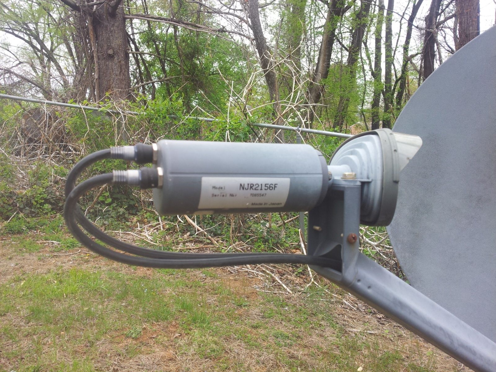

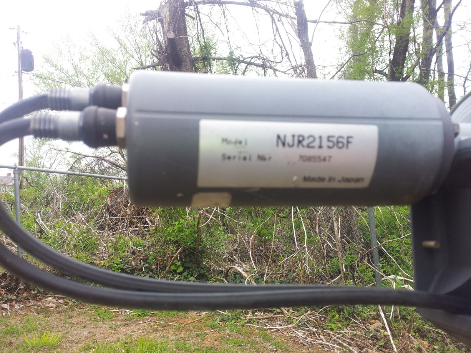

Now I would suggest taking off the cover on the LNB to see how many outputs are on there. The older ones had 2 outputs but one was vertical polarity and one was horizontal polarity. If so you can either switch out the LNB or get a 2x4 (or 3x4) multiswitch to combine the polarities together
As Iceberg stated you will need a multiswitch to go along with that Primestar ( Japan Radio ) LNB or there is a Eagle Aspen dual output lnb out there that will bolt right up th the C 120 flange that is a dual polarity with no need for a multiswitch...I can not for the life of me find a link but it is out there.

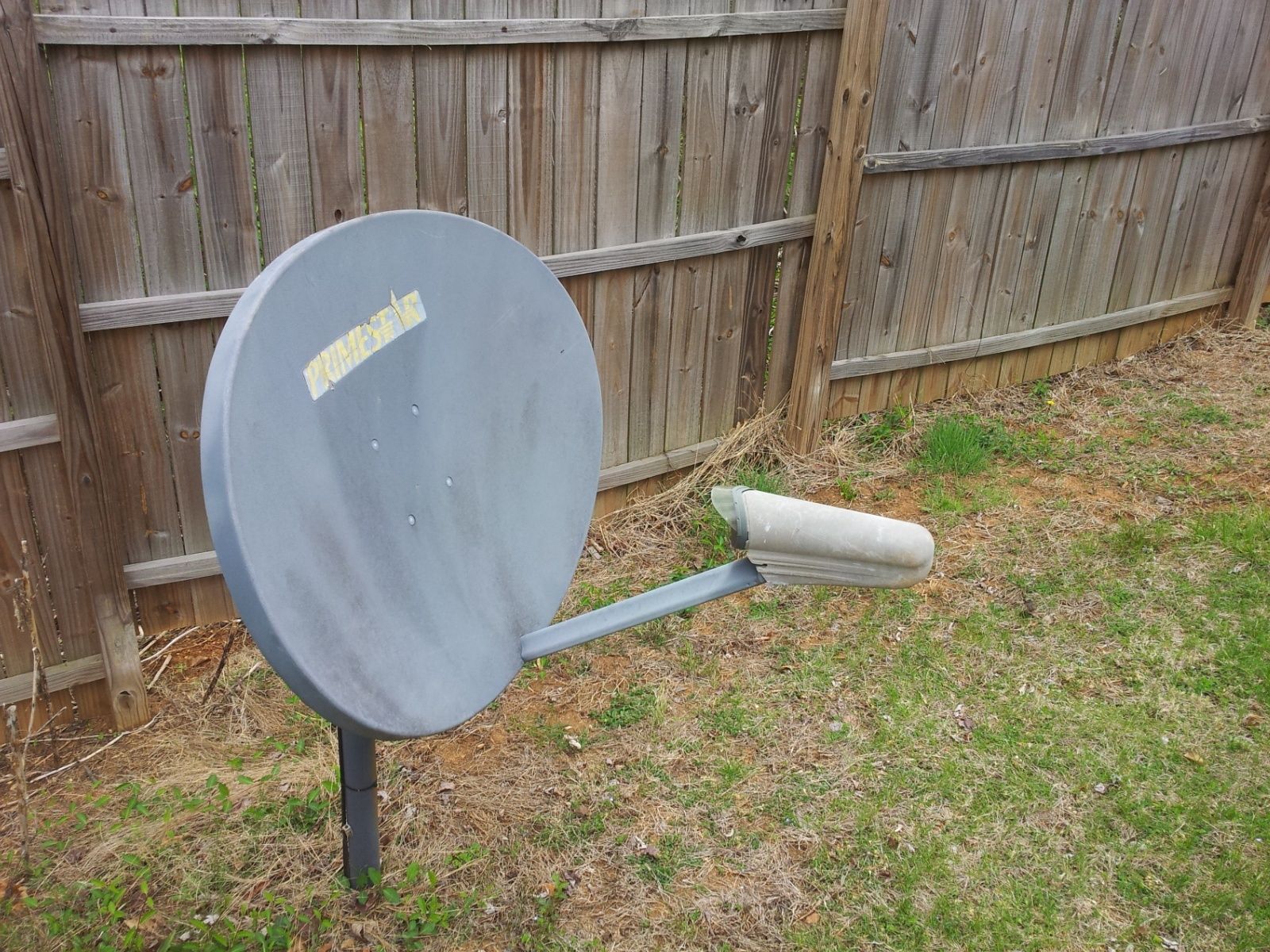

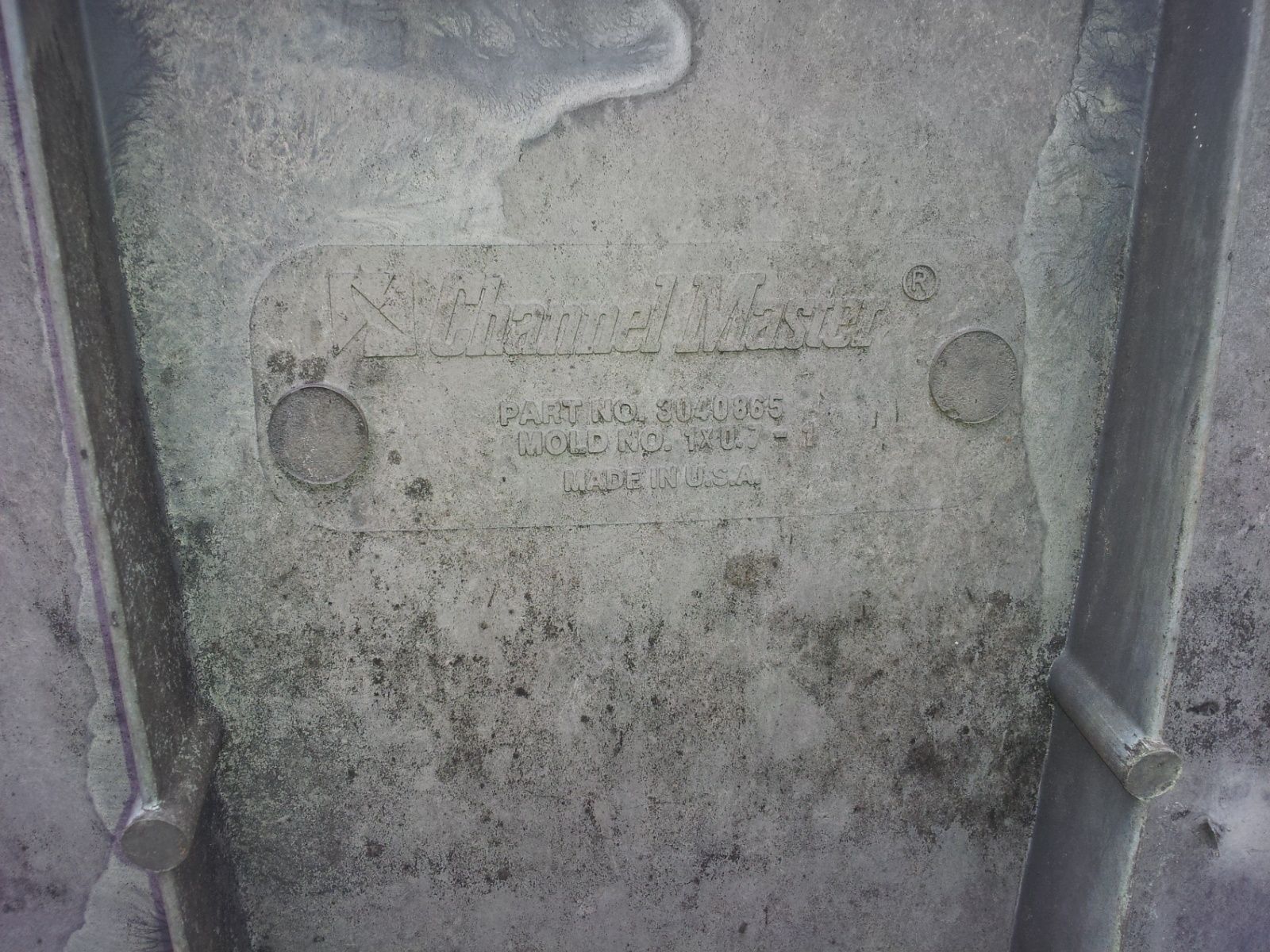

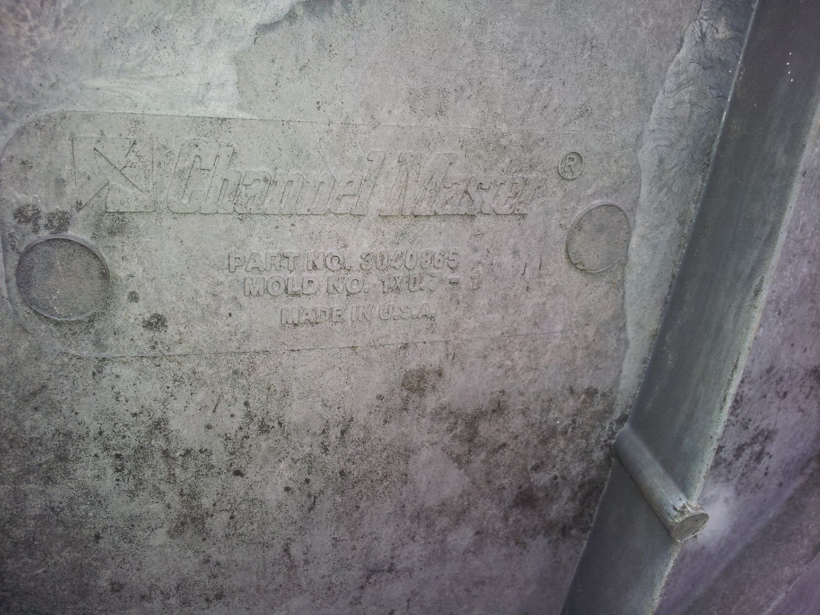

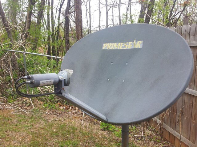

Ok, guys sorry for going through the archives :o, instead of starting a new one. I'm new to this thing but here it goes--it seems that the dish is Channel Masters it '39wx 30h... the last two images is a shot of the back of the dish it seems like it says 1x0.7-1 part no.# 3040865 MADE IN THE U.S.A
thank you all!! for every little or lot of help on this matter...hopefully I can learn a lot from you guys so I can start to watch shows...asap

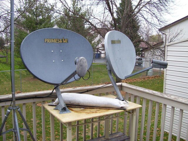

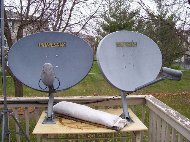

nice dish. Its a 84e dish which were 40x30 inches. Thats the same dish I posted above
You will need a 3x4 (or 2x4) multiswitch to combine the vertical and horizontal polarity. Looks like this
The 3rd input is for an antenna

Nah give up on Cband with that dish..It is a very good performer for Ku...You can motorize that dish if you want.An sg2100 does good but over time that heavy fiberglass dish will take it toll on any motor we have here.
He may still have cable from it run inside the house, I wonder if it would still be good after several years. Seems like the Primestar receiver used both cables to the receiver but i could be wrong. If he plans to use the dish where it is, i would definitely try out the existing cable, using one cable of the twin, that is. Great dishes for KU-I have 3 of them just like it, and a couple of the more round version too. No, make that 3 round, they started to multiply for awhile! One is parked on 103, one on 72 and the other one is motorized.
