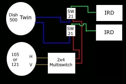

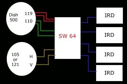

A little about the old Primestar LNBF courtesy of the old dishinfo.info site:
Think of this style of LNB as like a standard dual LNB, but one side is locked to each polarity. If your using a switch that does this already, like the SW64 or SW44, you can simply get away with directly connecting each output to its related input on the switch
For switches that don't lock the LNB, like the SW21 or SW42 a basic 2 input 4 output multiswitch is needed.

If you use the Primestar dish with the dual H/V LNB, you CAN use it with a DP34. HOWEVER, this will ONLY work if your locals are on an ODD transponder. AND, keep in mind that E* is notorious about shuffling channels around, so just because it is on an ODD now, doesn't mean it will stay on an odd. The reason this works is because the P* LNB is NOT voltage switched, like most other legacy LNBs. Therefore, the 19V charge from the DP34 will allow the P* LNB to send the odds back on the lower band where it is expected. With a voltage switched LNB, the 19V chage would send the evens back on the lower band, and DP is not expecting it on the lower band. I don't remeber which polarty E*9 uses for the odds, but it CAN work. This is the ONLY instance of a legacy LNB working with a DP setup that I know of, and it is unique because of how the P* LNB works.
