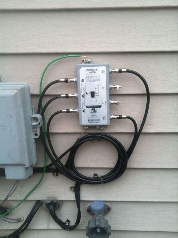

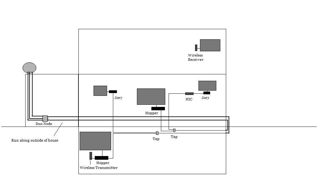

After the techs were able to get the duo node in the afternoon, we were finally able to do a proper walkthrough for my 2H/2J system. Both had around 10 years experience. Their company has a contract with Dish to take care of this area. They had already run through some 1H/2J installs, but no 2H installs. They knew off the bat that i had read a lot about this system by the way i was answering their questions.
Originally, i had thought that there was a chance they might just use the home distribution since it was RG6 and we'd be able to place the Hoppers wherever i wanted. After asking questions and talking with them for a few minutes during the walkthrough, i got the idea that they didn't want to deal with that old wiring for the Hoppers. I realized on my own that they would have to come back for any problems or even worse the customer calls Dish and they would get dinged for it. If all the cable was identifiable as 3GHZ RG6, they would definitely have used it for the hoppers.
The problem with new wiring for the two hoppers is this would have required a LOT of wall fishing. I had some idea of a backup plan to move around hoppers and passed this on to the tech. Basically we came up with a plan to put both hoppers in rooms that were as close to the Dish as possible and would minimize any exterior lines on the siding. Basically as invisible as possible for the penetrations. I didn't have any huge preference on where the Hoppers were since Joeys pretty much do the same thing, but it did feel weird putting a hopper in the same room as the worst tv.
Once we made the room change, the tech realized that he didn't have to "exactly" replace the DPP44 switch with the node. He could move the node outside where the original satellite lines penetrate the house and then reuse the internal home distribution for the Joeys only (then barrel connect the lines where the DPP44 used to be). By putting the node outside, we also minimized the amount of new cable that needed to be run for the hoppers and we placed it as hidden and close to both the penetration and the two hopper rooms. In my case, the coax lines from the dish come down behind the AC unit and the penetration is in the same place. All fairly hidden behind some bushes as well.
Once we had a basic plan, they started hammering it out. I needed a new Dish for a fourth orbital and so we could use the integrated switch (and lose the DPP44). They actually replaced all the lines from the Dish to the node and didn't bother reusing the old stuff since it was basically unmarked.

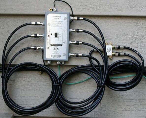

As seen in the pictures below, duo node was setup clean and thoroughly grounded from the dish. Since there were already three lines going into the home distribution, i asked him if he wouldn't mind just connecting that extra line to a splitter (i only have 2J right now). That way everything is nicely connected up. If i ever need a third joey or want to easily move around Joeys, i could do that at the home distribution inside rather than tinker with the node outside.
Second picture is what's left of the home distribution system and the DPP44 switch. Two barrel connected lines for the Joeys and the extra line barreled and capped with a terminator. (I wish I had pictures of how badly that DPP44 was done before, but you can imagine)

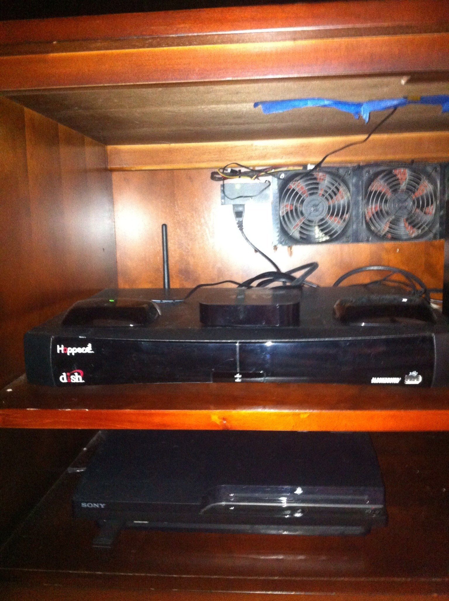

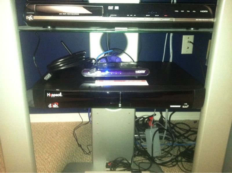

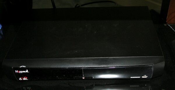

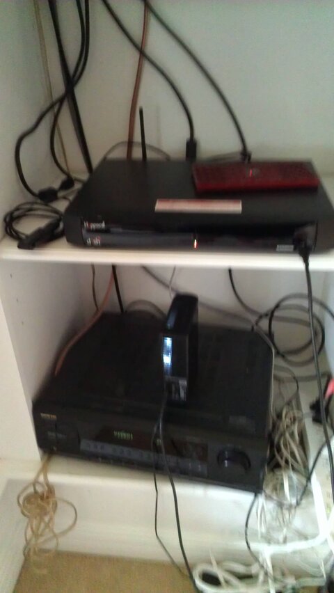

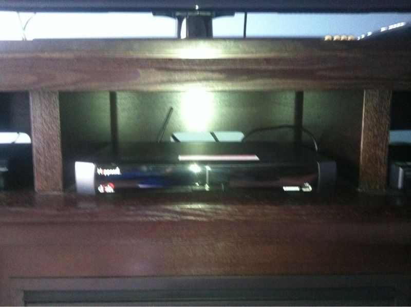

Rest of the pics are pretty self explanatory. Peeled off the ugly sticker on the Hopper. HIC right next to the Joey. I might remove the splitter behind Joey/HIC and use the passthrough. It doesn't really matter as it works both ways in my setup.

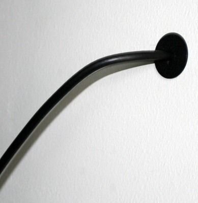

Wall penetrations just used wall bushings and all straight through from the node to the hopper. No barrels or wall plates to troubleshoot. All the penetrations are hidden behind speakers or table so it's clean. If I get bored one day, i might add wall plates. It did however take some very careful measuring to make sure that the penetrations were made in a place that looked good on the outside and inside. They probably measured 4 times for each penetration.

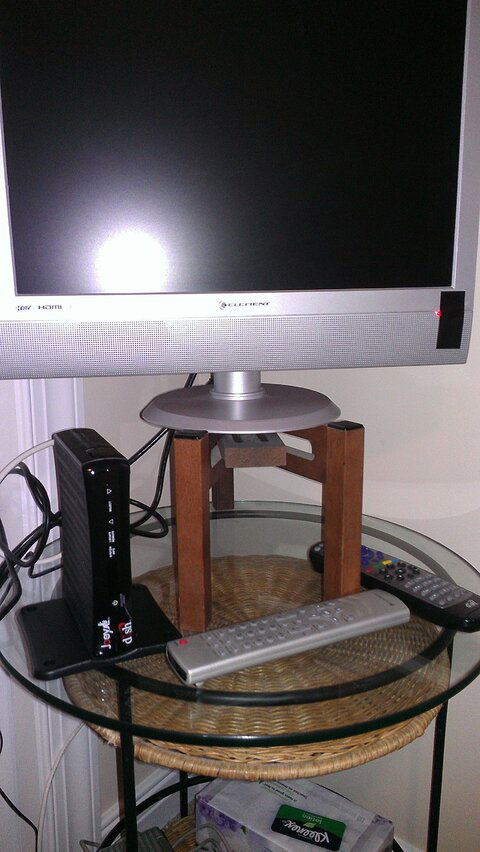

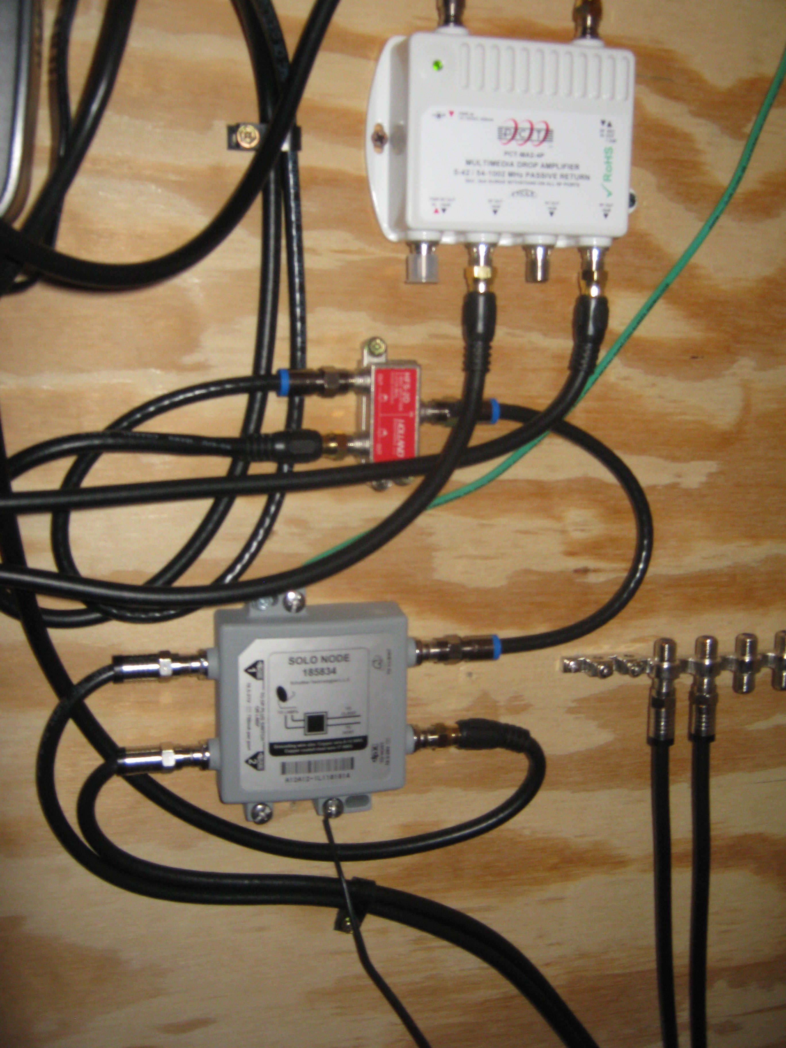

1 Hopper/2 Joeys

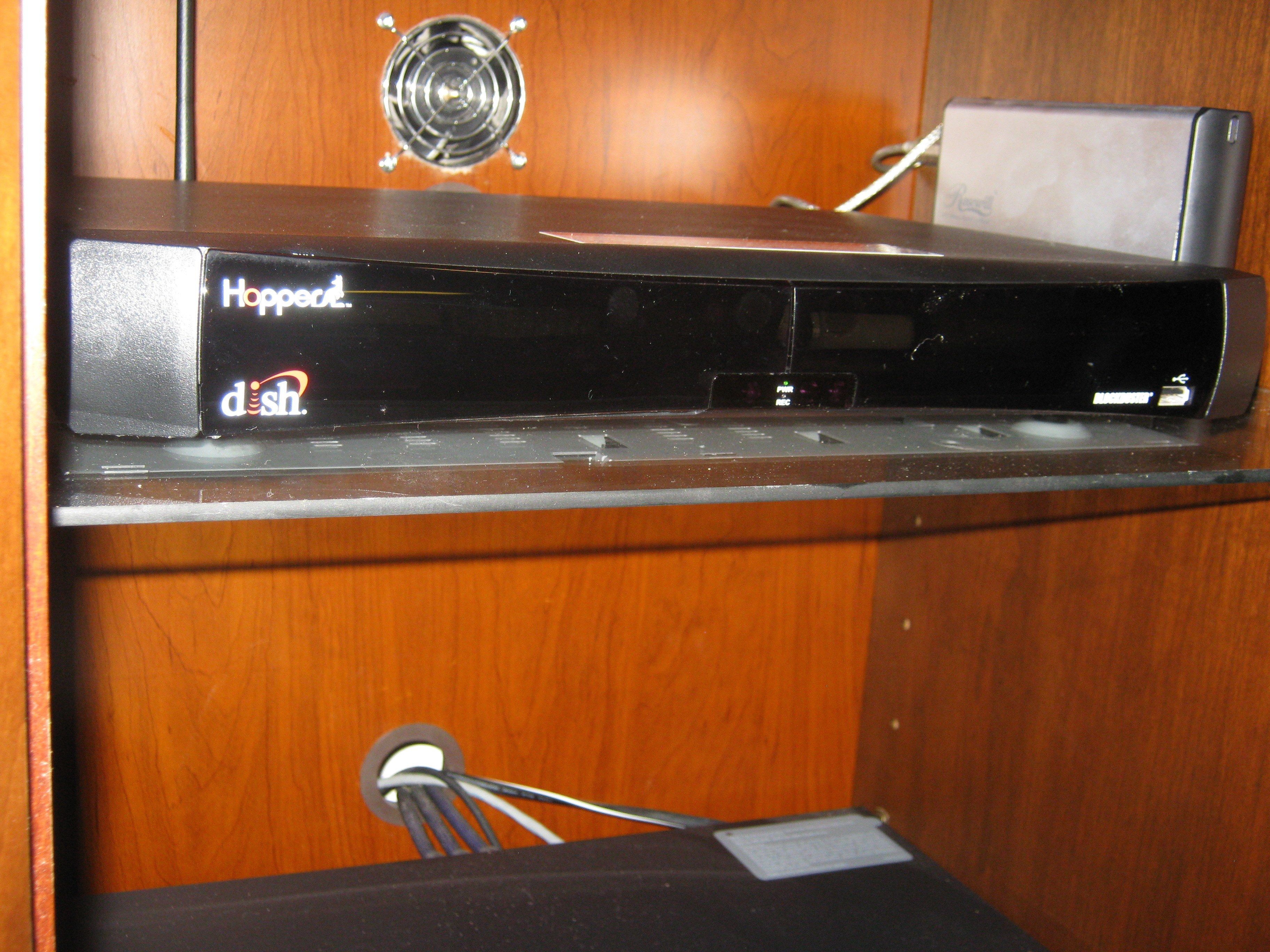

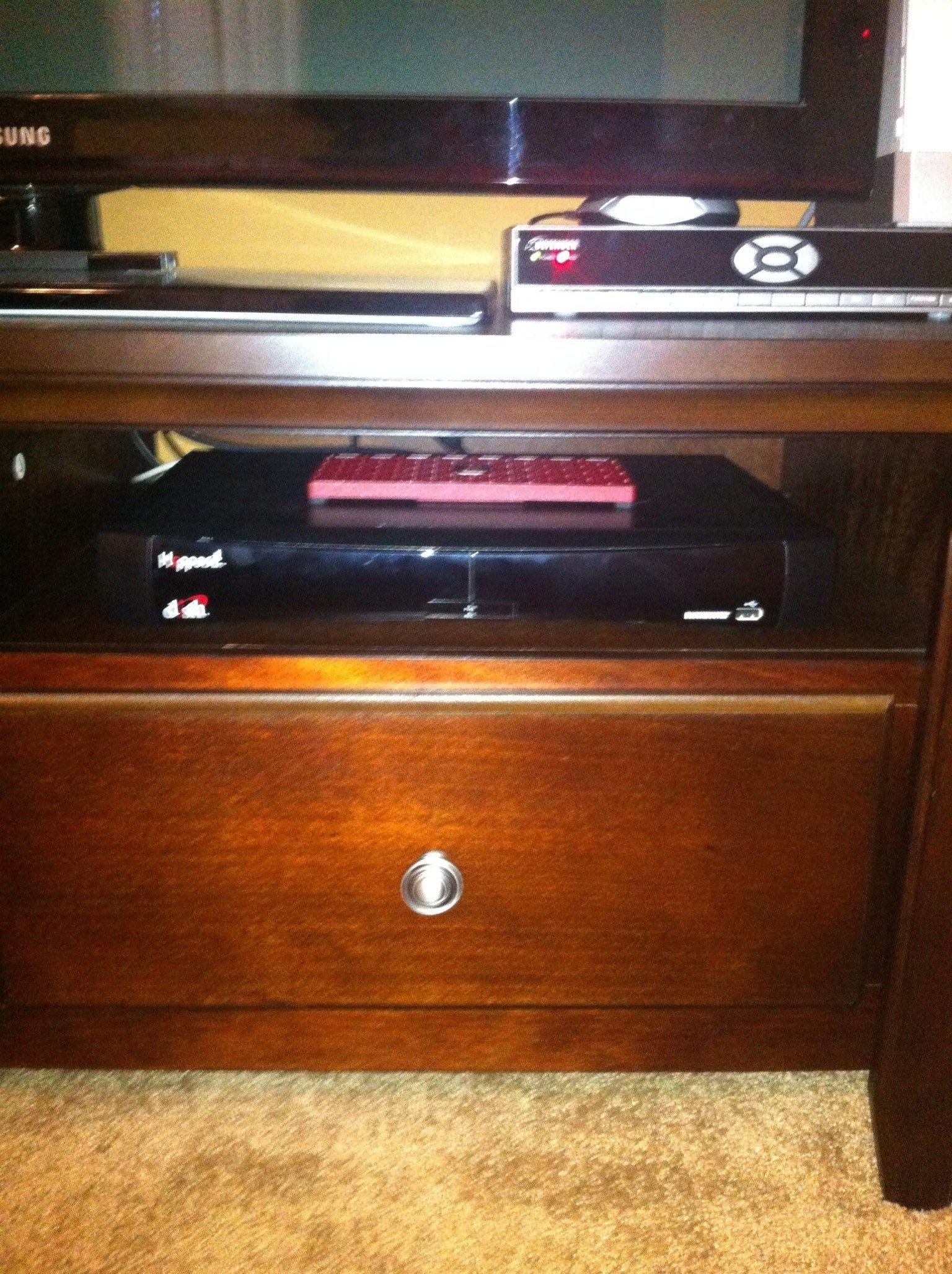

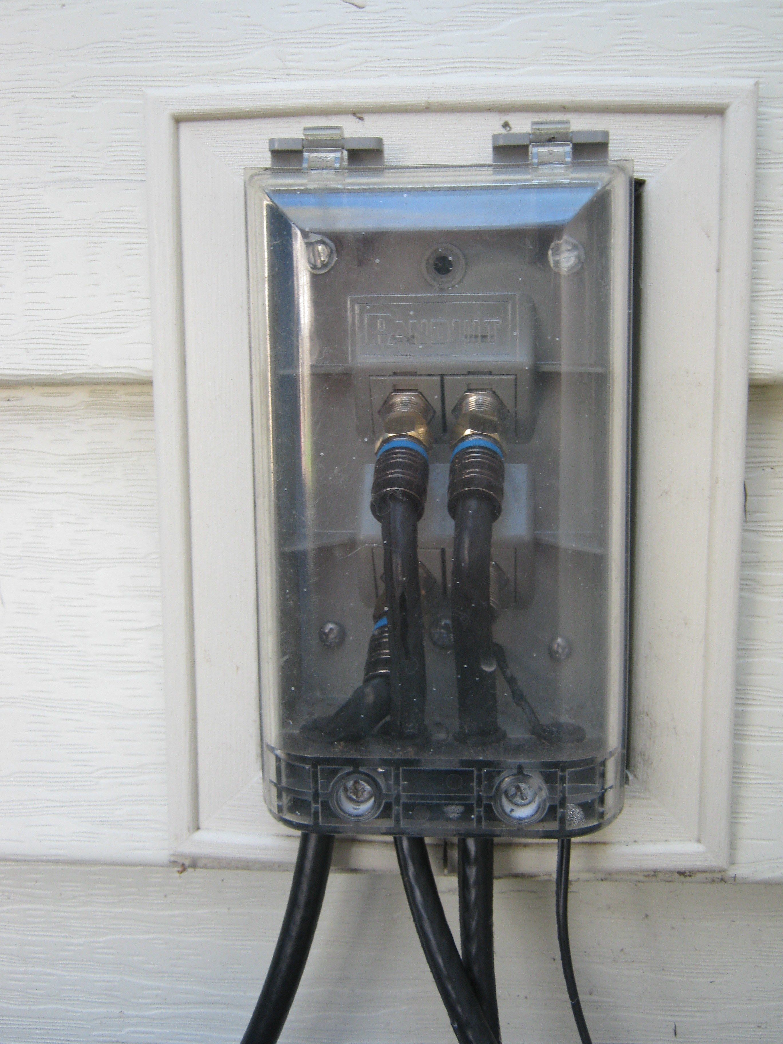

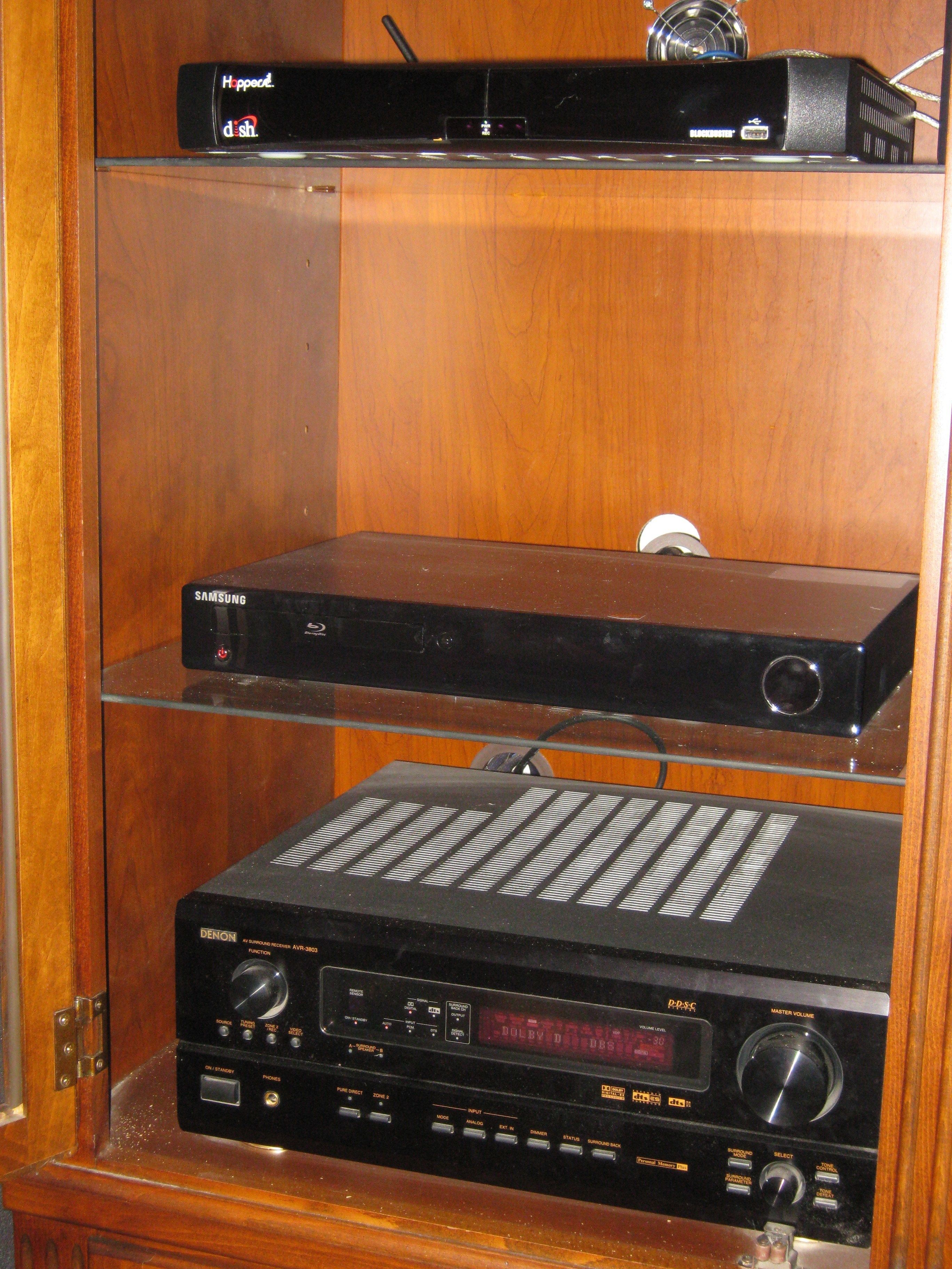

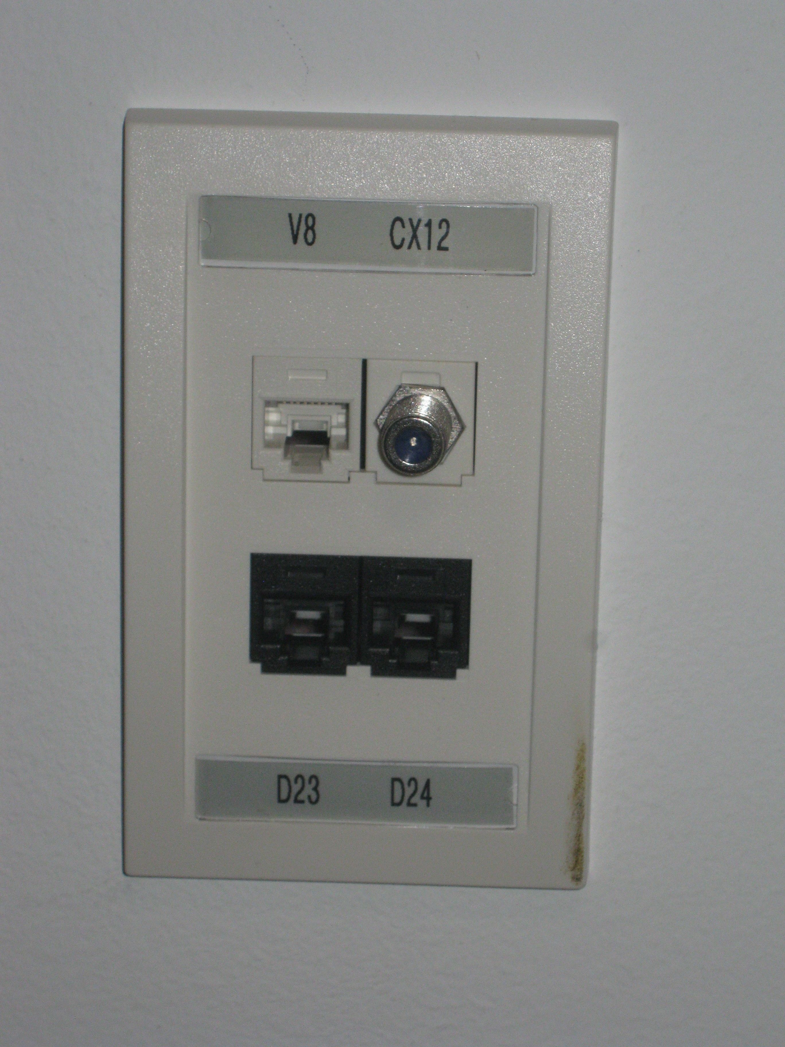

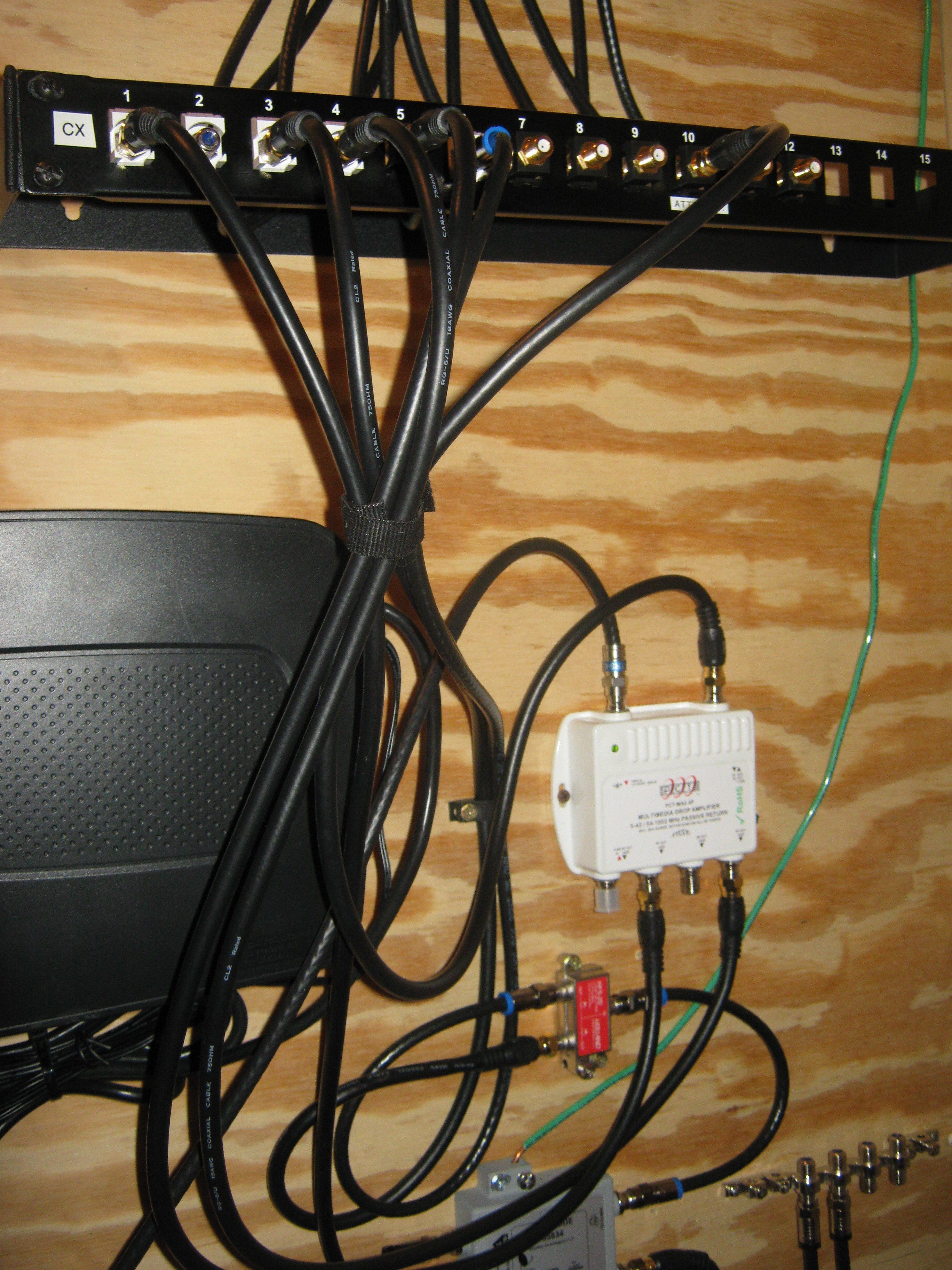

My Setup:

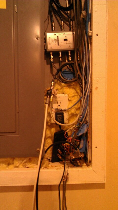

2 lines coming off the Dish to a weather-proof connection box on the house
Into the house to a central distribution panel
Node and splitter mounted inside under distribution panel
All coax is RG6 Quad-shield 3GHz end-to-end
Wall plates are made by Panduit. Coax jack is 3GHz rated.
Install tech was happy when he examined my setup. Basically he only had to mount the node and connect it and then place the Hopper/Joeys/ He had already done a bunch of H/J installs so he knew what he was doing. The whole install only took 90 minutes.

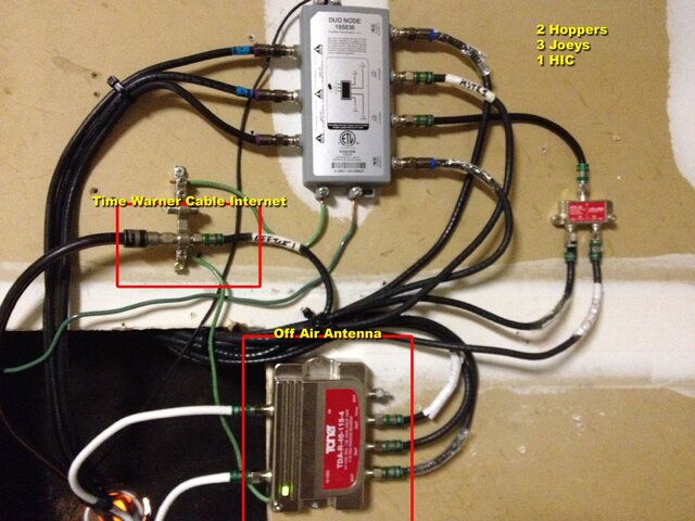

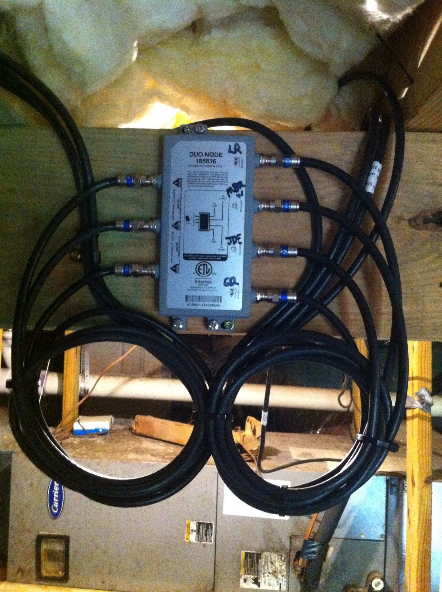

2 Hoppers / 3 Joeys
My Setup:
3 lines coming from 1000.4 Dish
Into the central distribution panel in the basement
Duo Node located in the central distribution panel

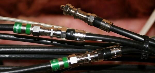

Tech cleaned up the Dish lines coming in. All he had to do was install the node and connect it to the dish, grounding wires, and of course to the Hoppers and Joeys. The tech also verified that the barrel connectors on the Hoppers were good. Install took 4.5 hours (most of it spent him taking notes and pictures of the install) (required by AEI for some stupid reason :rolleyes:). Will add some pictures of the Joeys later.

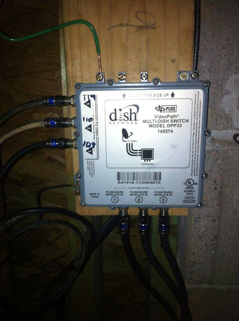

Old System
Two Dish 500s
129 wing dish going to the LNB of the 110/119 dish
722 & 722K
New System
All three runs now going into a DPP33
Duo Node
2 Hoppers/2 Joeys
DPP33.JPGDuo Node.JPGLiving Room Hopper.JPGMaster Bedroom Joey.JPGGame Room Hopper.JPGDaughters Joey.JPG

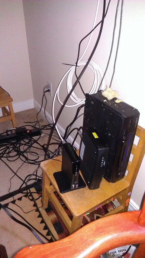

I have a plethora of wires here with all the electronic gadgets we have accumulated over the yrs.However all wires are hidden pretty well.Those nodes with all those wires looks like a rats nest to me.Somehow you would think there would be a cleaner looking way to have a hopper setup.Wife wouldn't be too pleased with something like the node mounted on the wall.I suppose if we do decide to upgrade we could place the node under the house.I have seen a couple of dtv distribution setups under house or in basement.

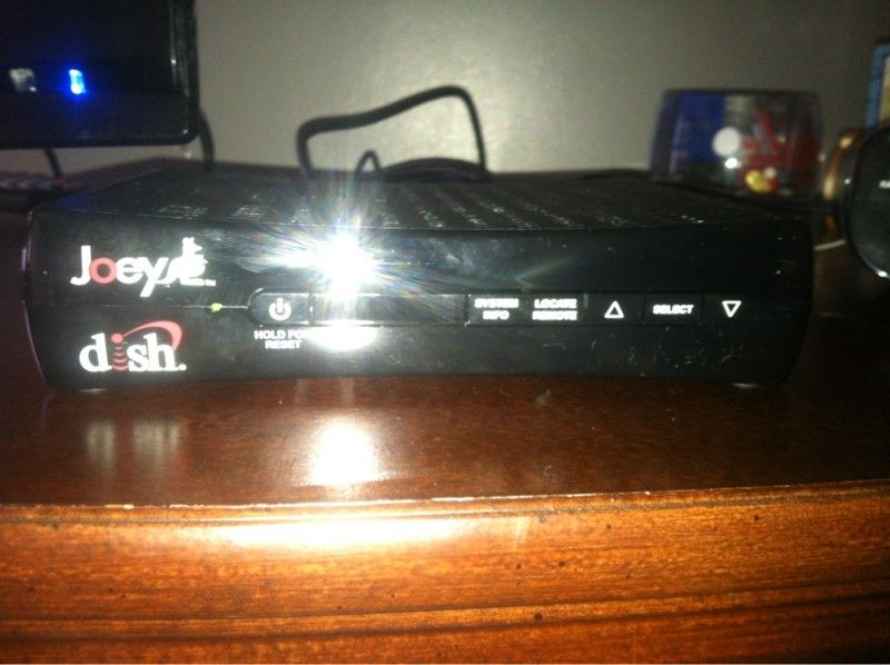

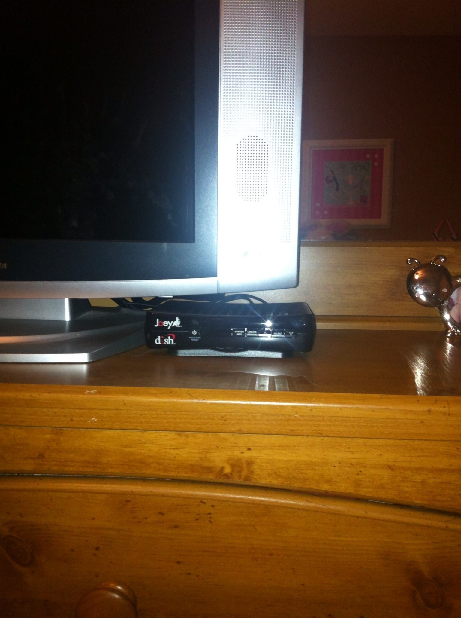

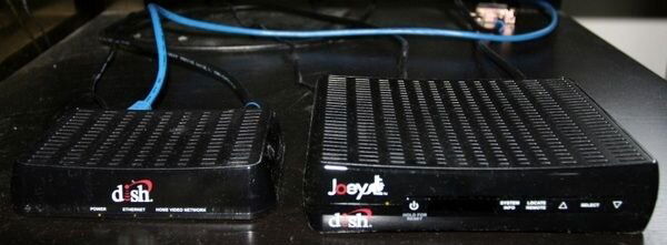

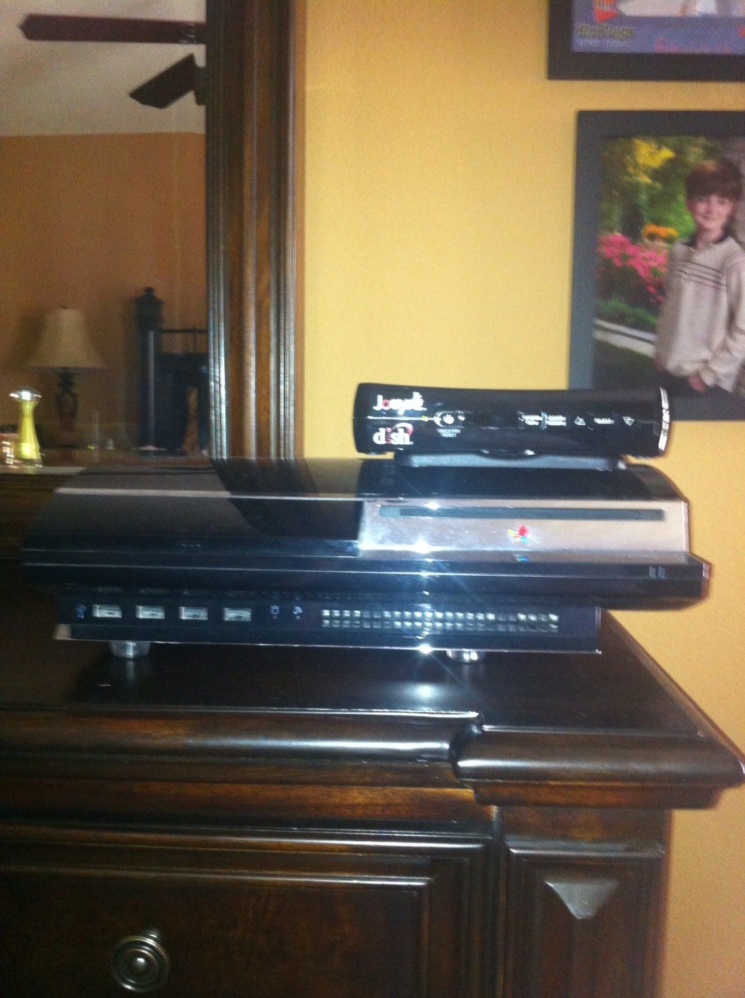

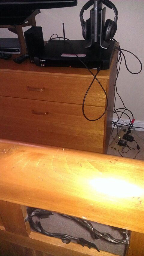

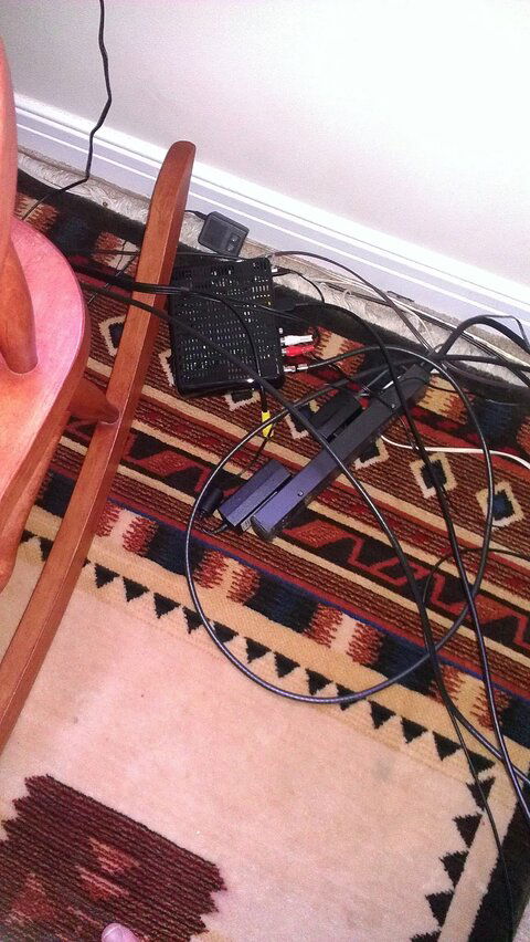

Here is some pics of my Joeys. Joey 1 is connected to my Optoma projector (currently laying on the floor due to my longer HDMI cable breaking). Joey 2 is connected to a RF modulator (old VCR) and fed to a few SDTVs. Joey 3 is on a smaller HDTV.
