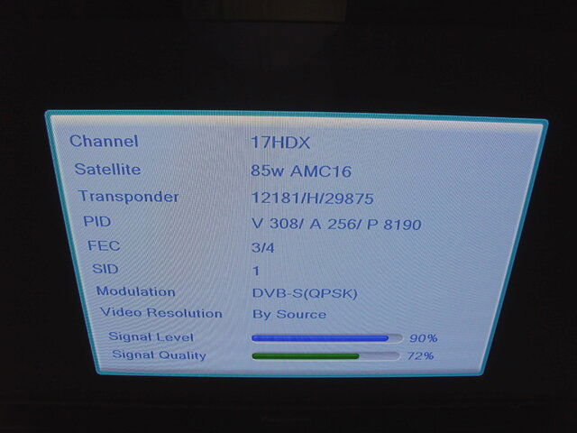

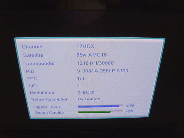

found one right now
85W
scanned in a scrambled feed at 12181 H 30000 (which it should be that symbol rate)...
went to 91 and scanned that sat
then went back to 85 and rescanned....found the channel at 12181 H 29875...so 125 off on the symbol rate
logs channel twice

found one right now
85W
logs channel twice
Your FEC and Modulation are showing up as different also...... Flip between the pics like flash cards, and see the difference. I'd think this was an lnb issue, but it's an odd one for sure.
the channel is scrambled so it may throw that off. But the other feed I found that was in the clear showed the same info
