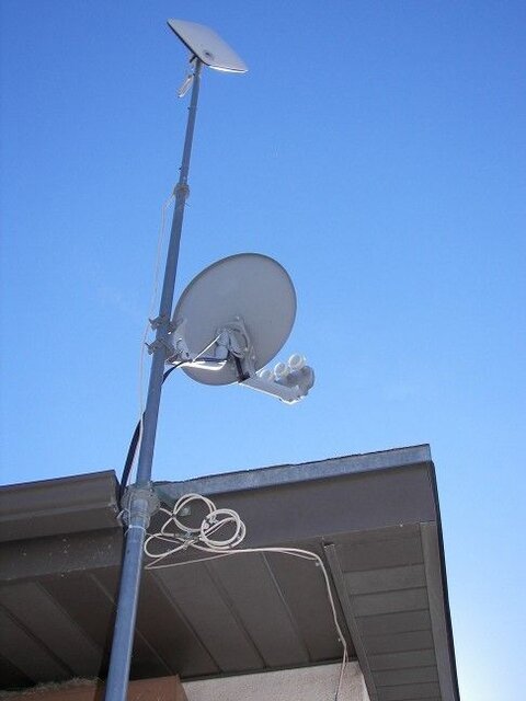

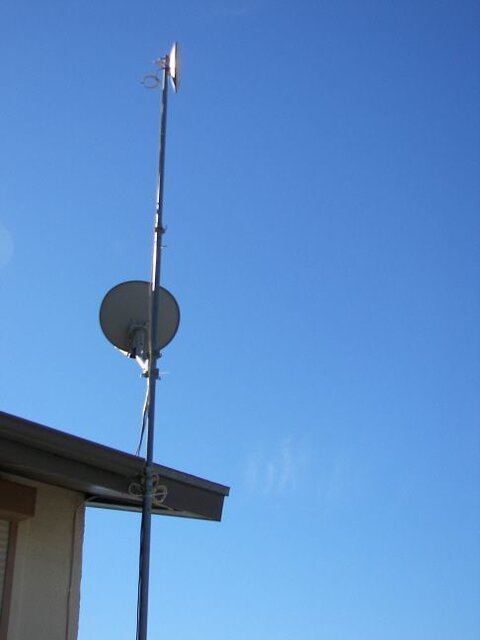

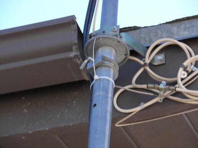

Can you post a picture of your current install?
Sure. The 25' telescoping mast was installed to give me LOS to the Sprint BB tower which is 30 miles due west from me. That's the white square at the top of the pole. The 3-LNB dish sits approx. 2' off the roof line. There are no LOS problems to the south whatsoever (other than the house itself).
Unaware that the new HD dish is so much larger and heavier than its predecessors (my bad), I figured it would sit about where its little brother had happily been (albeit a little closer to the roof line for more stability). Looking at the mast now and knowing the weight of the thing, I can see that the current mount is inadequate with only one 3" lag screw into a rafter tail and the other into blocking I added behind the fascia.
With the geometry of that corner in addition to the gutter, I also don't think the DishMount mounts would have enough room for the struts/braces/"monpoles" that they require. It's a 28-year old stucco-on-plywood, 2x6 frame home and I don't know if that would provide the anchoring needed for what appears to be a fairly massive support arm on those mounts, either. The winds here are intense as the house sits on a 300' ridge at the north side of the valley with 15-80 miles of open space from east southeast to north. The mast location is sheltered by the roof from the prevailing SE winds which is another reason I like it.
Sorry for the long-winded explanation, but this is getting to be a pain in my *** and I want to get it right. Many thanks again to all!

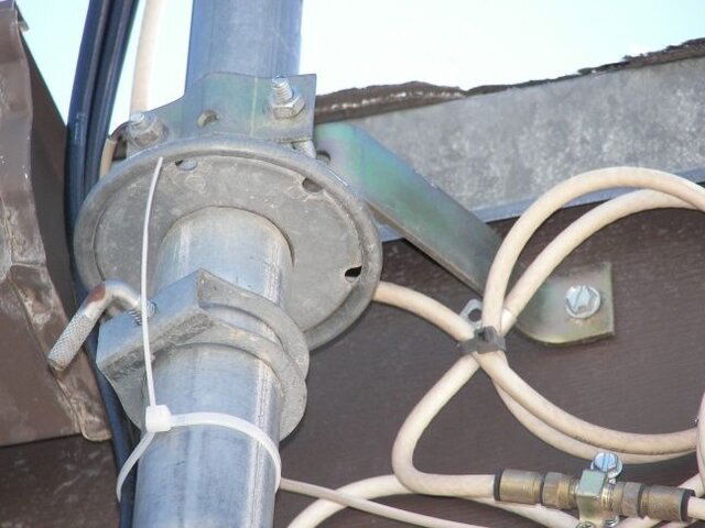

Yep, it's heavy gauge galvanized although it is a telescoping mast and, thus, tapers as it rises. This is a single story as well, although the house is built into a hillside and the basement extends approx. 5' above grade on the NW corner where the mast is mounted. According to the tech, the monopoles would have no place to mount. Who knows if that angry little man was telling me the truth. Knowing (now) the size and weight of this thing, maybe he was right.
As stated in my previous appends, the roof is being replaced and is not a candidate for mounting of any kind (including the monopoles). Yeah, I've agreed the mount needs to be changed/strengthened:
The blocking I added is a 2x4 lagged into the rafters on each end. Fairly sturdy, but needs more attachment points and a brace into the wall if I do attempt to mount it there.
