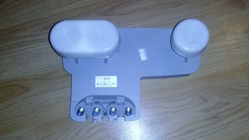

the LNB is a dp plus A71C01-WB1000188
I has 4 ports.
labled 1, 2, 3 and LNB IN
If I only have one 222k ird, then I just run the coax from port 1 into 222k right?
thanks
Yes, but if you are only using one wire you will need a dpp separator at the receiver as the 222k is a dual tuner receiver...
Not sure what bracket you think you need. more info will be needed.
Yes the triplexer will separate the signals, that is the correct bracket assuming you are using a 1000.2 Dish and not a 1000.4. The 1000.2 has 2 bolts securing the polar plate to the mast or pole. The 1000.4 has 3 bolts securing the plate to the mast plus a fine tuning rod,
I see two openings for bolts so I assume I have 1000.2

I was referring to the bolts that hold the whole dish assembly to the chosen mount not the screws to hold the lnb on to the arm. But as mentioned above you have a 1000.4 east lnb.
So this is your bracket:
Dish Network 1000.4 Integrated LNB Bracket Adapter / Yoke 157105
