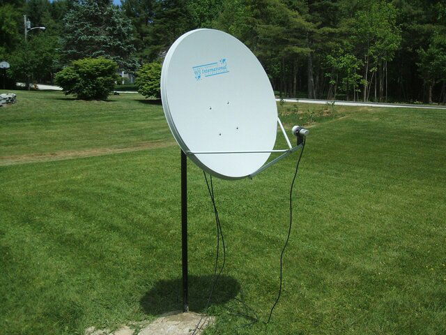

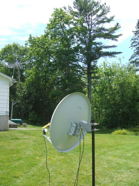

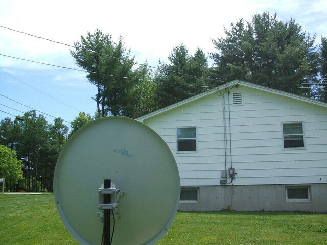

finally got a beautiful day to take pics of the install. you can prob see why i was skeptical of los because of the maine pine trees in the background. once i get used to this dish i will be adding the 4 footer to the yard.

Nice install! Good that you could stay low to the ground.

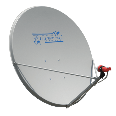

Outbackjack, nice pics of your set up! But there is one thing wrong with it, the lnbf bracket is in the wrong spot. Look at picture #2, it is on top of the arm and it should be on the arm so the lnbf is not on the sweet spot of the dish. That means you might have to reset the dish a little bit. It will help with signal quality. Other sat guys will tell you the same thing about the lnbf bracket.

I believe musher is correct, if you can twist the LNB from side to side with the mounting bolt lose, then the plastic bracket needs be re-mounted such that it straddles the steel support arm. This will mean re-adjusting the dish elevation up to compensate for moving the LNB down. You should see improvement in your signal, because your LNB feed horn will be at the focal point of the dish.

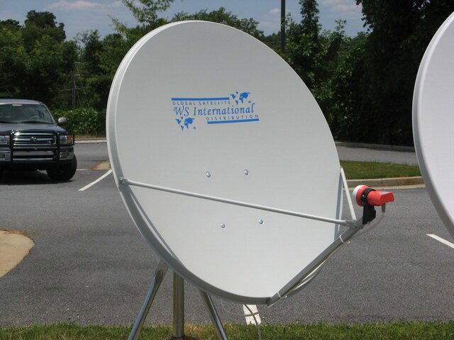

stanleyjohn, goto the wsi website an look up the dish WS9036 and scroll down till you see the pic's of the dish and click on the middle one and look at how the lnbf bracket is mounted to the arm. I'll get some pic's of my set up at first light tomorrow.

Good call Musher, looks like you're on the money. He's mounted the lnb bracket to the top side of the support, instead of running the support bar THRU it and bolting from the bottom.

Yes, good call... The LNBF holder fits onto the end of the support arm, not on top of it. This should make a tremendous difference in performance, in fact I'm somewhat surprised it received a signal at all mounted as it is.

Yea nice install. But I didn't catch that as well. I was thinking the neck. But when I went back and looked. Yea the plastif black lnb holder needs to go into the pipe. Also were is the motor? lol. But then again if you are going to get a c/ku band dish. You might not need one.
