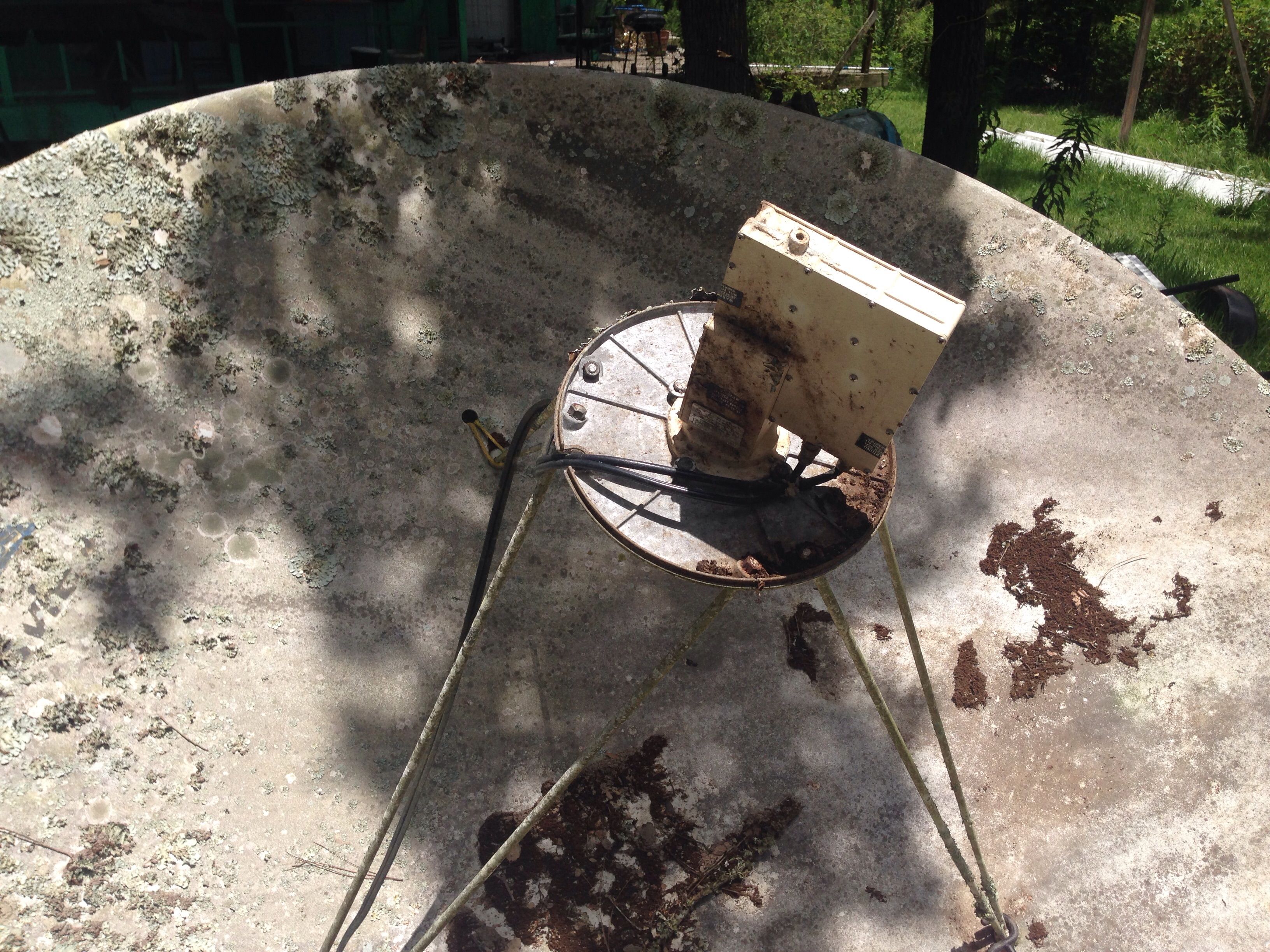

The dish being that old and not being used since, the feedhorn electronics may be too "old school" and require upgrade before using. Definitely a photo of the electronics and close-up of the labels. To control the polarity of the current feedhorn polarity servo motor you would need the Titanium ASC1 controller or an old legacy receiver. An easy and inexpensive option is to swap out the current feedhorn and electronics and replace with a C-band LNBF (keep the feedhorn if you someday decide to upgrade the electronics for better performance).

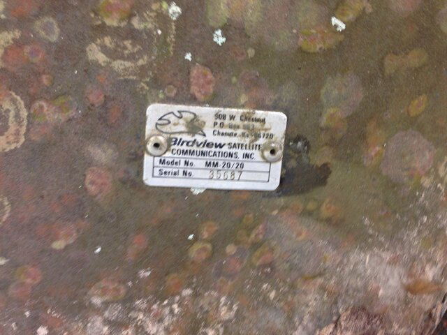

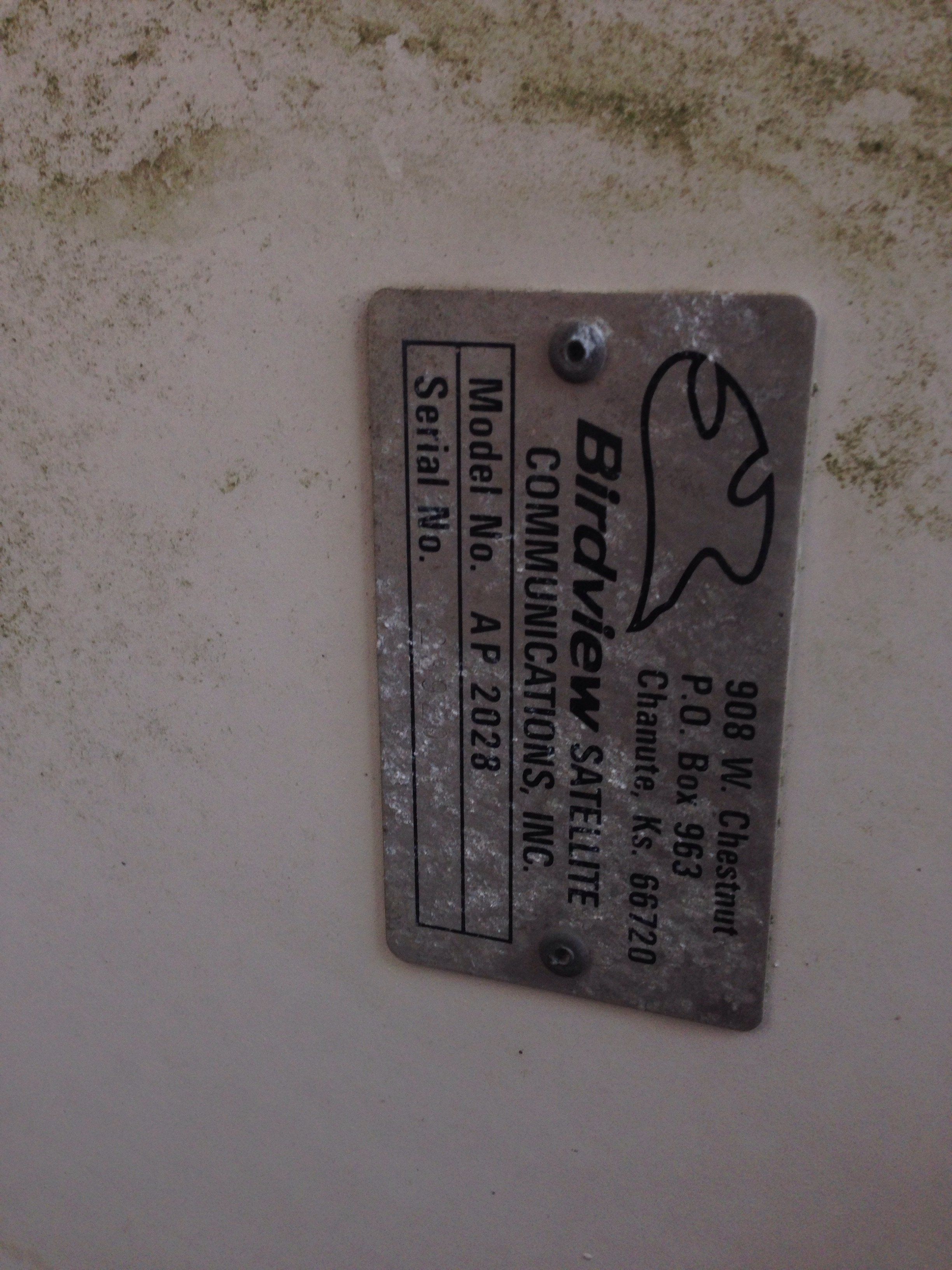

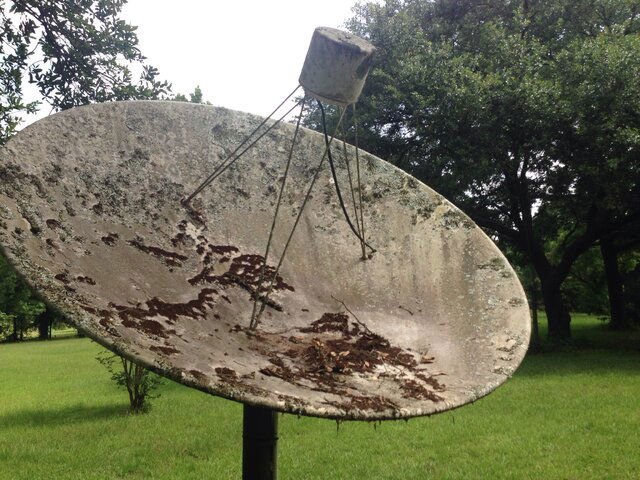

Yes it's birdview
Reactions: Titanium
Nice dish. Needs some TLC & a new home (provided)
A power wash and a fresh coat of paint will make it BEAUTIFUL! (Don't use high gloss paint)
Think it's best to swap out the electronics with a new LNBF. Use the existing scalar by opening up the center hole a bit. (Titanium PLL ?)
Depending on it's age, it may be a 10 turn pot for a sensor. If so a pulse conversion will be necessary to use a new mover. (GBox, VBox, Titanium ASC1) Unless - you use the receiver that came with it as a mover. (??)
OR can use a battery to move it and an ohmmeter to monitor it's position.
Some pictures of the gear box will 'tell'. Drop the cover off and on the right side of the 'screw".
Simplified alignment instructions (by me) at www.wisgeise.net/BUD Note: BV dishes have fixed declination, so ignore unless you want to really 'peak' it.
Reactions: N6BY and allen75960
Also I have the c/ku lnb that came with microhd. I can make a bracket to hold it in place if that will work
Model? anyho, should slip right into the existing scalar. May have to open the hole a bit. Measure the dish side protrusion of the existing , and mount it with the same measurement. Can fine tune later.
