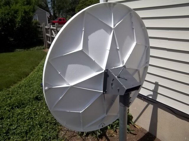

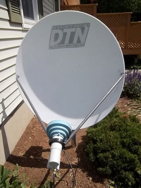

Okay okay okay, here is the masterpiece! :sorry Thank you for the interest.
Behr paint comes in quarts in white, exterior. I guess you can have them (Home Depot) mix up a color as you wish. I agree, painting a dish is a personal thing, might as well paint polka dots, stripes, murals, whatever suits your taste. I used paint pads for thin coats. One coat of KILZ, then about three very thin coats of latex exterior white satin. Back of dish I used a brush, what with all those nooks and crannies. Rustoleum gray was used for LNB arms.
Just had to keep the original logo on so taped it off.
Haven't got that dish elevation gizmo correct yet, trying to find a bolt with the same threads per inch as the original, which is a very fine thread. The old bolt was frozen solid; had to use propane torch, WD40, some banging and incantations to a higher power to finally loosen.
