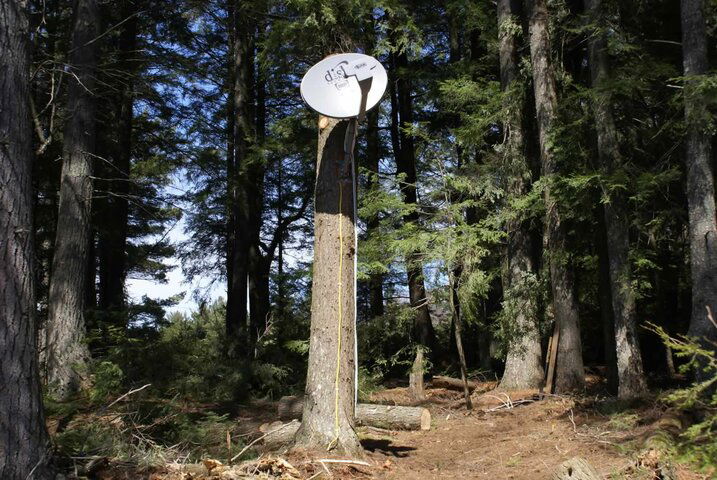

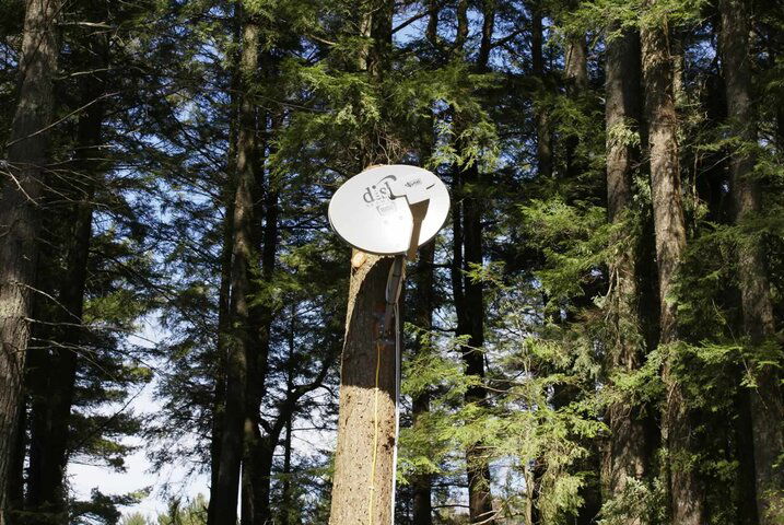

My setup-
dish network 1000.2 dp plus triple LNB

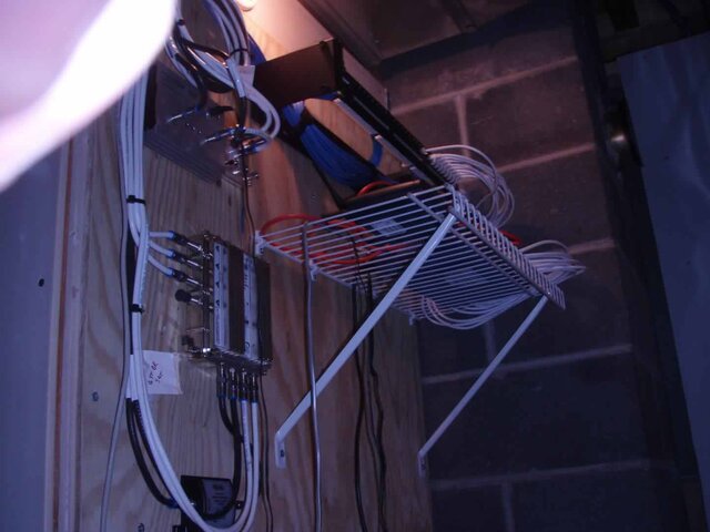

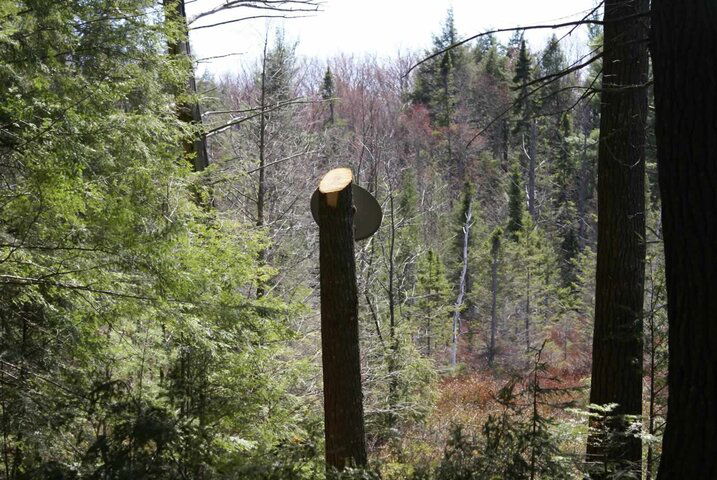

I have 3 coax cables between the lnb and a DP44 switch.
This dish is set up to 110, 119, and 129 satellites.
VIP 722
