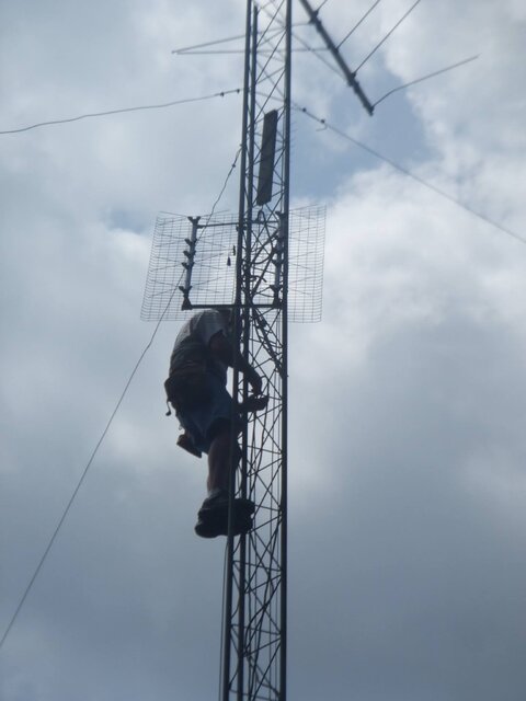

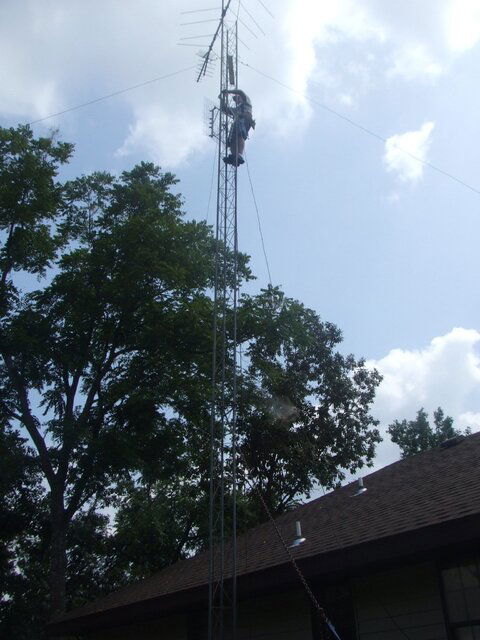

......since I installed a new OTA antenna, preamp and cabling at our house.
We live way out in the sticks, about 50 miles from the transmission towers and down in a hollow, so until we got our first FTA receiver this spring, we had never had good reception on all the major OTA networks, some (ABC & CBS) were really terrible.
BUD spent a lot of time pointing @ 99W soaking up the Carribean net mux, and my family was willing to overlook the time I spent with tv and receiver out in the yard.....in the dark.....mumbling exotic acronyms.....and occasionally doing my happy dance.
Short story long, I put up a Channel Master 4228 w/CM7777 preamp on our tower and ran new RG-6 to 4 rooms in our house. We have no tvs w/ATSC tuners (yet), and only one converter box, but we are now receiving all our locals (plus some new subchannels) between 92-100%, on the set with the dig box....and the other 3 tvs that are still being fed NTSC have excellent pics on ABC, CBS, FOX & PBS...and NBC is very watchable.
Conclusion: Great antenna, great preamp.....installer was a total dork. :hatsoff:

Let's just say I bear more than a passing resemblance to the "installer", beyond that, I'll plead the 5th Amendment. :D
You can see my old UHF-VHF antenna (as well as my little homemade "coat hanger" antenna experiment, it did great!) in the pic above the 4228, not only was it damaged from the ice storm we had in 2007, one of the leads from the old 300 ohm flat cable had been pulled loose, and I couldn't have reached it without bringing my tower to the ground.
New cable works wonders, I have already changed out the old stuff for a couple of friends, made quite a difference.
That's fantastic the signal you are picking with just rabbit ears, you'll be pegging your meter with any decent outdoor antenna. You might consider the CM4228, it's excellent for UHF and does well on the hi-VHF channels also.

I had my coat hanger antenna hooked up for about 3 weeks, until I got the CM4228, and was getting signals in the 70s on everything, great picture with no breakup at all.
Nobody that saw it believed I was actually using it, they insisted that the big old UHF-VHF antenna above it had to be the one that was hooked up. :D

How high is the tower?
how is the reception with the CM4228?
In a word, outstanding! I posted my SQ% numbers above, and those are all the channels that are available for the direction I have the 4228 pointed.
I could swing it approximately 180 degrees and get the Joplin, MO stations but they don't have as many stations, and they would just be repeats of what I already have.
Signal levels should be even better this winter, the 4228 is looking directly into a fully-leaved walnut tree that's about 30' away, that has to be hurting the signal somewhat. My Stihl chainsaw will be having a chat with that tree sometime in January methinks.
very nice setup. Now the folks can watch something on nets while you watch a game in HD ;)
I can't WAIT to get an HDTV, I've seen the OTA HD at my Mom's house, had no idea how good HD really looked, it's awesome. Hoping some FTA HD is in my VERY near future.
That tower is about 50' to the top, I salvaged a 150 footer that went down in a tornado and got enough good pieces to build what I have. :cool:

Same here, last to get leaves, first to fall. We have literally hundreds of black walnut trees on our farm, the one that's blocking the OTA antenna is also hanging over the house.
I could even live with that, but......................................it's blocking my BUD's LOS east of 87W.
