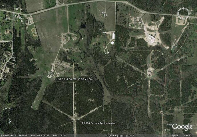

N 32° 35' 6.00" W 96° 58' 41.00" - Tower array for DFW is at this general location.

My zip is 76051 and the antenna is (approximately) pointed south. As I am northwest of Dallas and northeast of Fort Worth, I thought that should do the trick.

You are 25 - 28 miles away and your antenna should be aimed/pointed at a 157.5° heading based on your zip code. The range of your towers is 156° - 159° which is GREAT for you!
Not knowing the antenna make & model hurts in knowing what its actual capabilities are, but get the aiming correct first and see what happens. Being IN the attic can cause a 35% upto a 50% reduction in signal, so a larger antenna is needed; outside is a MUCH better option and MUCH cheaper.
