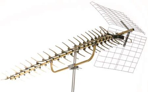

I'm bmj11 heh y'all . Sorry for typos I'm blind in one eye and not great in the other one. Orby is coming 8-14-2020 to install. I have a 85' run to get to west side of yard to get signal. I have a 4x4x8' treated post and concrete. I also have two sections of 2" top rail and a ultimate TV antenna.I have 250' quad shield rg6 cable and 2" PVC conduit. I want to place the post in concrete and have the antenna mast secured alongside the post. My signal is horrible only one station channel 12. L need some quick advice on whether this doable. I would like to do this before tech gets here Friday .thanks for your help. Maybe Tita nium could check in. I loved post on his install.t hanks bmj11

Thanks T. for answering post I was only thinking to use post for extra stability. I will use top rail for orby and use a 6" chain link fence post for antenna.A ultimate TV antenna is a old design bowtie that some people might call the cost hanger antenna. Guy named Danny Hodges builds and sells them on eBay has great YouTube channel.Im presently using a large 144" Channel Master antenna and it picks up good but large oak trees are hard to get signal when fully leafed out. My neighbor is grouchy and I don't think I would have enough space to put west of my house. The ultimate antenna is only 3'x2' and I could take my RCA preamp and run cable separate from orby. There room for this antenna,i can't get on antennapoint.com but my coordinate s iElevation 39.80. Azimuth 224.96031 skew 33.90 I would appreciate it you could look and see if I have any other options. I'm sorry for the long response but this took me twenty minutes to type on a 2 1/2"x 6" phone. Thanks bmj11"

The one channel you now get it Virtual channel 12 - actually a high VHF channel 9. The "Ultimate" antenna is a UHF - I doubt that it will receive the PBS 12. Channel 12 is listed as FAIR on Rabbit Ears site:

Thanks Bob for the info. I didn't know about channel 12 being high vhf. Reception on 12 is easy. I could pick it up with rabbit ears. The ultimate antenna is real, I.placed it on antenna pole about 6' and pointed North picked up channel 7 good. Your right the antenna is basically a UHF antenna but will pick up VHF as configured, but he also has a VHF bar for a option
. ,I plan on making this bar for mine. VHF is a ***** but I've lived with it all my life. Thanks for the info.bmj11

Meh. I've always had the best luck with YAGI's with a preamp:

Tech guy thanks for the response. My present antenna is a 144" Channel Master it is a very good antenna.I can pick up all the channels that TVFool.Com says are available. My problem is seasonal. Mainly large oak tree in betweene Mr and Memphis Tennessee . I am adding a orby sat and have to get on the other side of these trees to see the orby satellite. I figured as long as I was behind these trees and had a good view to Memphis I should put a antenna back here while the orby tech was here, With the VHF add on I think I have a good shot with the Ultimate TV antenna. Either way the leaves will eventually fall off and the channelmaster will resume working. Thanks for the links and your help
