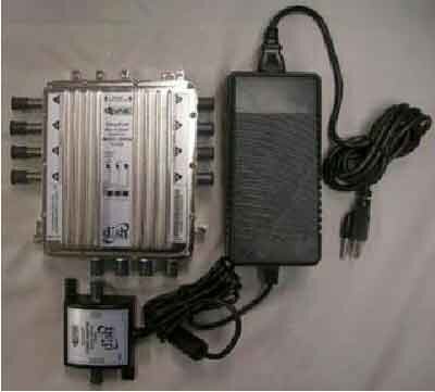

so in the pic below the power inserter is attached to the little black box to the right of it? I've never seen a 44 switch in person so I am going by the pictures
Right, and the top of that "black box" (which is actually an adapter) has a jack the same as you'd find on the back of your PC, and you can unplug that 3-prong cord from it.
