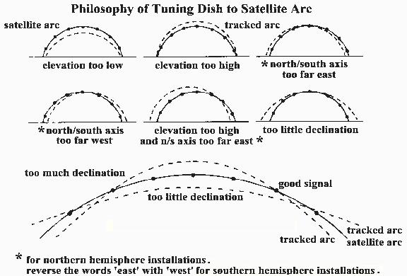

Okay, new problem. Any tweaking advice? Top of Arc for me is Galaxy 28. I am having problems receiving East of SES2 and West of SES1. I did successfully once get AMC6, but at the moment i have lost it. I have never gotten anything west of SES1. I feel like i am spot on, as if i nudge the dish up/down, i get less signal, and left/right less signal. I did this on G28. I'm not sure where to go now. It's amazing how much time you can burn on this.

I know there is a thread somewhere on here that describes this better, but for now, check out the bottom of this page: http://www.repentnow.com/FTAMOTORINSTALL.htm or at http://www.geo-orbit.org/sizepgs/tuningp4.html
You are slightly off the arc (this is where motorized installations are most annoying). If your latitude is set correctly and everything is 100% plumb: the motor mount and the pole (double check this), then
1. The motor assembly is too far east or west (azimuth)
2. The up/down tilt of the dish where it attaches to the motor shaft is off (declination)
3. Both.
I'll try to attach an image from the second site and you'll see how you'll have to experiment with the dish then imagine in your mind what is happening to see what the alignment issue is. I imagine it is the dish's tilt that needs to be moved ever so slightly up or down (declination). The best way to deal with this is to bring your meter or TV+receiver out to the dish. Try moving the dish to say, 113W and manually enter the strong 12080 H 25635 transponder (BVN, and several other Chinese stations are ITC). Push the dish slightly (and slowly) at the top or bottom with one hand, up or down. When you see the station, that'll give you an indication of which direction the dish needs to be adjusted (up or down).

I have come to the conclusion my declination is off a bit based off the chart. I need some suggestions. How the heck do you make minor adjustments to declination. You loosen that screw, and ill tell you there no making minor adjustments. It wants to jump up/down. It was 90 degrees outside. I was not about to work outside under the sun today. I am salivating in thought over actually being able to get this in sync.
Is the post PERFECTLY plumb? Is the feedhorn perfectly centered and aimed at the center of the reflector? If not, your angles and measurements won't match calculations that we provide.
If the angles aren't set at the top of the arc, then the dish won't track the arc to the horizon.
