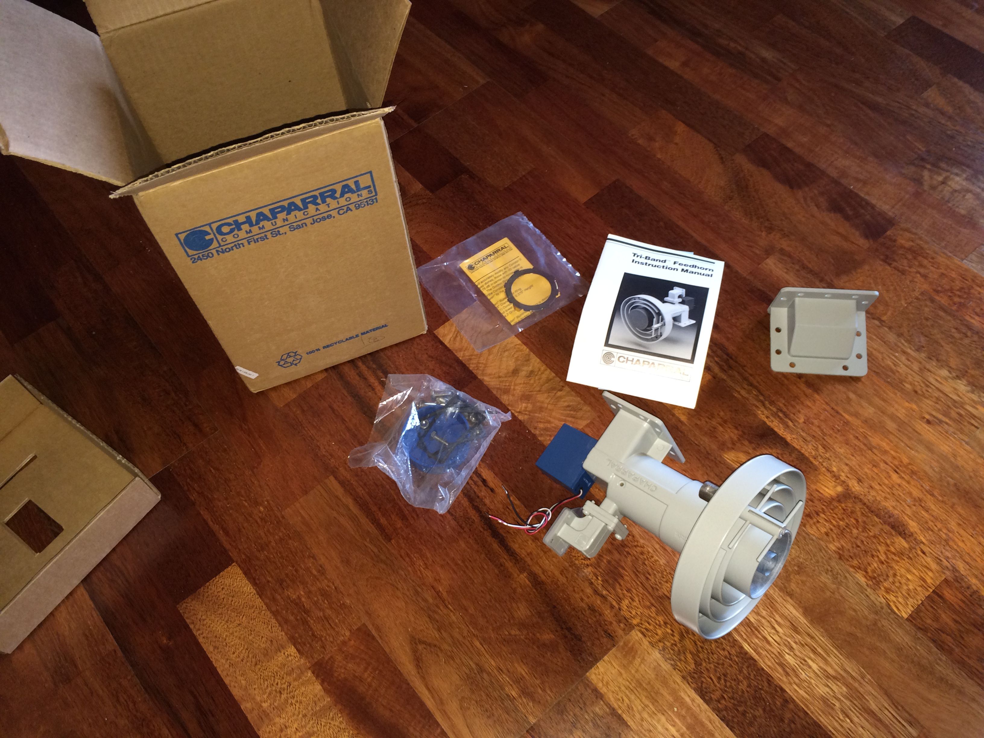

Just got one of these NOS Corotors as a spare part for my dish. Here are some pictures to show the difference of the KU feed to current production Corotors. The scalar ring on this model has an additional S-Band Antenna btw.

Benjamin, are these from the supplier on Cyprus? I've been thinking about getting one just to experiment on S-Band, Arabsat used to use it but not sure what is left on the band. Have you compared the performance of this model against the new version, on both C and Ku?

I did not compare the 2 models myself, but I read about the test and the differences in US and German satellite TV forums some time ago. The main difference is the KU probe, with the old design resembling more of the ADL feed´s original KU probe design. The old desgn was said to show a slightly better KU reception, if I remember correctly, 0.5 or 0.6 dB. This does not sound like much but can be a whole world in the digital world where lock or no lock is a thin line.
