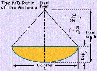

Calculate focal distance by measuring the diameter of the dish.
Measure the depth of the dish (distance from center to plane of the dish)
diameter squared divided by 16Xdepth
if I am correct it comes out to 27.14 Hopefully ?????

Why Amc-9?
Uh OH looks like I am off on my focal point I used 39 inches to go by.if I understand your diagram I should have used the 36 which would bring it to 24 something

I'm kind of confused on the focal point stuff.which I have my Dish size posted wrong should be a 36 inch wide by 39 inch Dish not the other way around.So if I calculate correctly should be 36 inches squared which should make it 1296 now for depth I was told to lay a straight edge across the dish and measure from center of dish to edge of straight edge and if I am correct should be 3.5 so mutliply that by 16 which gives me 56 divide the 1296 by 56 =23.14 so is this what the length of the arms should be?I think this is whats giving me problems.most of the other stuff I get a handle on
The above formula is only for Prime focus dish, if your dish is off-set I would use the signal quality meter to get the exact focal distance!

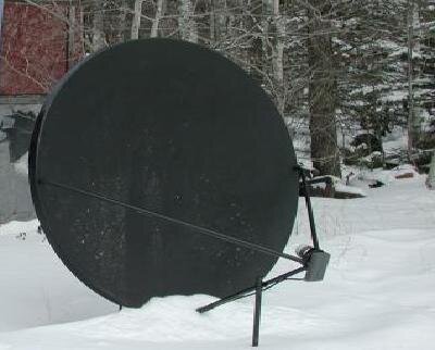

well I don't think its an offset it looks more like one of the Channel masters 1.2 meters
have no pictures.all I know it is an old Primestar.I have been searching the net trying to find a good picture of it to help me.all I know is if I stand and look at it from the porch it looks exactly round even tho the top and bottom are 1.5 inches longer than the sides.the channel Master is about as close as I can come I guess.since there is a hole on each side of the Dish i guess that would be the support arms for the lNB arm coming up from the bottom.I wish I could be more help
The 1.2 CM is offset, as is your Primestar. These dishes use three "poles" for the LNB mount, but it is in an offset pattern.
The "poles" for these dishes are available separately, but I can't find the link to the vendor. Maybe someone will chime in with that info...
ok here is what I am talking about
hopefully someone has a link to a vendor that sells them because I am not sure on how to build the offset for this Dish
