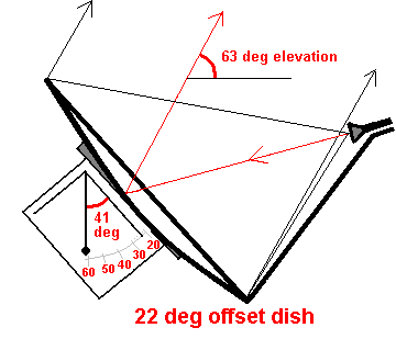

Offset dish do look straight ahead, they are pointing 22º lower than they seem to be.
Code:

So since it's an offset dish (which I don't really know what that means) if the elevation is supposed to be 30.4 I set is at 22 deg lower at 8.4??? It doesn't seem possible, the dish hits the post at 30. Thanks for any help on this...
Ok sorry, I guess I was just backwards. So for 30.4 elevation it would actually be set at 52.4?
Its a standard LNBF so the L.O. should be set to 10750
Here is the whole explanation on offset dish.......
http://www.satsig.net/22-deg-offset-dish.htm
The dish elevation should be set as posted above, if the angle to the satellite you are looking for is 30º then set the dish to 30º The offset is built into the dish, thats why it "seems" to be pointing straight ahead!

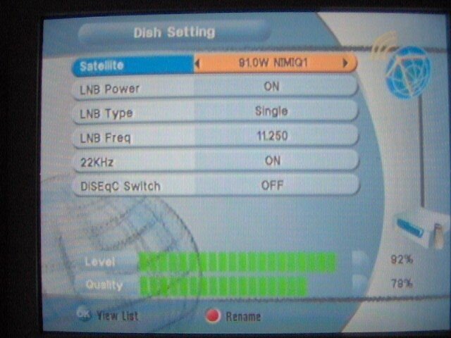

Here is what I mean
when you set up your dish setup, select the satellite and where I have 11250 change to 10750 (the satellite I have there is a DBS satellite)
So it would be satellite
LNB power ON
LNB Type-Single
LNB Freq 10750
22K & Diseqc make sure they are off
