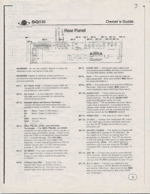

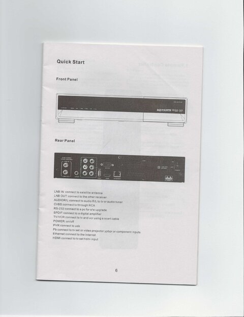

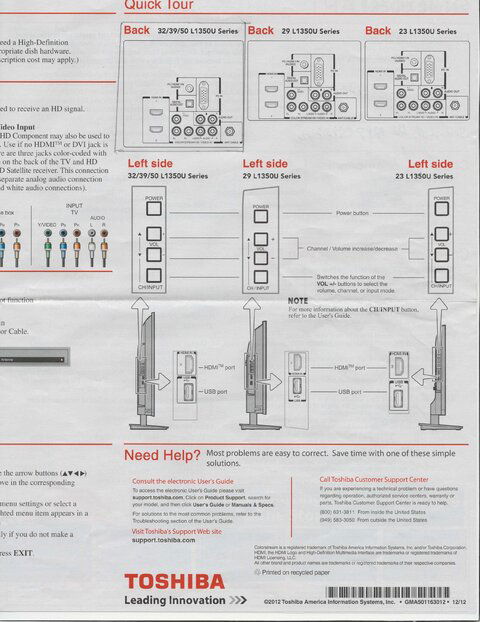

I have attached a picture of the back of the Openbox, UnidenSQ530
and the Toshiba 39" tv.
To get the dish to move I attached a wire from the Uniden at BP12 to
the TV at ant/cable.
To get the click count on the screen I attached a wire from the Openbox
at "y" to the Tv at "Y/video". This does not work and I get a screen so
full of snow that I can not read it.
Now you will say you are not getting any signal from the dish. But that
is wrong because when I 1st turned on with the new TV, the dish was
setting at 58 on Araing and the signal was clear. It's when I started
moving the dish that I lost everything.

Isn't the televisions "F" input (ANT) used for cable or local OTA antenna?
If answer is NO, skip to paragraph below.
Does the new TV have a yellow video input jack?
If so, wire the yellow video out of the Uniden( BP 11) to it.
Watch the uniden counter on Video, satellite on HDMI. Cable/OTA via tuner on coax input.

There is no "F" input as far as I can see only a screw on connection
called " ant/cable" on the tv.
The colors on the push in type jacks on the TV are green, red, white
and blue. No Yellow. The BP-11 out of the Uniden is a push on type
connector. The connection I have used so far on the Uniden are both
screw on connectors that seem to move the dish ok.
The connection from the Openbox to the TV must be the culprit.
I'm getting very heavy snow no matter where I connect the wire
coming from the Openbox. Maybe where I am connecting the wire
on the Openbox is the culprit. It is the located where the 6 slots
with a line around them at the top right called "Y". I thought this
was where I had it before but might be mistaken.

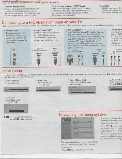

Most Toshibas use the input as dual purpose and you have to select Composite or Component input mode in the TV menu.
In Composite mode Green is Composite Video or Y.

On the back of the TV you should have Green, Red, Blue and Red, White as a single Input. The green, red & blue are component video input and the Red & White is audio input. You're used to seeing Yellow, Red & White - where Yellow is Composite Video and Red & White are audio.
