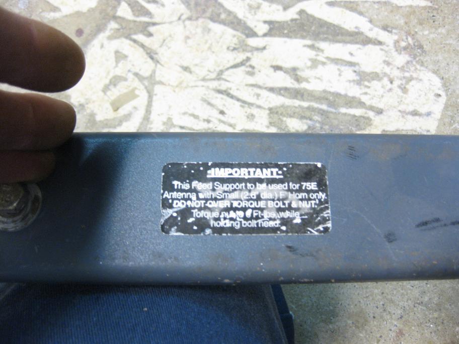

OK, so, im sure many of you can appreciate how busy things can get and how it cuts into your hobby time, well that sure has happened. Add to the fact that the one day i purposely sat down to get a back log of computer work done my internet was down. After a call in to an automated system i got a range 3 days it would take to get things fixed, how annoying.
As you can see, this is some pretty old looking stuff. and i totally forgot to get pics of the receivers...
OH Yes.... That is a dish you can not use. You must immediately package it up and send it to me, ;)freight prepaid..!!!! In other words,
That is one of the best KU setups you can find!!! :D
Now
what was the question ..If you check out my signature, you will see that I do use that dish set up. As far as the receivers go, I know very little about any of them. but others may be able to tell you more.
From the sticker, that's what we call a 75e (for elliptical) dish.
You might check the back end of the LNB, where the cables attach to it, to see if it has an H and a V stamped into the soup-can bottom, one by each connector.
If so, it's a pretty old one, but should still work fine.
Just that it may put out H on one connector and V on the other.
If so, we can help you with that, too. :)
View attachment 65708View attachment 65707View attachment 65709View attachment 65710
