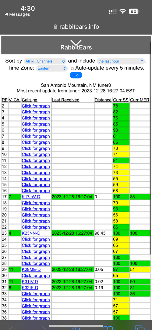

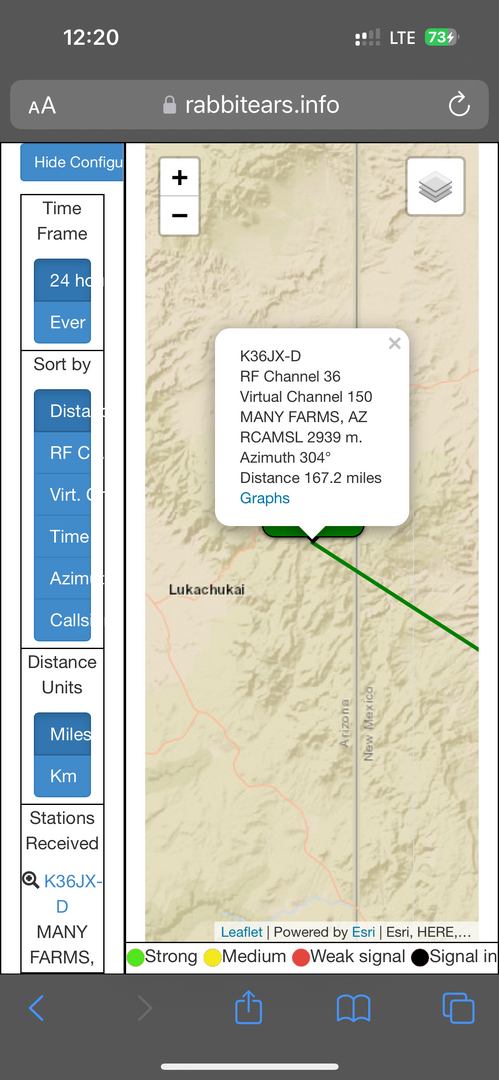

I see KOAT in Albuquerque has a tuner at their studio location. It appears to be tuning a station in Arizona, 167 miles away. Can that be accurate? NM doesn't get much, if any, tropo activity.
It looks like it was just a bad automatch based on the PSIP label and RF number. K36JX-D is a translator for KOAT, and KASY's NextGen RF 36 signal also has a KOAT

Is it possible that KOAT has a tuner on Sandia Crest capable of tuning (and keeping tabs on) its translator?
K36JX-D is not licensed for NextGen operations, so if there were a real report from it, it would have KOAT's lineup of 7.x channels and the ATSC 1.0 simulcast of 50.5 Antenna, not the 1xx.x lineup for KASY's NextGen lighthouse.
The only reports for K36JX-D have been mismatches from tuners 160 miles+ away in the Albuquerque area.
Trip can clarify, but I don't think the live bandscan has the ability to detect the BSID from ATSC 3.0 signals yet, so it's basically a guessing game based on RF and PSIP label as there is no TSID like there is for ATSC 1.0.
