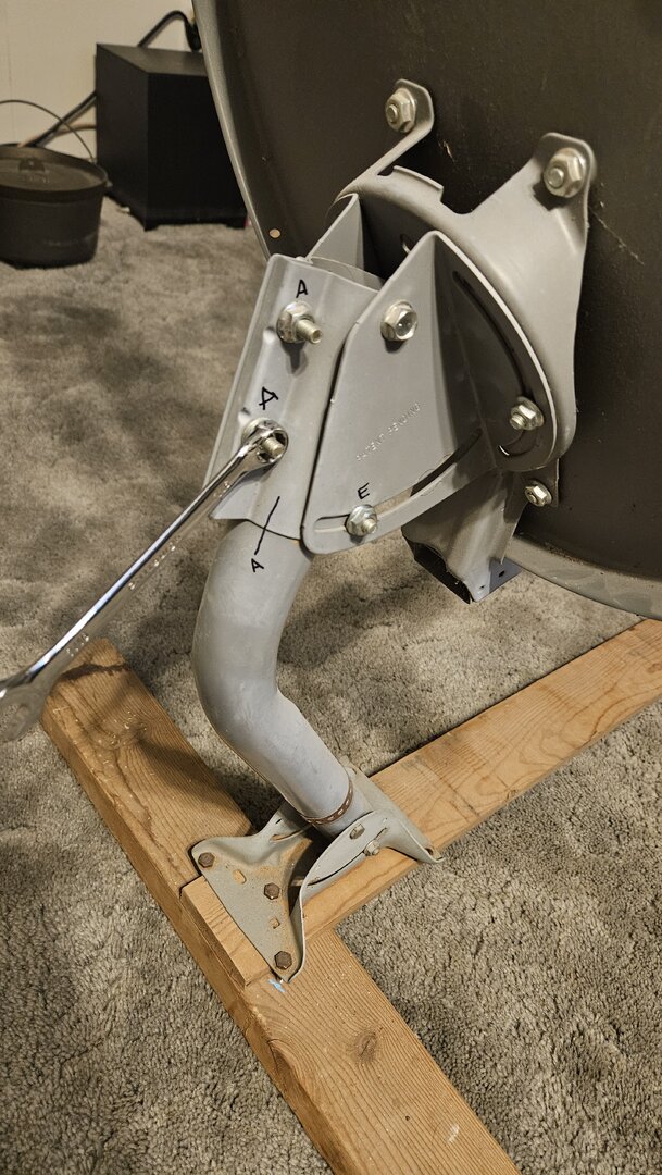

As long as you reinstall the base and pole such that the top portion of the pole is true vertical, you only have to search for the satellites by adjusting the azimuth (East/West orientation), don't mess with skew or elevation.
Make a mark on the pole and the clamp with a marker for azimuth as it sits before loosening anything and you should be very close to the correct settings and only have to do a little tweaking to get the highest signal.
Make very tiny adjustments to the dish horizonal direction to tweak it.
Attached is a picture of an old Dish 500. see the line on the pole and the clamp that line up this must be put back at the same place when reattaching.
The two bolts on the clamp labeled with "A" are the azimuth bolts.
There is an elevation bolt on each side of the backplate (labeled E here) the right side bolt is visable.
Again ONLY loosen the two bolts labeled "A", that will enable you to lift the whole dish off the "J: pole for easier removal.
